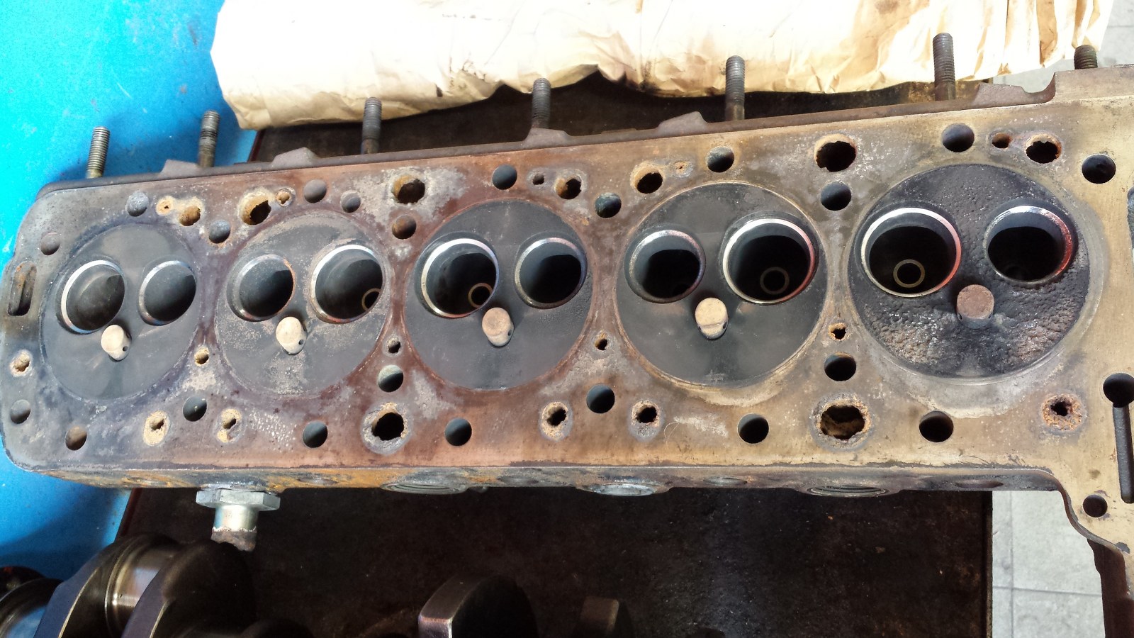

Hi guys,
I've searched but still confused, I need a new head for my NA OM617 W115 and I can't find alot of this used engines, but the turbo engine is easy to find.
So my idea was to get some turbo engine and add some turbo parts to my NA engine, like engine head, IP, and others that could fit.
I found till now that the difference between an NA OM617 block and a turbo block are only the oil squirters?
Can I make an mix lol of the two engines keeping the original block, but get some power increase?
Ideally would be to maintain the original engine block, because of the engine number is associated to my chassis, and adds value to the classic car.
Any suggestions?
Thanks

If the turbo version is easier for you to find, why not just swap in an entire good running turbo motor and repair the original NA engine when you eventually find a cyl head for it?
Or could you just replace the original head with one from a turbo? Anyone know if the cyl heads are the same spec between NA and turbo? If not, it may be possible to machine a turbo head to use on your block?
Attacking the work involved on the bottom end is a big undertaking. After all that work is complete, wouldn't your modifications disqualify it from being "original?" Yes, numbers would match, but the engine block is no longer in original configuration. Just something to think about in terms of its value.
If I were in your situation, I would look into using a turbo cylinder head on the original motor. Most likely that is the least expensive and quickest option.
