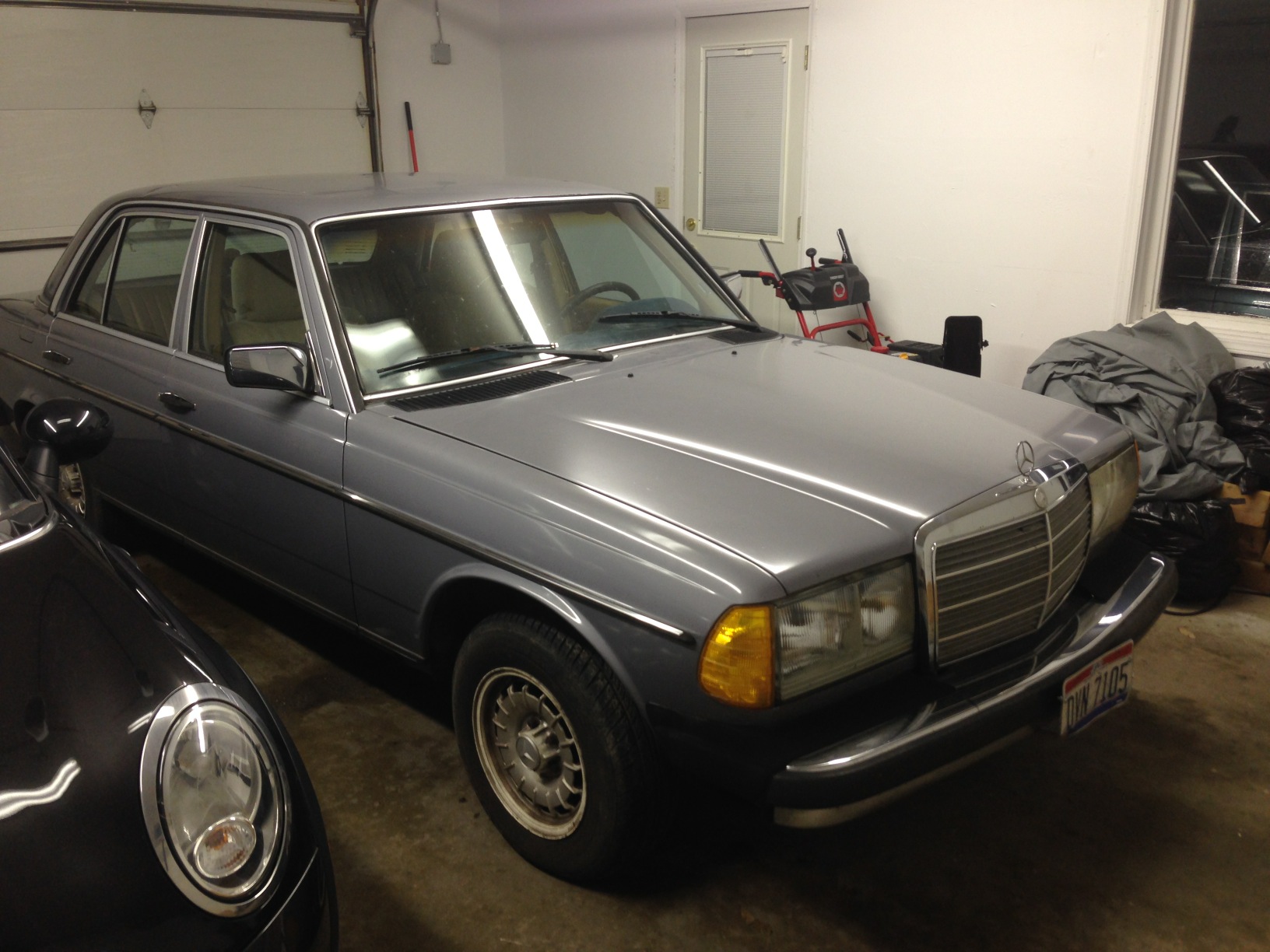

My '85 is at the end of its life, my hack bodywork is coming apart and it looks awful. Engine is still great but the tranny is shot. Not worth fixing.
Anyway, I still love these cars, been looking for a good one and found one down in Columbus rust free and already converted to a 4-speed. Went and bought it, then drove it home. What a white knuckle ride it ended up being. Fuel issue somewhere, it wouldn't idle. Alternator died on me halfway through, I made the last 50 miles of the trip in the dark with no headlights, taillights, ect. Miracle that I didn't get pulled over.
Couple of dents to work out, a few very tiny rust bubbles. Floors are completely solid, no rust on the underside at all. Plans are to get it running properly, get it looking good, then to make it go fast. I'm going to swap most of the interior from the '85, and my rims + shocks.

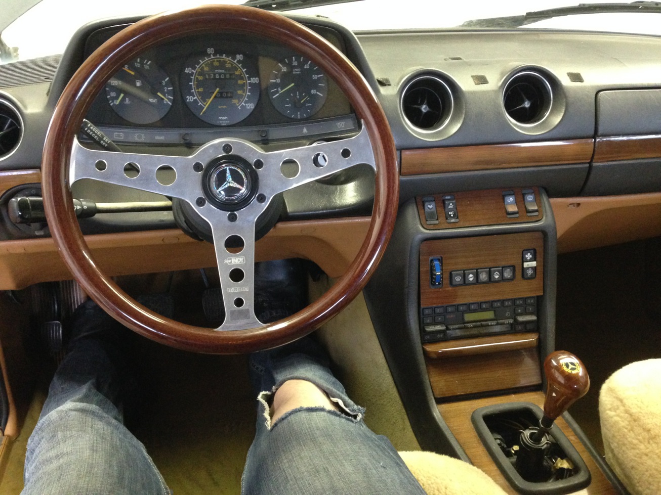

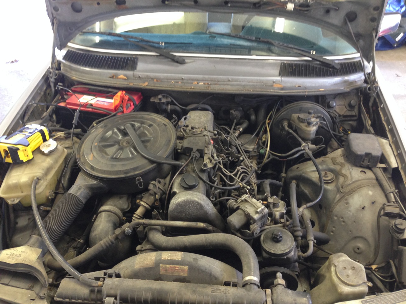

Thanks guys.

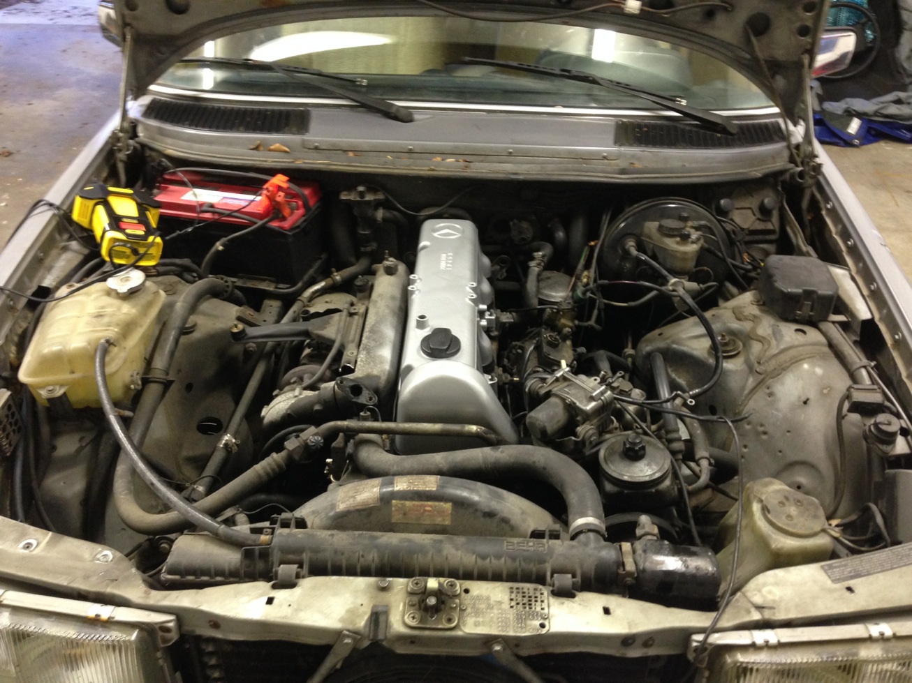

I haven't worked on a car in a year, i forgot how rewarding it feels, especially when it's not your daily driver and you're under the gun to get it finished so you have a car to drive Big Grin

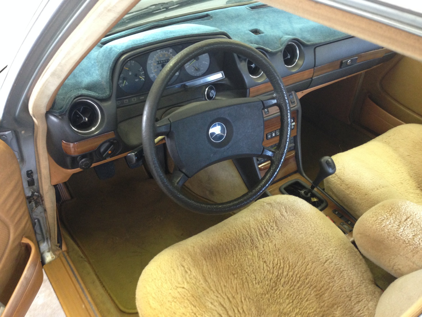

Started today with a blank canvas
And here's how I left it
I even took a few extra minutes and put my momo steering wheel and wood shift knob in
Valve adjustment, removed the glow plugs and injectors. Cleaned up the linkages and vacuum system a bit, painted the valve cover. Removed EGR, ALDA, and air cleaner. At this point I'm just waiting on parts to come in. The linkage bushing is shot, motor mounts are collapsed into the frame. I pulled my injectors out of the '85 and cleaned them up, they should still be good, definitely better than what I took out, the originals are gunked.
Fuel level sender is bad, I tried to get the one out of the 85 to no avail. Channel locks wouldn't work and I don't have a socket big enough. I want to pull the original to see what it looks like to determine how the fuel tank looks (sludge or no).
Pulled the instrument cluster to fix the odometer.

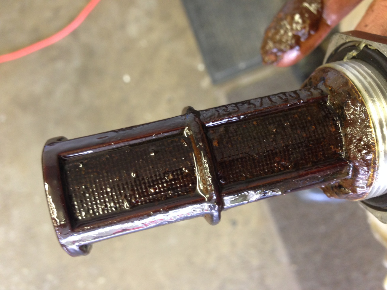

New alternator installed, along with new drive belts, injectors and glow plugs. In trying to start it I may have discovered another problem. I think the tank strainer/fuel tank is clogged up, trying to prime the system I can't draw any fuel from the tank with the primer pump.
It's been smooth sailing and finally I hit a problem

Can you blow into the hose? Also, make sure the supply/return hoses didn't get reversed on accident, had that problem in my w116 and it didn't really want to run like that lol

(05-07-2014, 02:35 PM)sassparilla_kid Can you blow into the hose? Also, make sure the supply/return hoses didn't get reversed on accident, had that problem in my w116 and it didn't really want to run like that lol
yes check that. If the car has been sitting for a while it will develop gunk like it did on mine. Also the fact that he ran on biodiesel is also something to check out.
When I ran on WVO overtime my second tank that housed the oil would form a thick skin, almost like chicken skin and it would clog up hoses and filters when it started to break apart when driving around and hitting bumps.
stuff is nasty. Get some dieselKleen and use it on every fill up for a while. You could also drop the tank, have it cleaned and replace all the hoses. Might be worthwhile.

When I cleaned the tank on my w116 I just pulled it out, hosed it out really good, let it sit in the sun for a while to help it dry, sloshed a little of the turpentine like substance around it that came out, let it sit in the sun some more, put back in car and added fuel and some fuel stabilizer. Bam ran great afterwards, still fires up with a fresh battery after months of sitting

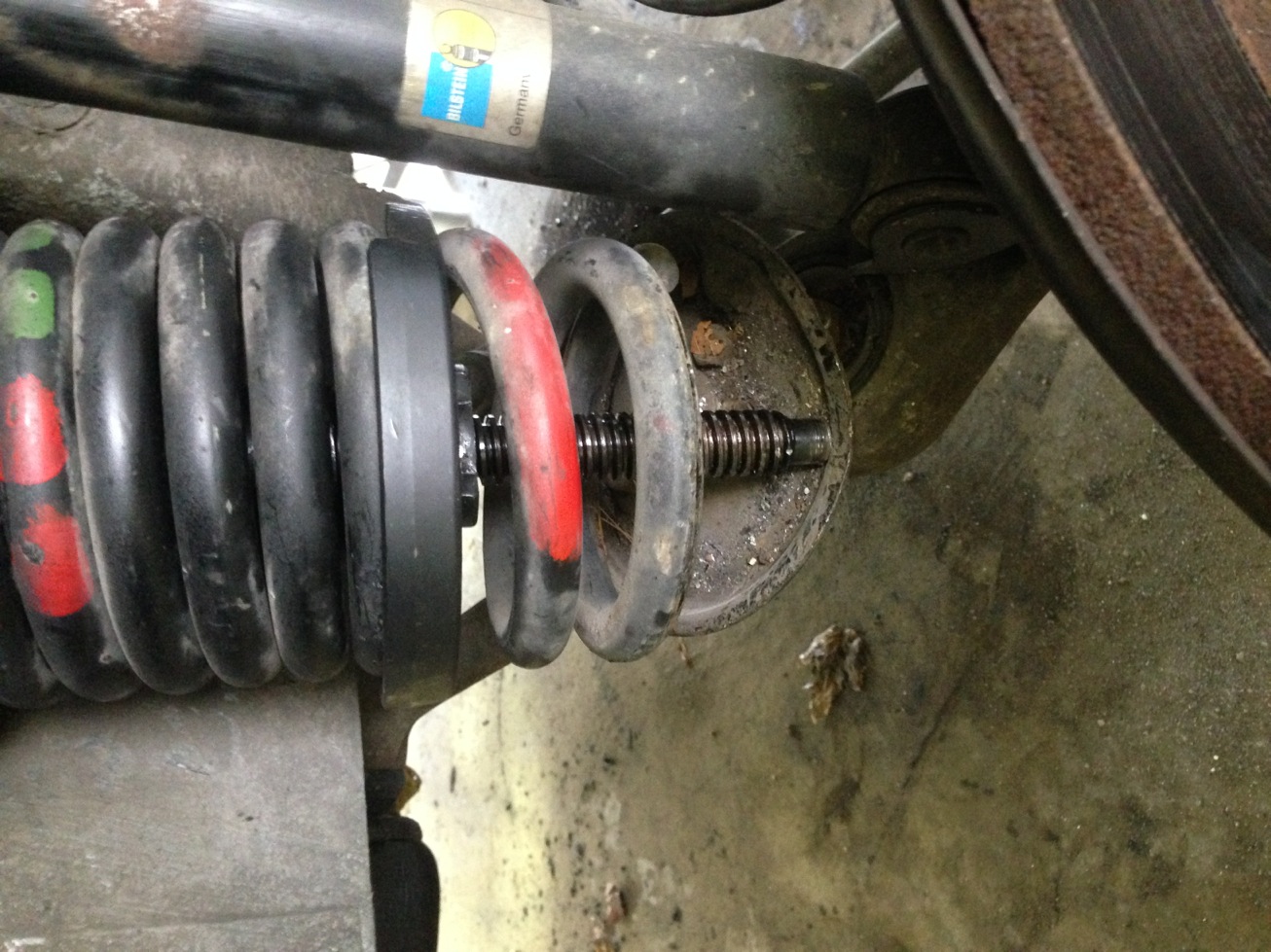

05-08-2014, 04:42 PM #18

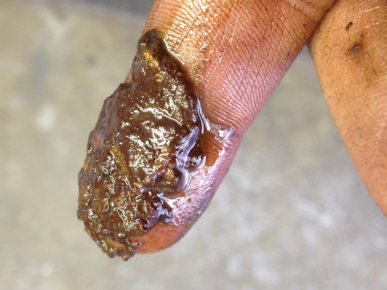

I dropped the tank. Sure enough there's an inch thick layer of nasty stuff in the bottom.
I scraped out what i could, I've got it soaking in mineral spirits. The fuel level sender literally fell apart when I took it out. Going to flush the lines, bought all new rubber lines and obviously all new filters and tank screen.
I need help with this spring compressor. After i filed the FUCKING spring perch holes to get the thing in there, now it jams against the bottom perch and I can't get the spring out. What am I doing wrong?

I'd add some algae killer additive the first time or two you fill it up to make sure nothing grows in that nice clean tank!

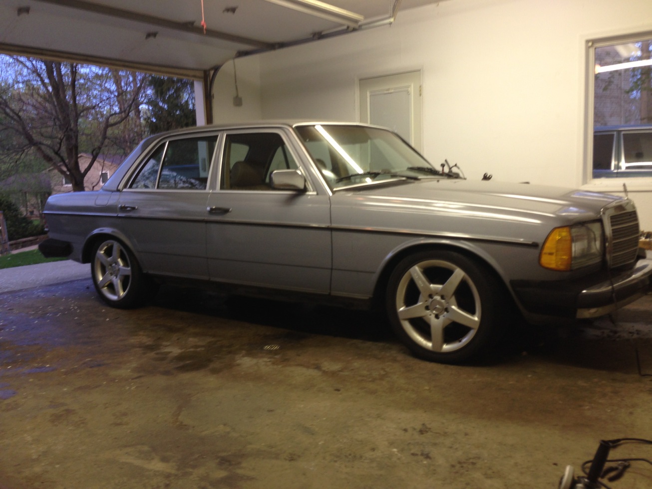

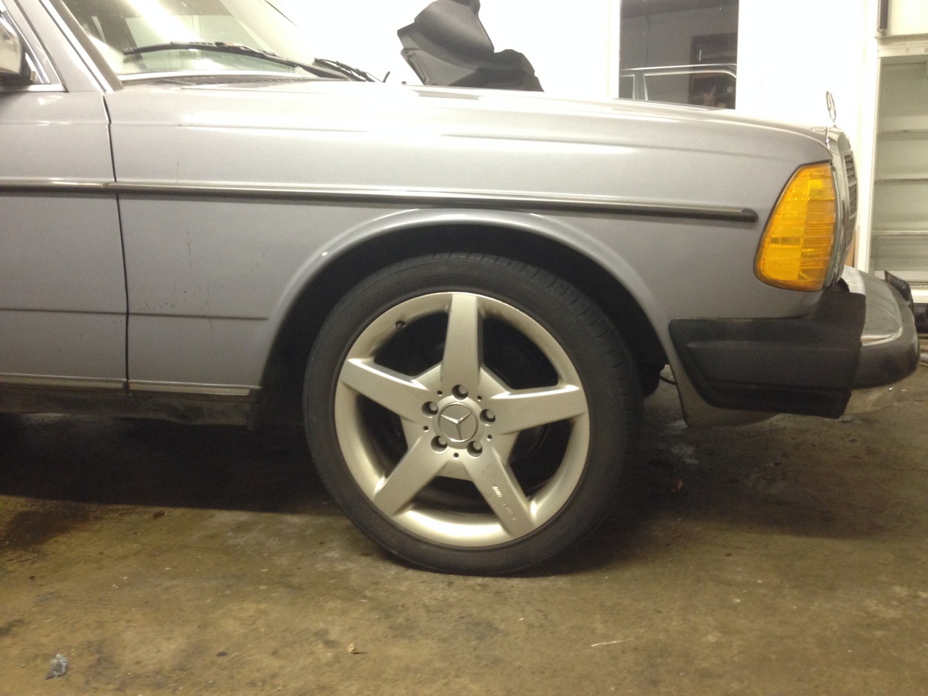

For sure. It's not a terrible job to pull the tank but it isn't something I want to do again.
Ok so I got the springs out. the one that was wedged I pried it out with a shovel :roll eyes:
I cut 2 coils. Wondering if I should have cut another coil, or maybe another 1/2. The car does sit remarkably lower, and I still have about 5 inches from the oil pan to the ground.
Thoughts?
Thoughts?
I think w123 look so much better lower to the ground, in a tasteful way of course. Nothing to obnoxious like the ricer kids pull off.
I think your car is looking good!

VERY productive day. I abandoned the tank with all the sludge in it, realized I had a perfectly clean tank sitting in the 85. Yanked it out and put it in the 84. The exciting way - with it still 1/3 full of fuel. New tank screen and fuel lines. I was literally covered in diesel.
After getting that together I was still unable to draw any fuel from the tank. The only thing left that hadn't been cleaned out or replaced was the lift pump. Swapped for the 85's and bingo we have fuel. Lift pump probably was the source of the original problem but Im still glad I swapped out that dirty fuel tank.
I redid the front springs and cut another half coil. Fronts are now perfect. Did the rears, and put in new rear shocks and metal sway bar links. Cut 1.5 coils from the rear which is a little too much. I'll have to either put thicker pads in or pound some spring blocks in there to bring it up a little bit.
I got the fuel system primed, battery charged and got it started. I still need to adjust the vertical throttle stop, I think there is a wearing in period with the IP when you make an adjustment. When it first fired up it wouldn't idle, I had backed off the vertical throttle stop 5 turns. Turned it CW till it would idle, return to idle was only slightly slower.
Took it for a drive. I didn't want to push it too hard being I don't have gauges in yet. Definite difference in acceleration and revving. It will shoot right up to 5000 rpm. My 85 you have to ask it politely to go past 3k. Not quite as fast as my Mini but we're getting there.
So once it was warmed up the return to idle began to take longer and longer. So I need to back off the vertical throttle stop some more, and I hope it will idle when I do. If not ill have to pull the pump again and adjust the idle gov.
We're getting there!

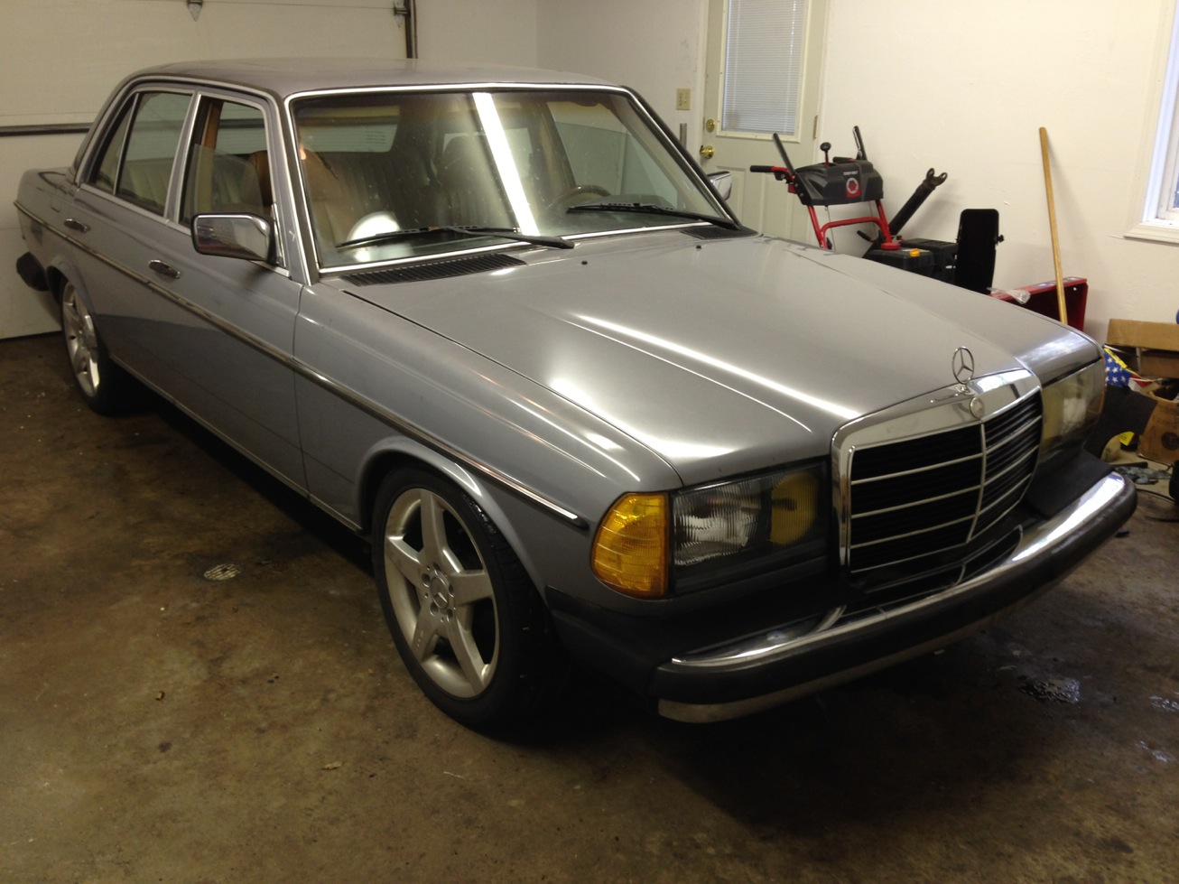

led-panzer
541
05-14-2014, 06:32 PM #28
Thanks! Yes that would look good, my plan is a polished 3.5" slant cut tip.
The next step is turbo and intercooler. I have an A/A intercooler I'm going to shoehorn in front of the radiator and a Holset HE341 Big Grin
I "frenched" the euros and blacked out the grill.
Here is a side by side comparison of when I got it and now. (at the same shitty angle)
It now will idle and return to idle when revved. Its like it had to wear into position inside the pump. The idle even when hot is very rough. The only thing I can think of that I haven't done is the rack damper bolt. So thats the next thing I'll try. Need to get the engine and trans mounts in too.
1985 300D 280,000 miles RIP

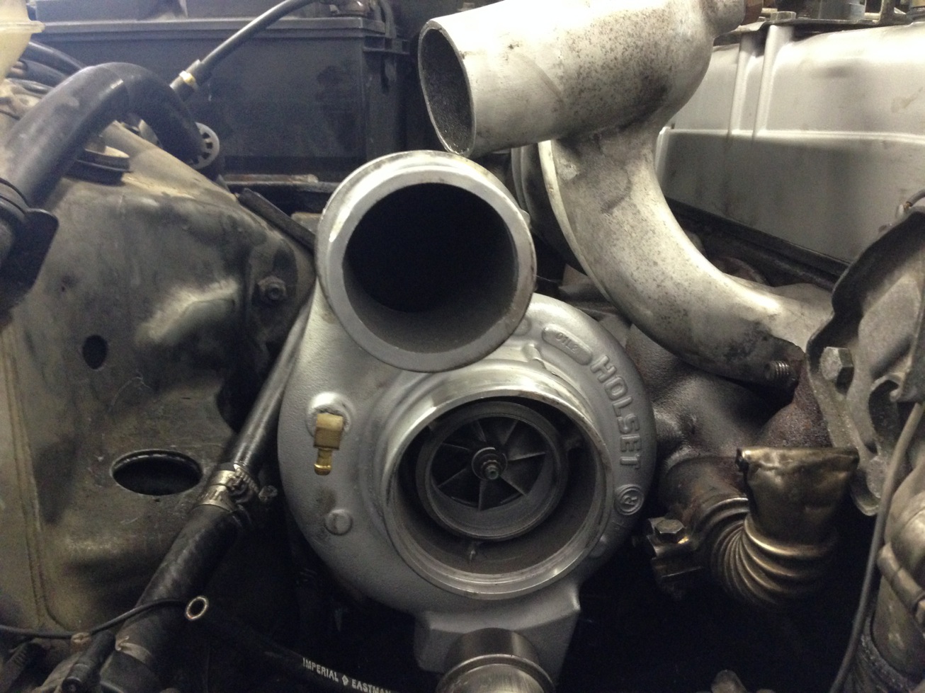

Operation Holset has commenced.

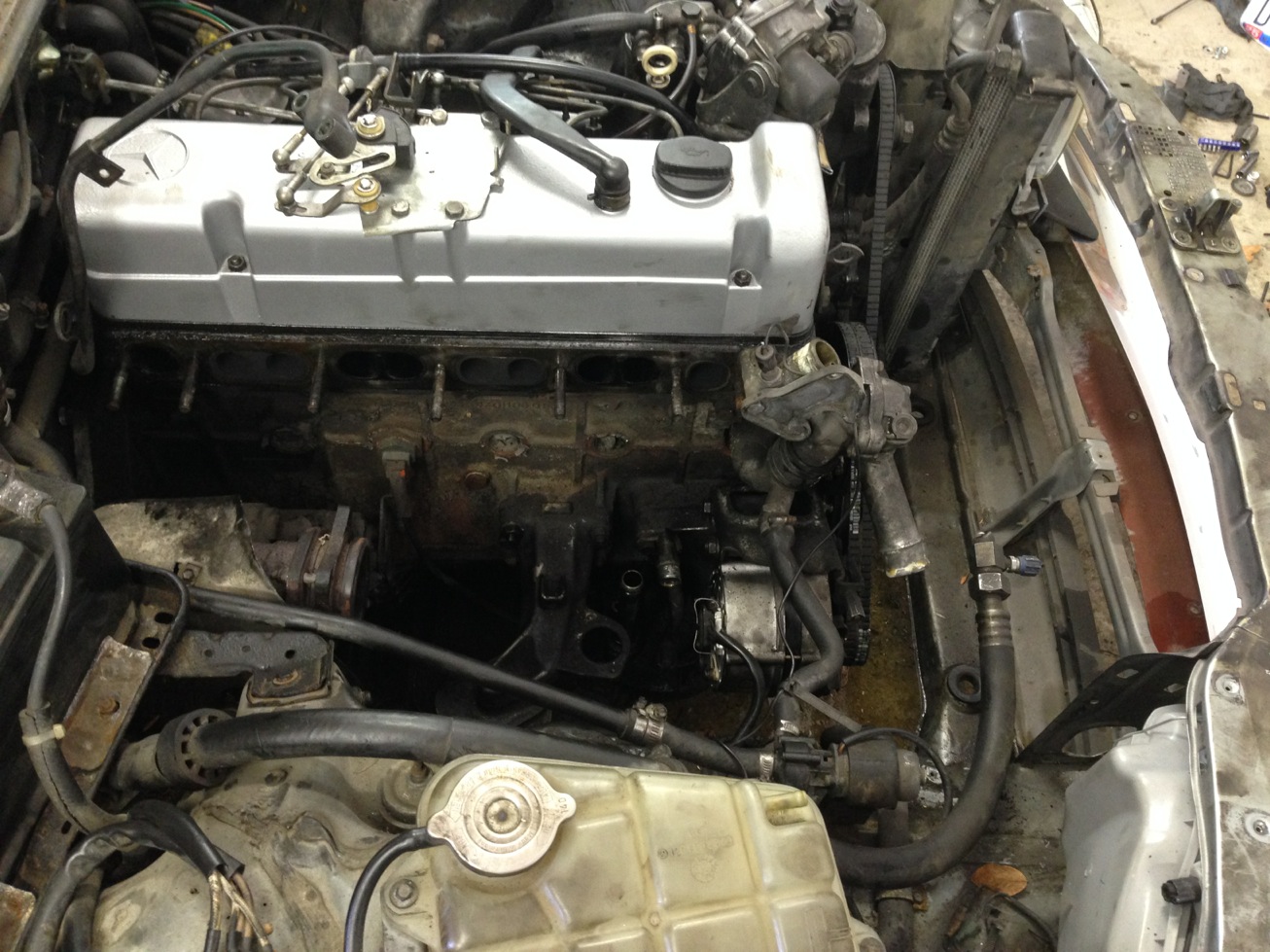

The intercooler I bought is too big. Shopping around for a slightly smaller one. Contemplating going with an aluminum radiator ala Greezer/lgreely83.
Removing the turbo and manifold was truly awful. I'm done today Dodgy

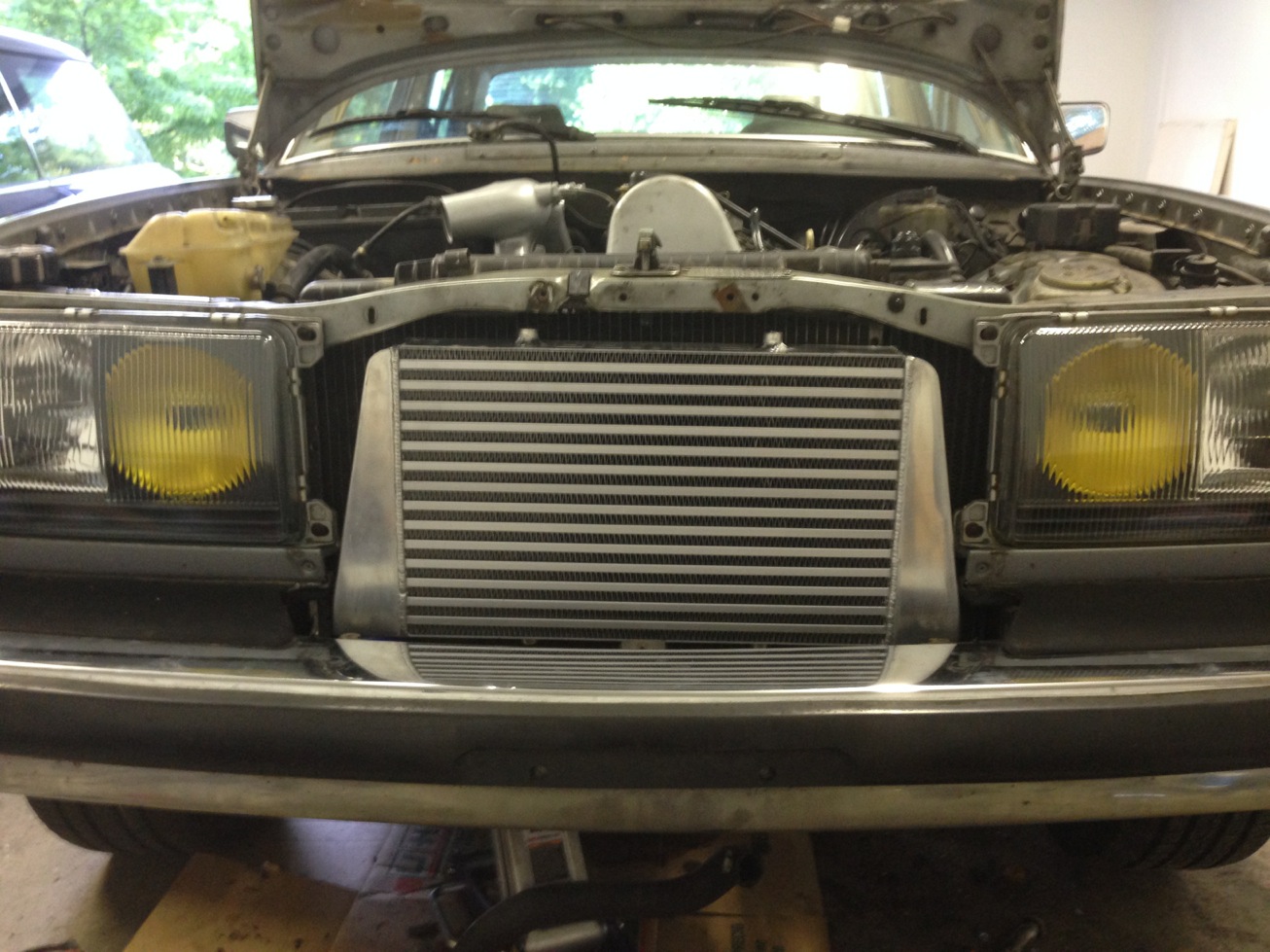

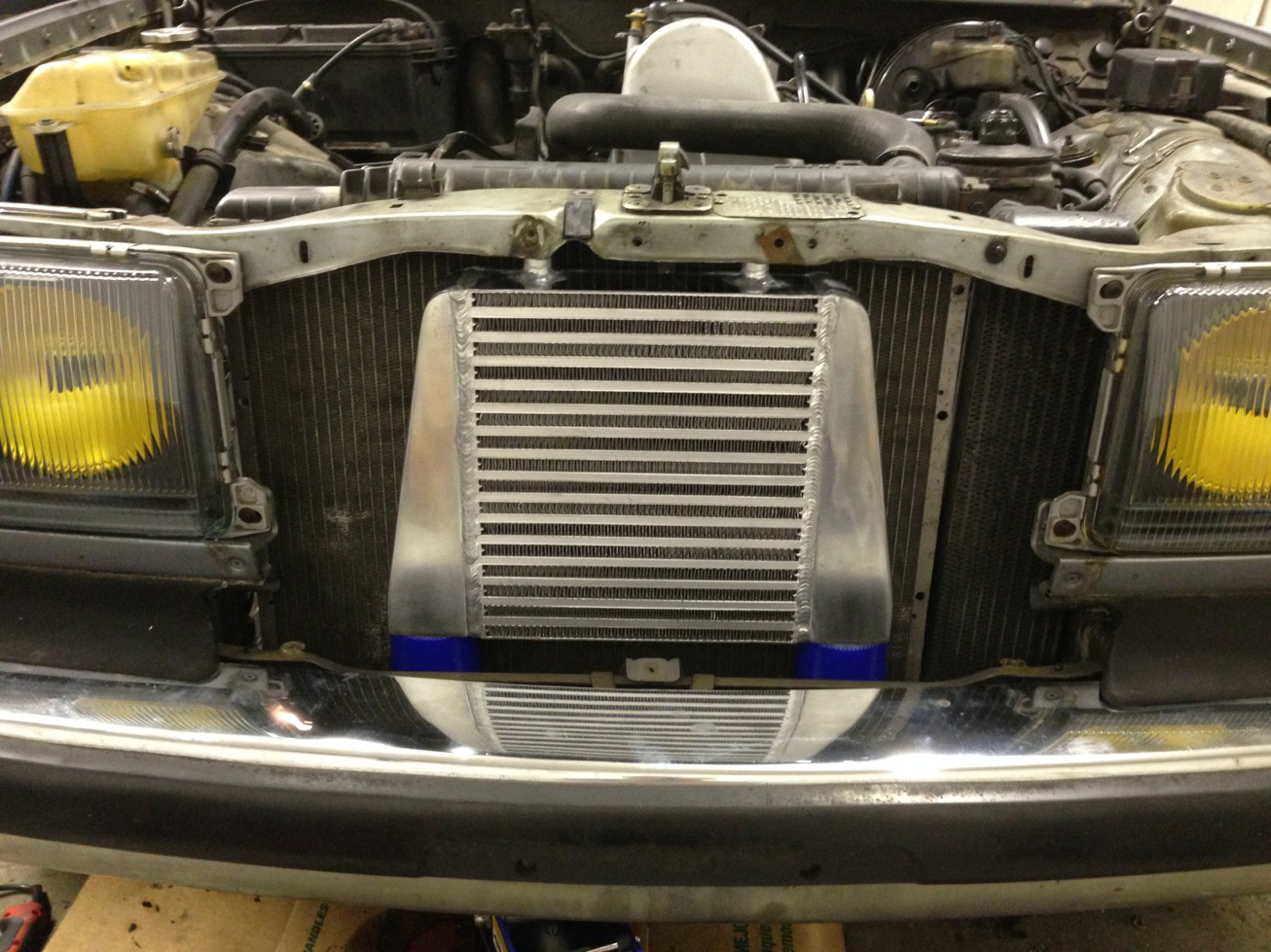

Working on it. To make it fit I had to remove the A/C and cut one 3" hole behind the drivers headlight. Price of progress Angel
This is the intercooler I plan to use:
http://m.ebay.com/itm/330510651528?txnId=986584741014

(05-19-2014, 09:42 AM)lgreeley83 Can't wait to see the intercooler. If I get a job soon I will follow suit.
Hahahah
Is that a 351? If dudes can spool HX35s that beast should be A-OK

led-panzer
541
05-19-2014, 10:15 AM #41
(05-19-2014, 10:11 AM)Simpler=Better
(05-19-2014, 10:03 AM)led-panzer
(05-19-2014, 08:42 AM)Simpler=Better VRRRRRRRRRR PSSSSSHHHHH
Big Grin
Hahahah
It's a 341. Almost identical to HY35. Dieselboy claimed 10psi by 3000rpm, we shall see

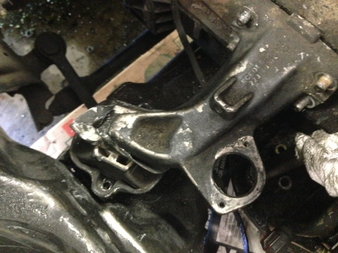

05-19-2014, 02:08 PM #42
Just to show possibilities, if you wanted to run this turbo without an intercooler you could plumb it something like this:
I briefly considered running it that way but decided to go full hog.
Waiting on my intercooler and plumbing to get here.
I've been putting off the engine mounts, for some reason I just knew they were going to suck. Well I was right. The 8mm allen bolts BOTH stripped on me. So I tried to just take the engine mount arm off but it won't come off with the mount still attached.
Tried cutting it off, twisting it, hack saw, brute strength, nothing. I was considering breaking the aluminum mount in half and getting new ones, but decided to walk away today. I'll try again tomorrow. Only way I see it is to drill the heads off.

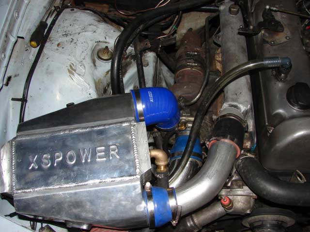

If your using that type, perhaps fitting it like this...
[Image: attachment.php?aid=456]
(05-19-2014, 02:08 PM)led-panzer ....
I thought they are 10mm? Hmm, I can't remember.
Yep, worst case, break them with a sledge hammer. The aluminum will crack in half. But make sure the bolts to the block are tightened down. You don't want to bend a stud.
This post was last modified: 05-19-2014, 02:22 PM by DeliveryValve.

05-19-2014, 03:39 PM #44
You cant get one of those socket looking easy-outs over the head of the allen bolt?
If anything even starts to strip on me, I always heat them up with a torch and them cool it off with water. Except for women, they don't like that too much.

05-19-2014, 07:07 PM #45
Cut the rubber out with a knife!

05-19-2014, 07:16 PM #46
I tried man. Knife and hack saw. Those things can't hold the fuckin engine up but they are very tough.
If I still had a machine shop at my disposal I might try to fabricate my way out of the problem, make new arms and use different (better) rubber mounts.

05-20-2014, 08:38 AM #47
(05-19-2014, 07:16 PM)led-panzer I tried man. Knife and hack saw. Those things can't hold the fuckin engine up but they are very tough.
Really? Last time I pulled an engine we jacked the oil pan and then used wd40 & a box cutter to chop the rubber out. The wd40 makes it easy.

05-30-2014, 07:07 PM #48
My intercooler came in. Too small. If I'm going to do this it has to be done right the first time.
http://www.ebay.com/itm/221198524158?ssP...1439.l2649
The above is the intercooler I'm going to try next. The outlets have to be on the bottom to work, no room to connect on the sides.
