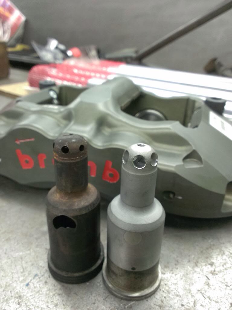

06-03-2014, 10:52 PM #13
3 front holes to .156" rear two and bottom to .125”
Stock (broken) 1985 prechamber on the left and big baller Simpler=Better ported chamber on the right
So I have turned the fuel up (torque capsule) a lot! And also an unknown amount.... My EGTs only max at about 900 so I have much moar room to go I think. Also I might add that I'm making 14-15 psi with my Garrett w/ 60 trim compressor. Inter cooler not yet operational and Injection timing max advanced (didn't check what it actually is)
My 300 rips, and my transmission is dying (like most I guess) haha. She will be getting a AX-15 when money permits. Back to the subject though, I have been running this setup since beginning of February and even though Mr. OM616 recommended not to drill the bottom hole, we did anyway haha. Just on the fact that we were going for broke, kinda. I didn't want to stay too safe and have to pull, drill, ream, deburr, twice. My OM617 runs flawlessly!!!! I've been to the desert where I've been up hills that $40,000 four wheel drives couldn't make. I've pulled an old broken down F150 10 miles to my shop that research shows weighs about 5000lbs with no issues. It amazes people haha. And it starts cold with a flick of the ignition switch after the glow plugs have been on for 5 seconds.
Edit: she does have a bit of a power band.... 3k RPM and above is where she makes the most horse power. Still makes torque from 2k and above. I've I climb a local hill, well over 7% grade! I can easily make full boost by 2300 rpm due to turbo, fuel, and pre chamber mods.
Feels to me that she is always hungry for fuel, where as before it couldn't breath, could move the air.

06-04-2014, 08:56 AM #15
(06-04-2014, 05:44 AM)baldur Well consider this. At TDC, how much of the combustion chamber volume is inside the prechamber?
Since the pistons in a 617 stick up above the deck, and the head is flat-most of the volume is in the prechamber. Makes sense that this would speed things up a bit.
Warning to anyone trying this-spend the money on nice reamers. They're hard as hell. Use lots of oil and go slow.

So if I blast mine and clean them up, would you entertain the idea of reaming them like capt's? The only stipulation being I wouldn't want the bottom hole done.
And of course I would pay you for your time and effort.
I bought a reamer with the intentions of doing it myself, but bought a tapered one because I am an idiot. Seems more reasonable to pay someone than buy a tool that I will only use once Big Grin

It's not too hard, just run the tapered reamer on a slow drill speed and keep it bathed on oil. Keeping the drill square to the hole is critical.
To maintain the same depth each time paint a mark on the reamer after you do the first one

12-06-2014, 07:34 AM #30
So, I finaly started drilling them... It's the worst job ever. Big Grin
First tried to drill with a 3mm hss drill bit. Took about an hour for one hole. Then found out could better use a grinded stone drill bit
[Image: E4EE244E-B622-4E58-93DE-6EE8AA0143A1.jpg]
[Image: BB0B0641-115F-4B15-B6CE-1F49C7DBEAAB.jpg]
If anyone is also trying this, rember to take out the glow plugs Big Grin
[Image: 6651335A-5FAD-4E83-88CB-7408883AE31D.jpg]
Only problem I'm running into now is that everytime I get to the end of the hole, the drill bit grips and snaps off. So I'm drilling them till the last half mm or something and I'll need to find out how to drill the last bit.

12-06-2014, 12:47 PM #31
Can you get your hands on a 3mm reamer?
And have you tried increasing the drill speed?
This post was last modified: 12-06-2014, 12:54 PM by hooblah.
hooblah

HSS cr 0.7 drill bits , makes wonders . i use the brand BERNER germany . buy some 3 or 4. one lasts only one hole, then Sharp it do another one. in one hour is possible to drill all of them Smile.
the best device is the electric screw driver( or the hell it is called in english) in high speed leave only 5mm of drill bit ouside, like that u can spare the bits.
i did 3 mm and 2mm at center. i did not tried them yet.
bonne chance.
PS: drill at dry conditions.

Cobalt drill bits... I guess they don't come from the diy store? Big Grin I used 5 stone drill bits, which where done after drilling 3 chambers, but mainly because the end gripped and only the tip is hardened. So it could pay off buying a cobalt drill bit.
(12-08-2014, 05:59 PM)swatmugga Hey Tito
Why did you made the holes so big? I don't think that was a good idea. What were your thoughts?
You tripled the cross section of the holes!
The surface area hasn't even doubled. (2.2/2)^2*pi=3.8 and (3.0/2)^2*pi=7
Of course 7*8(number of holes)=56mm^2
I don't know the neck diameter... But guessing by the thickness of the wall it's indeed about 10mm. Giving a surface area of 78.5mm^2.
I didn't count the middle hole. So I should be good.
Furthermore I just trying. Maybe it doesn't work at all Big Grin anyone who knows the size Jeemu drilled?

a pack of 10 x3mm HSS Cr 0.7 drill bits (those cobalt) maybe cost 15€ i dont think the issue is the cost. and amasing is that the drill bit u can Sharp. use again and again til the bit is over. i went through the same usually ending the hole is tricky thats why u shoul use a hand driller.
the inside hole is 6,7mm on the pre cups marked 606 02.
heating the PC wont do any good, what one could do is heating to where we can distemper the metal and after doing the holes heat treat them again for hardning . something is not so easy to do. simply cause we dont know the cokking temp.

Colbalt drill bits work the best, flexible but still hard. Carbide too brittle for smaller holes. I usually use only one drill bit per hole, except the back holes ,hole too close to drilled size,must sharpen bits, small size bits brake easy. Do not need to heat prechambers, Have done eight sets . Using hand drill.
Hole size,exiting holes end of prechamber, 6% larger works best for me.Tryed 8% larger, performance fell off ,tryed 10% still less, engine less responsive. Test grounds , large mountain 6-8% grade, going from 7,000-9,000ft. Best performance,exiting hole area 2x transfer tube size. Injection nozzles,checked, cleaned ,set . Injection timing 26btc,valves checked, trying to be sure testing was accurate . What was less with larger holes,engine was less smooth,longer to respond to throttle,slower to pull grade. Hope this helps. What was my speed on this grade ,65mph in high gear with more on pedal,could still go faster. 82yr. 300sd,2.88 gears,16x265 tires.

12-10-2014, 10:12 PM #42
Captain disagrees:
[Image: IMG_20140111_101408.jpg]

Tito
354
12-13-2014, 11:46 AM #50
(12-12-2014, 03:32 PM)barrote yep ,
i thought about the same, thing is where to find a VE 5 full mechanichal. or lucas i belive.
injectors are piece of cake.
in europe the w210 E290 comes with a 602 DI lucas electrical pump.
if i could lay my hands on a VE5 mechanical with a MB flange ..... i´m dreaming boysSmileSmile
regards
ps: i have my pre cups ready , just missing the special tool to remove them. Sad
You can buy the socket from eBay. Costed me 21 euros. You make make a chamber puller yourself like I did. Either with a screw type puller or a sliding hammer. I used a Volkswagen chain tensioner to make the tool. Same tread as the injector.
Btw I finished the job today. A cobalt drill bit works nicely
