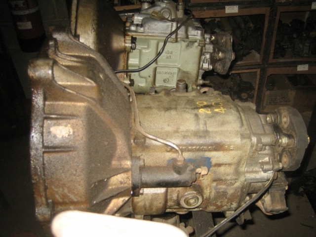

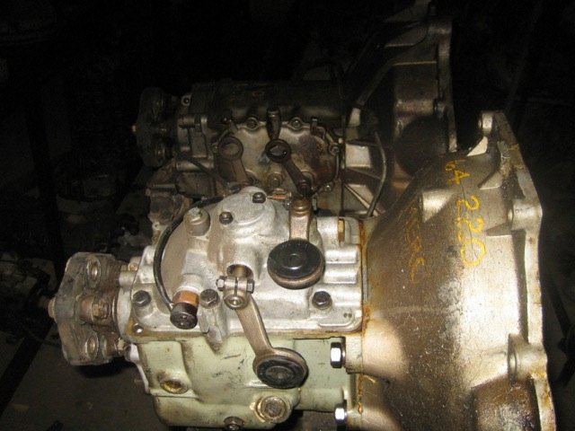

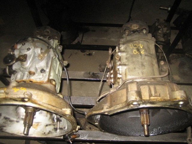

Hi, I know I just asked about non-mercedes 4/5 speed boxes, but these have come up in coincidental search. Both are said to be off 57-64 220s. One has change linkages top and right, the other has them both rh side, If someone who knows could tell me if they're suitable for a 300D, I'd appreciate that. I can't quite read the numbers, but the side-linkages one has 115 (among other numbers) stamped on the case. Both appear to have cast-iron cases with Al bells.
Graham
Oops! tried to attach a photo - try again. Successful?
