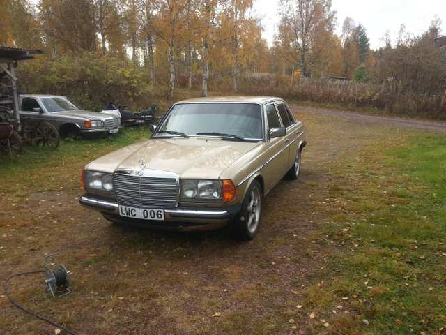

Hello!
My first post here i just wanted to show you guys my w123 with om603 turbo engine that me and my friend built and i also wanna thank him for helping me!
Sry my english is a bit weak since im from sweden. =)
Also searching for penta rims Rolleyes
in the future i will install a 606 if i can find a cheap one.
The pump max load is adjusted some and the turbo is increased to aprox 18psi, its running really good and strong.
Alda is disabled for now but its smoking so much when cold starting so i will prob install it again soon.
I hope i can answer some question about fitting a om60x into w123 if any one thinking of doing it.
Just ask anything you want to know!
Ill add a imgur link also for higher res images

Hi Fredrikg,
Thanks for joining and posting your build. Good job, it looks like it was meant to be there. I have some questions if you don't mind.;-D
When did you complete and how many miles/km since completed? Is it your daily driver?

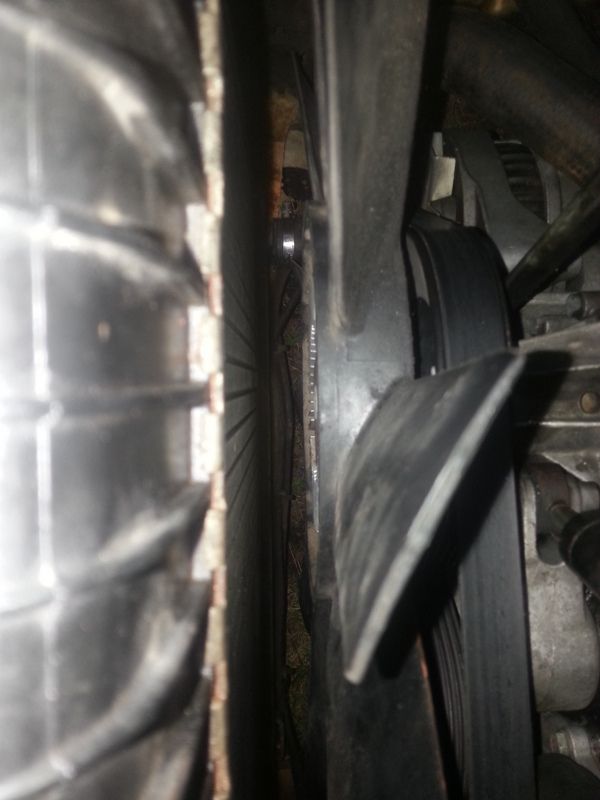

I realize the climate is cooler in your neck of the woods, but how does that radiator handle the task? Is radiator original to car? In the first pic looks like a smaller cooler just to the front of driver's side wheel well and behind washer bottle. Is that the oil cooler? How much distance between viscofan and radiator?
What are you using for transmission?
Finally, please say you didn't put that w126 out to pasture? If I had a tele-transport machine, I would be begging you to take my money and that's just for the parts I can see!
As for the smoke, try shimming the alda with copper seals until you get just a bit of smoke.
I've also seen several sets of Pentas for sale over on benz world last couple of weeks. Might be some near you? Good choice on period wheels, they will look bad-azz.

Hello!
Yes its my daily driver, hmm maybe 500-1000km since completed
Its also approved with om603 from the swedish car inspection but without turbo. With turbo you cant get it approved here in sweden apparently they say its to much torque with turbo.
I used a om603 nonturbo first, but i got a w124 300tdt cheap so ye i figured id use the engine.
The radiator is working fine its reaching max 90c when going uphill even hot days, i also think its really strange that it works so well. The radiator is from a OM616 but it looks newer than that i dont know it followed the car when i bought the car with the OM616.
Yes its the oil cooler you can see on the drivers side i will refit it later.
Transmission is a 717.411
Because it has one of the best 5th gear ratio 0.78
Why would you want the w126 in the background? haha
Thanks alot i will try that with the Alda.
Its about 4-5cm between the fan and the radiator.

07-17-2014, 03:55 AM #4
Hmmm - OM617a got 250nm, OM603a got 270nm - that's 20 more. Or is the law that you can't exceed stock power? Smile Anyway, nice conversion, I love this engine to bits!

(07-17-2014, 03:55 AM)DiseaselWeasel Hmmm - OM617a got 250nm, OM603a got 270nm - that's 20 more. Or is the law that you can't exceed stock power? Smile Anyway, nice conversion, I love this engine to bits!
Thanks, yes you cant exceed stock power. Tongue
But i will just switch exhaust mainfold take one from a non turbo, every 2 years when i need to to the inspection test.
How does inspection work in ur country? =)

07-17-2014, 05:41 AM #6
Every two years inspection - and changes need to be approved by an engineer (wheels, brakes, engine - even exhausts and air filters that are not stock etc.). But we may exceed stock power, if everything is up to it (brakes, chassis if weight is increased). We have a lot of street legal Mk1 Golfs with VR6 & 4x4, Minis with Honda or Bike engines etc. It's a lot of paperwork, not cheap or easy by any means but doable.
Sometimes I'm a bit jelous about how easy it is in many other countries. But then we don't end up with death-traps on the roads. And maybe then it's not too bad Big Grin

07-17-2014, 06:09 AM #7
(07-17-2014, 05:41 AM)DiseaselWeasel Every two years inspection - and changes need to be approved by an engineer (wheels, brakes, engine - even exhausts and air filters that are not stock etc.). But we may exceed stock power, if everything is up to it (brakes, chassis if weight is increased). We have a lot of street legal Mk1 Golfs with VR6 & 4x4, Minis with Honda or Bike engines etc. It's a lot of paperwork, not cheap or easy by any means but doable.
Same here you can exceed stock power but then its expensive and you need to switch brakes etc like you said, i did the cheaper one just to get the engine approved. =)

I never realized how lucky we are in the States, we have no emissions testing on cars (at least where I live), and in my state of ohio we have no inspection! We can basically do whatever we want, even though tampering with emissions equipment is still highly illegal and stuff of that nature is monitored but not enforced very hard.
There are thousands of 800hp cummins that a driven to work daily here Big Grin

In some states, like mine, there is zero enforcement of federal emissions laws. You can drive a new car off the lot, remove the catalytic converters and nobody would say anything. Our sunsets are beautiful hereWink

But back to the car, we need MOAAR pictures! Wink
What about motor mounts?
did you have to modify the transmission crossmember and driveshaft?
does a 603 bolt directly to a 717.411?

07-18-2014, 02:16 PM #12
(07-18-2014, 12:43 PM)MFSuper90 But back to the car, we need MOAAR pictures! Wink
What pictures do you want? Smile
The crossmember from the 717.411 did not fit to the w123 drifeshaft but i found a another crossmember from a different W124 gearbox i had laying around that fitted perfectly
Yes 717.411 fits directly

Pictures of motor mounts would be nice Smile
This would be the same install as a om606 correct?
