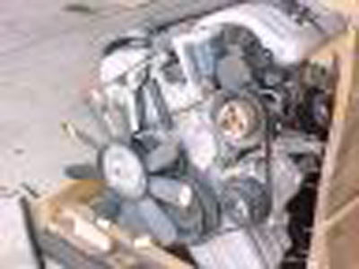

Hello existing STD members, a new member from Vancouver, BC, Canada here and am happy to have found this site. This winter, after the summer/fall camping season I will be converting my 1992 Mercedes 310 T1 Van from its M102 2.3l gas engine to a 1997 OM602.981 (OM602 DE29LA) 2.9l diesel.

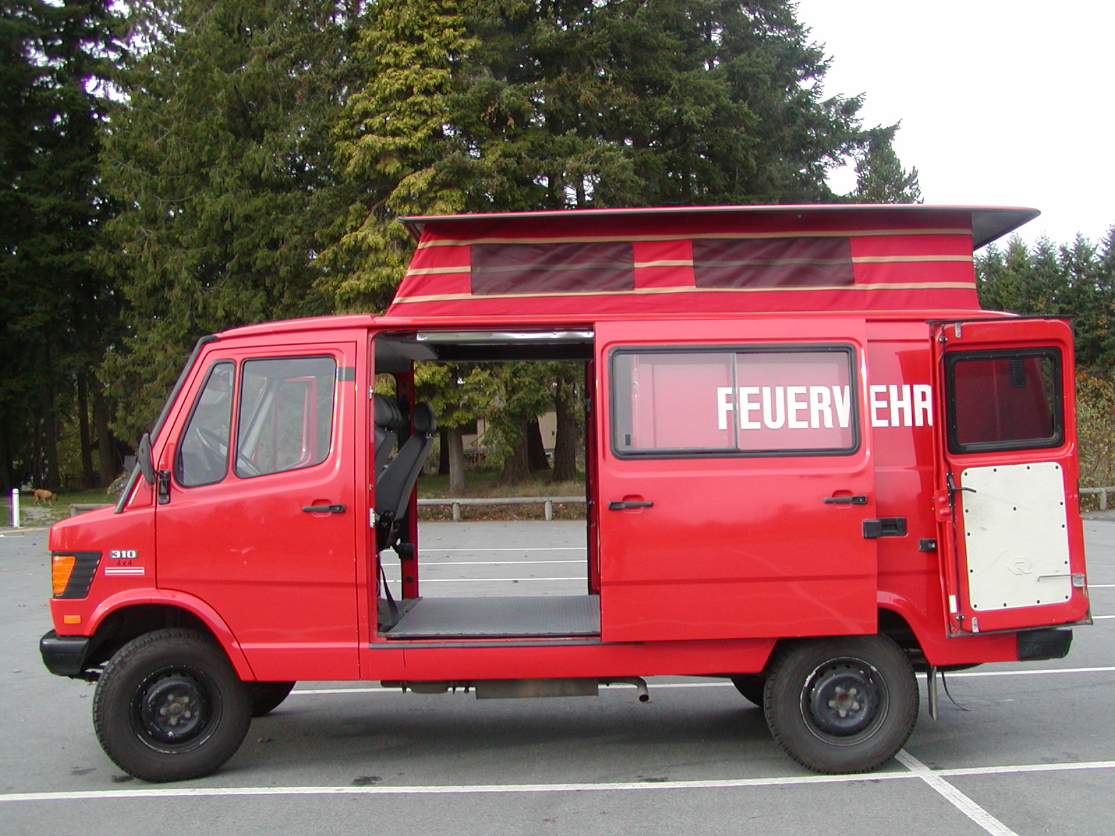

The Van, VIN WDB6020671P239703, was a fire rescue vehicle that I bought from Austria in 2010 with 40K km on it. It has an Oberaiger 4x4 conversion and is a great vehicle but somewhat under-powered. I was fortunate to locally find the diesel engine from an engineering company that that had run it in a stationary application for a couple of days back in the day and it has been stored since. I have no manuals or any other documentation for it but reportedly it is a U100L Unimog direct injected unit.
I see no identification tag on the engine and would be interested to know if it can be identified visually. Strangely it has a Aerodyne Aerocharger VNT turbo installed on it from new. The Engineer I bought the engine from said that turbo can support up to 160 hp. I had a mechanical shop that are diesel specialists run up the engine and they reported it is in like new condition.

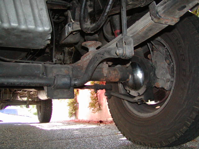

Wow that diesel engine is a nice find. What does your m102 oil pan look like? I would start with looking up your current van on the EPC by vin, and hopefully you can find the diesel NA OM602 equivalent next to it for the pan part number.
Maybe you'll be able to use your m102 engine mounts?
Droooooll that is not an engine you just find lying around with low hours on it everyday!
Cool project
aaa, the m102 oil pan is a garden variety front sump one that just manages to clear the front differential housing however. Any new oil pan may have to be adapted for diff clearance.
I don't know how to access the EPC unfortunately. Is there an online site that one subscribes to?
Regarding the m102 engine mount brackets, your question suggesting that they may be useable is a good one. It is hard to tell without removing them, but a EPC inquiry may also clarify that. Thanks for your reply.

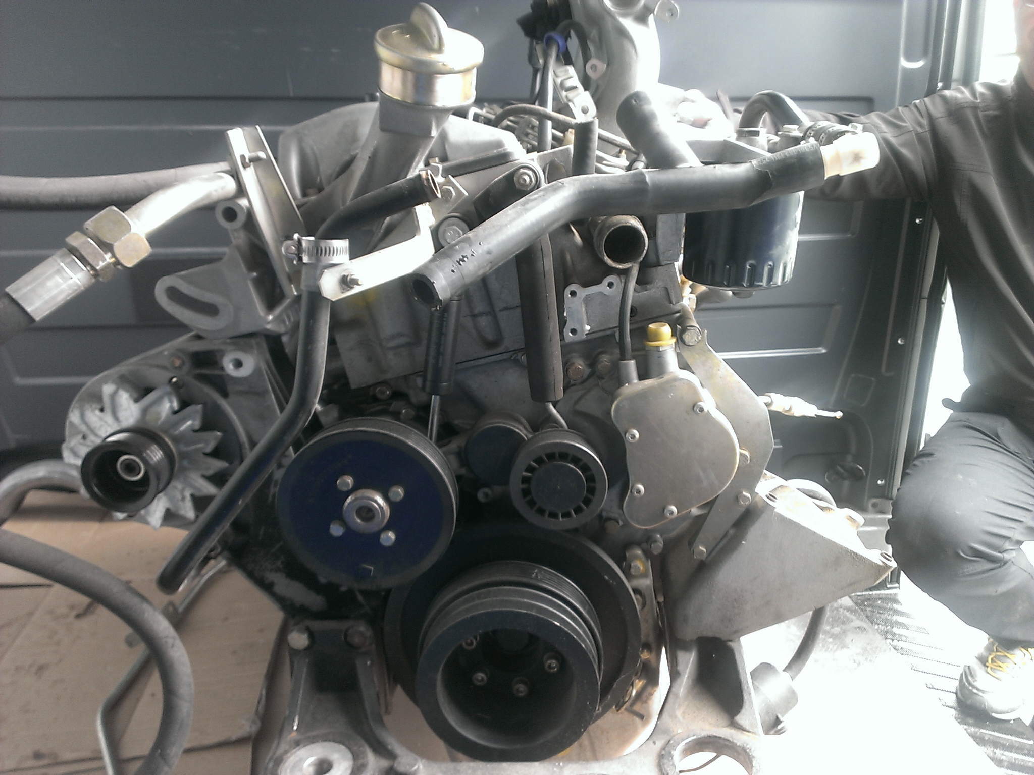

Hi another new member here.
Looking at your pictures promted me to finally register on this site.

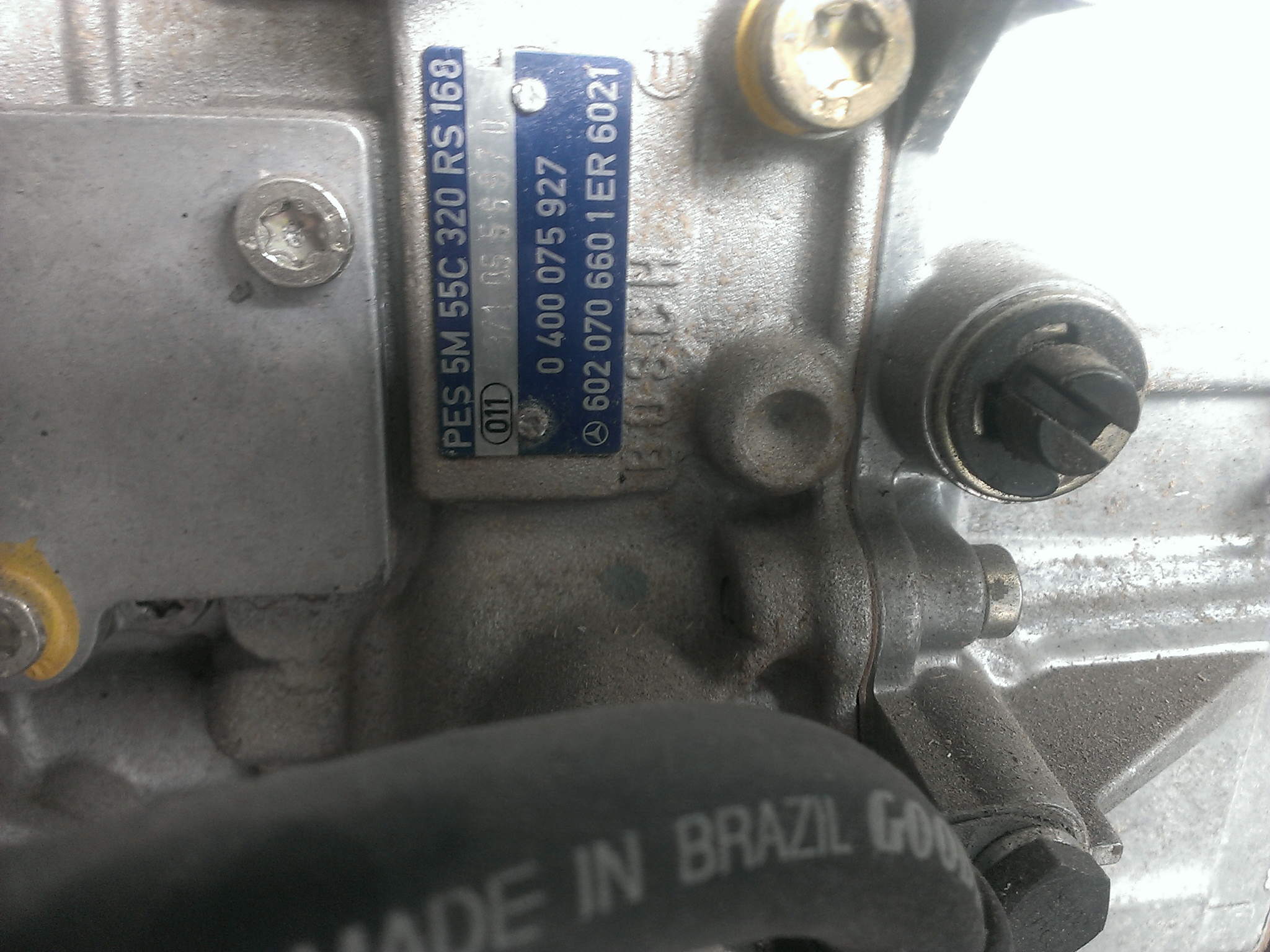

I'd say it's a Unimog engine as well, but this is not the direct injection model.
You are looking at something that was born as normal aspirated 2.9L with prechambers, in stock form giving out 94 hp and 190nm torque.
However since it had a vnt turbo added, they must have also done something to change the fuelling of the pump. There where a few companies that did those mods on special orders.
The pump on your engine is for normal aspirated engine, no ALDA just altitude compensation.
It is the same pump number that is used on the normal aspirated GD290 engine.
So I wonder how they control fuelling in a no boost situation?
I'd say you made a great find in that engine, it's just a little different than you thought.

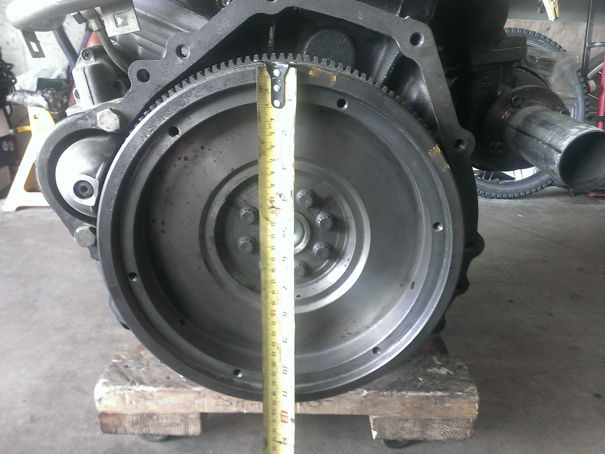

It that a single or dual mass flywheel you got on that engine?
It looks to be the same 228mm clutch that is in use in my G. Holding up to the increased torque just fine.

Nice OM602, however I do not believe it is a DE2.9LA.
The vehicular DE (direct injected electronic) motors used electroniclly controlled VE pumps (VE5/11 E 1900 R 831) and had a cross motor intake manifold attachment the had a EGR port, with the intake pointing forward to receive a hose from the inner-cooler.
My guess is that your motor is an industrial or marine version of the OM602, and that is not a bad thing, BUT!... Chances are that you will have to either re-build the pump or possibly replace it because both those types of motors have pumps that are designed to have a set RPM as opposed to vehicle motors that have constantly changing RPM's from the drivers right foot.
The oil pump intake and pan are also VERY important to look at because generators and +/- boats are always on level surfaces.

(07-24-2014, 12:02 PM)Merc4x4T1 The recessed friction surface on the flywheel measures 243mm maximum width. However I wouldn't know a dual mass one if I stubbed my toe on one
I read a thread on a GWagen forum that suggested that if a turbo is added to a non-turbo OM602 engine, the piston cooling oil squirter nozzels could/should be replaced with ones from ones specific to a turbo model because of the additional stresses on the engine. Any truth to this or does the NA engine handle the turbo loads fine in stock configuration? 15 psi maximum turbo boost has been recommended by an Aeodyne technician.
Regarding your earlier comment "controlling fuelling in a no boost situation", I observed the engine on a stand in the mechanic's shop being repeatedly run up an down through the rpm range and there was no black smoke. The engine was no under any load however.

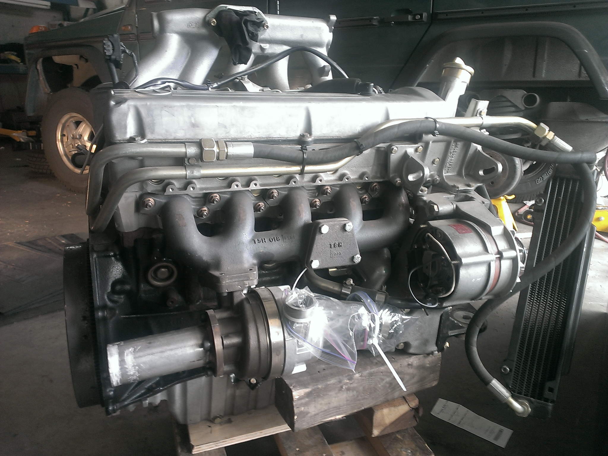

Here is my motor as I received it (in the mercedes crate with less than 100 hours on it).
Let me know if you want any specific pictures of my motor, or info., I've collect quite a bit over the years.

The dual mass wheel, you can move the outer portion a few degrees, in relation to the inner portion. There is rubber damper in between, to minimise the vibrations transmitted thru the driveline.
But with a 243mm surface, that sugest that you may have a 240mm single mass flywheel. That goes well along with the unimog therory.

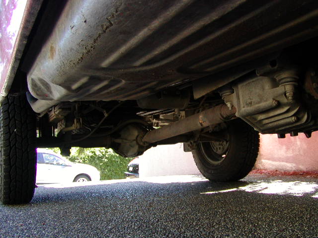

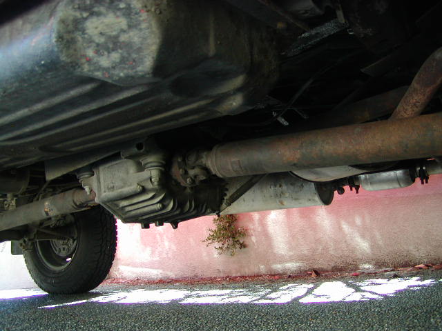

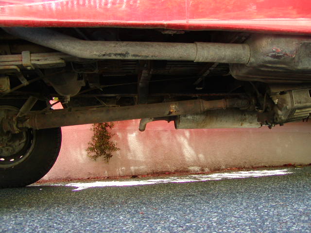

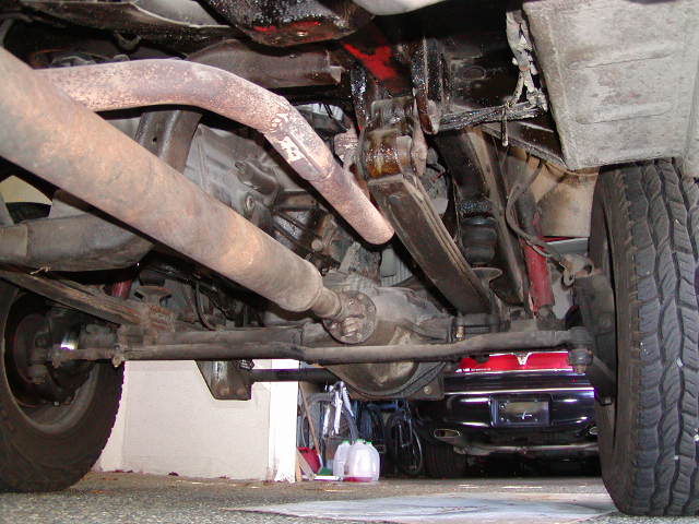

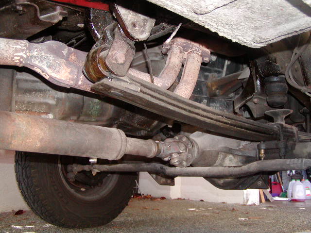

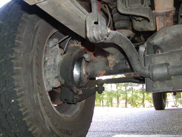

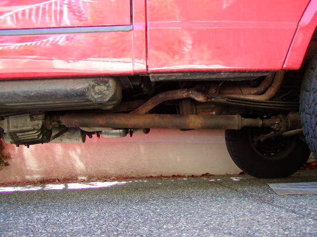

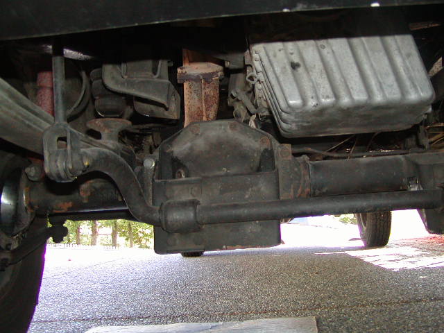

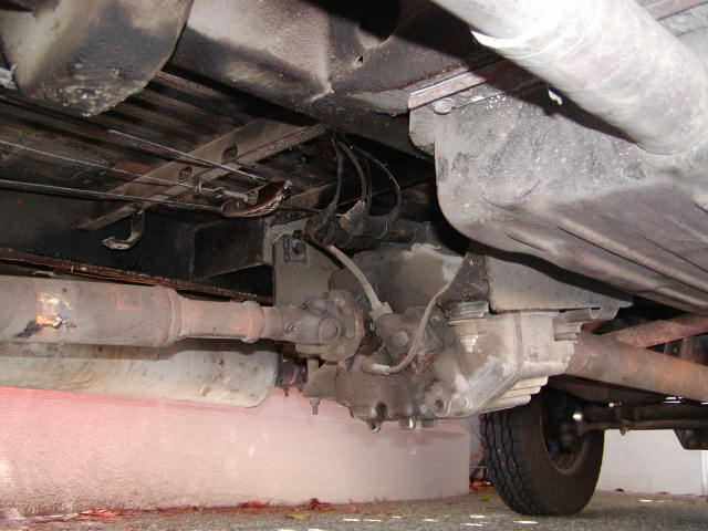

(07-27-2014, 12:04 PM)Petar Could you please take some photos of the 4x4 components.The transfer case, front axle and driveshafts. I am brainstorming about converting one of these to 4x4 for personal use.
It would be a nice alternative to buying a Jeep or a G wagen
Thanks, those pics are really helpful
