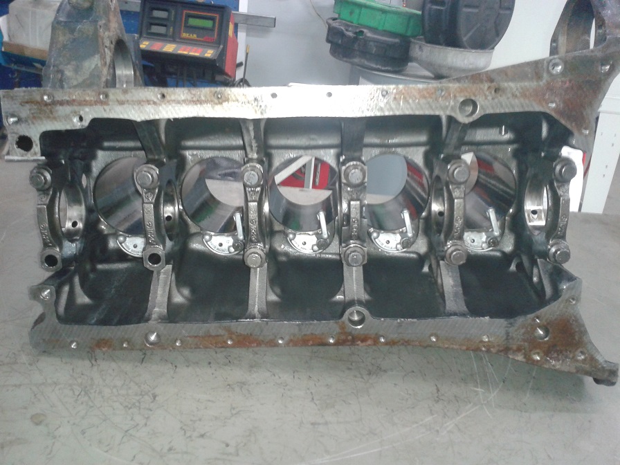

Hello from Finland. My first here.
I have to say that OM662 NA engine has oil spray nozzles to cool pistons bottom and NA connecting rod has channel inside to move oil to piston pin.
That rod is the weak spot of that engine but changing to turbo rods and pistons it can take a lot of power. Of course, if you want to rev that sucker to 7400rpm you have to put stronger valve springs etc. Those original turbo pistons are strong enough so you dont have to worrie about those. I have tested that on my old engine in Ssangyong Musso with 2,5 bar Holset hx35 and i have now replaced that old engine to OM605 turbo engine. Just have to change turbo to holset hx40 or similar and check what happens to transmission Big Grin
That picture is from OM662 NA engine block with stock oil spray nozzles.
