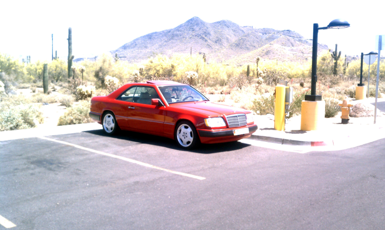

Hi all, new member here. I have 3 W124's (300CE, E420, E500) that I have been restoring/driving for a few years. I lost the EZL (what a surprise) in my red 1990 300CE about a month ago. After checking prices on both it and Jetronic CIS parts, I decided to scratch an itch I've been having re: swapping an ever-so-slightly-tweaked OM603 turbodiesel into this car.

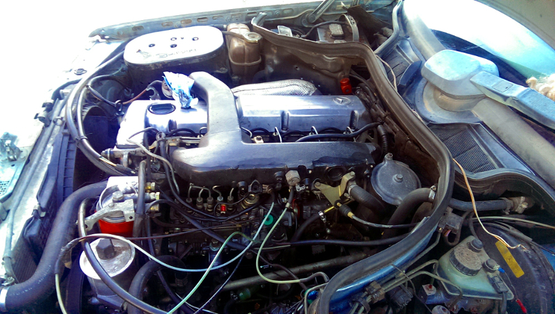

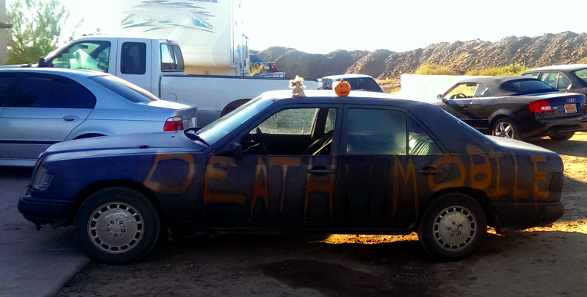

The right donor car (?) popped up last week, so I took the plunge (taking delivery from P.O. yesterday, who drove it 200 miles here). It is THE most god-awful ugly car I've ever seen; 217k on the clock, and an utterly indescribably-trashed interior. However, the OM603 is in great shape; impeccably clean w 400lbs compression all cylinders, new injectors & glows, no blow-by, and the trans works great too (no reverse lag/clicking whatsoever). I was told the turbo wasn't working, but it is indeed. I will be exploring larger elements for the FI pump, or perhaps just turning up the stock one all the way via ALDA etc (lots of research left to do). If that happens (i.e. the elements), a T4 or Holset HX35/intercooler/meth injection will also find a home in the engine bay. I will be pulling everything of use to me very shortly, and then I'll probably put the poor shell out of its misery by running it over with my track loader machine. I've honestly never seen a car so horribly mistreated (other than the mechanicals); the disparity was/is really bizarre. One of the front strut mounts broke, so they just cut a hole in the hood to let the strut stick out and jump around (scary). In any event, we decorated it for Halloween....

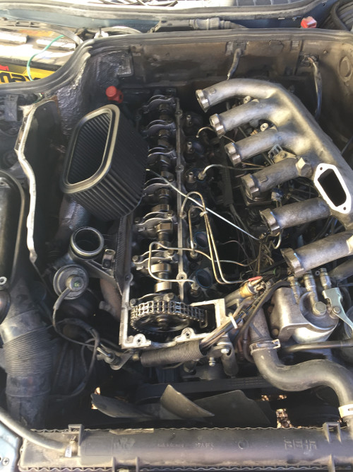

OK, turns out the "Death mobile" has an original #14 head casting (albeit in great running shape), so I've acquired a #20 casting from an 86 W126. I'm also getting the injection pump from it to send in as a donor to Dieselmeken, as the pump on the DM was new in 2012. If anyone needs an almost-new stock pump, I'll be selling it a bit down the road. Here's the #20 head coming off....
