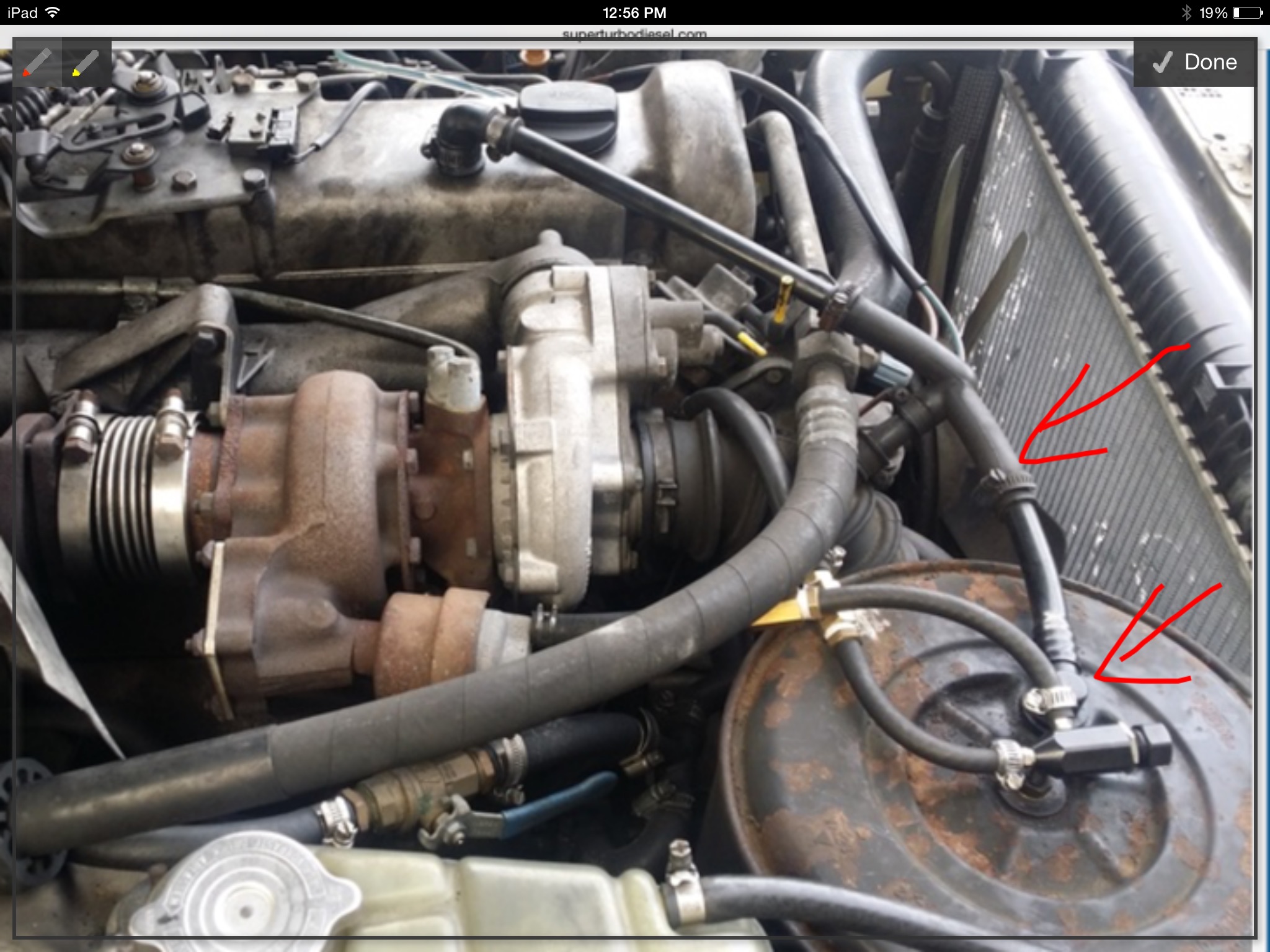

Under the Hood
[Image: 20141104_134338.jpg]

Under the Hood

12-03-2014, 02:14 PM #35
You might have already checked this. Maybe the oil seperator in the air cleaner is clogged.
Crankcase pressure can be very bad since it can blow front and rear main seals out.
I would treat the oil leakage around the valve cover as a symptom, not the problem.
79 300CD
82 300SD

12-03-2014, 04:08 PM #37
The picture below shows what I'm talking about. There is a contraption in the air cleaner that separates the oil from the crankcase gasses. That might be clogged. There are a lot of ways to test for crankcase pressure.
You can start the engine and remove the oil dipstick then put your thumb over that opening. You will feel the pressure on your thumb if it is there.
Another test is to completely lossen oil fill cap while the engine is running and see if it will stay in place. If it dances wildly you probably have crankcase pressure.
The stock oil separator always induces some crankcase pressure. A lot of us have gone to an oil catch can to completely eliminate it.
79 300CD
82 300SD

12-03-2014, 05:51 PM #38
That line leads to nothing inside the air filter housing. It drops straight down to the bottom. I will test for pressure at the dipstick tomorrow when it is not pitch black and 20 deg. Thanks for your help!

12-16-2014, 04:32 PM #41
(12-03-2014, 05:51 PM)SupremeTurbo617 That line leads to nothing inside the air filter housing. It drops straight down to the bottom. I will test for pressure at the dipstick tomorrow when it is not pitch black and 20 deg. Thanks for your help!
If there is a great amount of engine blowby, crankcase pressure will push out oil at higher engine speeds. If so make vent to turbo more direct, or restrict vent line at air filter. This allows turbo to help pull vent gases out .
