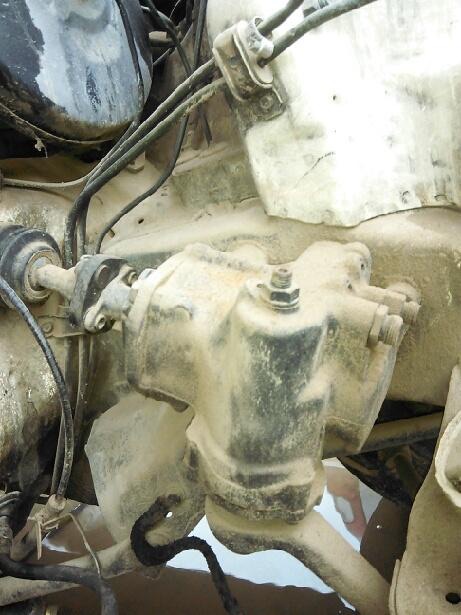

I think I found a manual steering box at a salvage yard. It is a ways away for me so I asked them to send me a picture. This looks to me like a power steering box with the hoses removed.
It's in an '83 240d.

No, if you look to the far right of your snappy, you can see two threaded ports or nipples. Those are the PS lines (albeit removed). Plus, looking at the rubber grommet against the firewall where the lower steering shaft goes through, which is partially out of the picture, it looks too short. Also, not sure the manual box has the adjusting screw which is around center top of the box (I will have to double check.). Remember if you find one at the JY, remove the box with Pittman Arm attached and the make sure you get the lower steering shaft and the rubber boot (grommet, which is around 3" long vs. 2" PS one).

Also the adjustment screw looks to me like it's at the end of it's lot. The further out they are the more adjustment has been previously done.
