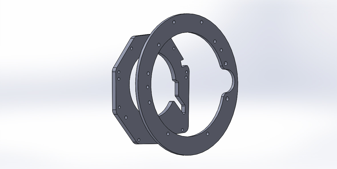

I'm right about now developing a bellhousing to use a Tremec T56 BoltOn with the om606 (and other inline Mercedes engines).
Wait 2-weeks and then you can buy one of those from me
Having the first prototype cut right now...

(12-27-2014, 12:42 PM)F.R.A.S ZF that build the BMW transmissions rates them in the gerbox number. A 32dz is rated to 320Nm, a 37dz is rated to 370Nm and so on up to the 53dz that's rated to 530Nm. How ever they are a lot stronger than so. The 53dz is indestructible a would with no problem work in an Abrams tankVery interesting! I may very well be interested in the adaptor.
Here's a preview

(12-29-2014, 10:53 AM)SurfRodder Ballpark on price for these adapters?
Actually not an adapter it's a complete bellhouse.
The drawing is missing some bits and pieces and the plates between the sections.
Ballpark number is $670 + shipping. Have to make a 100% done first one to really know.
There will be an option for racecars to get thicker steel in the bellhouse to comply with race regulation. ball park number for that is +$130

(12-30-2014, 07:54 AM)F.R.A.S Actually not an adapterit's a complete bellhouse.

To much stuff to do and still only 24h in a day
Will sort this out eventually. The jig is laying here half done and is just waiting to get done
