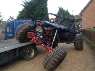

i have a 605 with a dieselmeken 7.5 pump which i am going to put in an off road buggy, like the idear of fitting the eaton m90,is there any thing i need to do other than fitting to side of block and plumb up and away we go or is it more complicated.i too are looking for torque and quick response cheers gary quick pic of buggy too
This post was last modified: 01-22-2015, 04:40 PM by gary andrews.
discovery 2 fitted om605 m pump 7.5 elements 300 turbo at mo
c250 std at mo
off road buggy fitting om 606 turbo ? supercharger ? to follow
