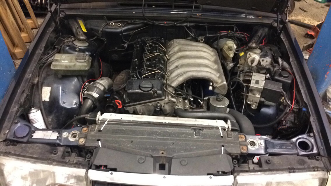

Volvo 940 tdic estate
OM606 engine swap
Engine approved in car.
Pictures will Come, but have'nt taken any
1#
Volvo 940 estate 1995
Originaly a d24tic
Changed to OM606.962 From the old 81 Benz
4" dp, 3,5" stainless from DP out.
8mm dieselmeken pump att 180cc
BW kkk K29 turbo, 15cm hot side
home made flywheel with sachs 765PP and original mercedes 240mm organic disc
6speed cdi box
4,5" humongus cooler

Haha, that's just so because the original mounts don't fit anymore

some new update ! I will soon going to the norwegian road department Smile
to get it street legal with that engine..
the rewelded oil pan:
[Image: image_zpsewu8rlhf.jpg]
lost about 1 Liter of oil, but have instaled a 30 row oil cooler, so I have roughly the same amount of oil as stock
needed new oil pick up for the new sump:
[Image: image_zpskluaomru.jpg]
version 1.0:
[Image: image_zpsiaxkawrx.jpg]
failed.. since it hit the oil pan..
and offcourse, I forgot to take a picture of the 2.0 that was final..
and to top it of this time.. I made a plate to hold 4x 53mm gagues, still not finished, will come new pictures when its done:
[Image: image_zpsqjmytytj.jpg]

Hey, you still around? I was wondering, I'm about to cut my oil pan too, in order to get the engine further back, but I'm wondering would I really need to cut it as much as you did, or somewhere just before oil level sensor would be enough? Any chance of posting a photo or two that shows how far back exactly engine sits in your car and how does it look from underneath - i.e pan to subframe difference?
