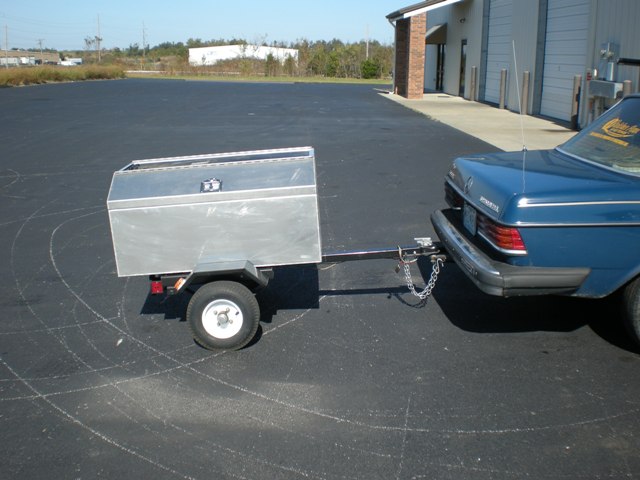

hey Mercedes deisel guys! over the next few months will be asking some random and dum questions! some time next year there will be the first cannonball in 30 years, i plan to bring a slightly modified SDL. anything that can raise my MPG well giving me some extra power(225 whp would be great) but ill get to that in the engine forum.
So far one of my teams main problem is that where planing to carrie well over 100 gallons of WVO, test show that we can cruse at 80 with out a problem but it looks avoids and dangerous. did mercedes make a over load spring for the w126? or should i look im to making a helper coilover for the rear? the pros of the coilover is that i could get the spring rate/shock. the con is they may fail leaving me with out a suspension!
[Image: img1231808006712-1.jpg][Image: img1231724701604-1-1.jpg][Image: img1231603208122.jpg]

09-14-2008, 10:21 AM #2
The suspension can't handle more than a few hundred pounds without hitting the bump stops when it bounces. I'd look into adapting the SLS suspension from a 560SEL. The 300TD can carry a hair under 1000lbs payload in the rear with it's SLS.
You won't do very well on track day with that much weight and you'll need that 225hp to maintain speeds above 85! You'd be far better off plotting BioDiesel sources along the route or having a fuel hauler drive ahead while you sleep.

09-14-2008, 10:42 AM #3
ForcedInduction You won't do very well on track day with that much weight and you'll need that 225hp to maintain speeds above 85! You'd be far better off plotting BioDiesel sources along the route or having a fuel hauler drive ahead while you sleep.
im not planing to be on a track or make many turns, not sure what SLS is but with stock springs and light duty truck shock i stayed off the bump stops...
making fuel stops would kill us. the drive plan calls for 33 hours of driving...non stops dirving , i should be able to cut a few hundred LBS from the benz(fron seats alone must weight 80 lbs each plus shaving the hood trunk and doors). and that should help us.
but i think a coilover with a 1100 pound spring may work...or fail

09-14-2008, 10:50 AM #4
Self Leveling Suspension.
<!-- m --><a class="postlink" href="http://en.wikipedia.org/wiki/Hydropneumatic">http://en.wikipedia.org/wiki/Hydropneumatic</a><!-- m -->

09-14-2008, 11:06 AM #5
ok ok my fathers 300tdt has sls...

09-15-2008, 10:03 AM #6
Some have reported loading more in there than 1000lb. Wouldn't recommend it though.

09-17-2008, 12:14 AM #8
Dude, baffle the holy hell out of the tank and build it as low profile as possible. Also there are some "additives" you can use to help the burn characteristics of the VO.

09-17-2008, 07:45 PM #9
tantank79 You're seriously going to Cannonball an SDL?!
yes me and 30 other cars are in the line up. i plan to build a fuel tank in the car(making the tank a part of the car w/o flex). if i can build a 100+ gal tank plus the stock tank i think i can make mercedes the first diesel to win the cannonball!(and first WVO entry!)
... please trust me... i have Alex Roys ok on my plans!

11-01-2008, 10:05 PM #11
well i think i got u beat... im having a Fglass hood trunk and door skins... i think this will shed some srs lbs...
but back on track.
after alot of thought and many inspiring phone calls, we will be using airbags!
No not cuz they look sweet, but becouse we will be losing alot of weight in a short time(under 35 hours)
what we are plan on is being able to ajust the car well moving AKA gear venders over under drive will let us change our gear ratios well moving and air bags will keep us at a factory hight and wont make us bounce...
please we are hoping on your input! maybe a sticky?

11-04-2008, 08:26 PM #14
wow.. gearvendors... :mrgreen:
You are gonna need some power if you want to keep up Wink If you are gonna commit, you might as well go all out with big injectors, DVs, propane (will also help your fuel consumption), HY35... Don't expect it all to bolt-on, which if you are seriously considering airbags and gearvendors, you probably aren't worried about such things Big Grin
Also, consider upgrading to 8x16 wheels with something like 225s on them, both for the handling, longer legs, looks, and for the extra weight-carrying capacity. The wimpy tires on the 14" bundts will be trashed in no time by the weight and speed (broken bands, rattle your teeth out).

11-10-2008, 09:00 PM #15
well this event isent about power, any car with 100hp(even a 240d! :mrgreen: ) can go 80mph and thats all i really need. the goal is 80-85mph avg at 27 mpg... the problem is we will be pulling alot of weight. about the same as a small boat and trailer in the back seat!
as far as the turbo go's, im planing to make a block style main in the next week or so, setting the turbo up front. right behind the a/w ic
Injectors... all the info i see points me to TDI or dieselgaints. is this the injectors that would be a good chose? the dodge community are heavily pushing the idea of having my stocks worked over. but i have little test and tune time and i rather use a proven part.
please help me with what i can do to improve my IP and or DV set up
as far as wheels and tires go. either a AMG rep or a custom made steely(narcar style) the steel is lighter and looks less flashy. for tires i will use Kumo's Ecsta ASX. is performs great in the wet and dry.
looks like gearvendors dosent like my little euro, lol so it looks like im going to see about a custom rear end gears.

11-11-2008, 01:27 AM #16
Be careful on the rear end. If you go up, it will not have the oomph to beat the air resistance. As far as max speed goes, if you are keeping the power stock, stick with the stock rear end and just wind the revs out all day long. 90mph is like 3800 or something.. no biggy. Just make you do enough test runs to determine when you have to add oil Big Grin Dieselgiant injectors will do nothing for you. They are the same as stock.

11-11-2008, 06:01 PM #17
GREASY_BEAST if you are keeping the power stock,
well not stock! just trying to keep the power to MPG in ratio
well i built a little rig that will add oil if we do have a failur...
what kinda injectors would be worth looking into? canada TDI?

11-25-2008, 12:55 PM #18
Remove power steering, ac, dash, interior, trunk, rear windows(replace with canvas/plexiglass), fog lights, use a smaller battery(Assuming you won't be shutting the car down after the initial start). If you have a sunroof remove the motor&stuff, and weld/glue it shut. Also dump the passenger side mirror if you can legally.
Aluminum belly pan, higher ratio differential(lower acceleration, higher top speed and greater fuel economy)
get rid of the EGR, muffler, shorten your exhaust to be a side-exiting straight pipe
If you're really looking for HP a VNT and air-air intercooler would be worth the extra cash/weight. Just make sure you use a real(not K&N style) air filter replacement if you go the VNT route.
2stage injectors from a VW will get you some HP(Forced Induction has a writeup on them)

Heres another option possibly. I have dealt with the same consideration for VO, although my reasons are more because I hate searching for it, than for racing.
What are the cannonball rules about trailers?
This is an early pic of my "Distance VO trailer". I took a motorcycle trailer with a 1/2 lb bumper weight, built a double case to hold tools and parts, and dropped it over a 50 gallon boat tank. The trailer capacity is 800 lbs, and the tank and tools loaded come under about 650-700 lbs. This tank, combined with my twin trunk tanks gives the car more than a 2000 mile range, closer to 2800 miles with all 4 tanks.
This is an early pic, I ended up balancing it properly, adding a spare tire holder for the car, and painting it black. Loaded with fuel, it tows great and you hardly feel it except for a tug at the bumper.
05-04-2009, 07:18 AM #39
