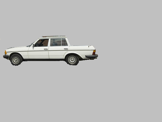

As many of you may have already read, I'm ready to let go of my Mercedes. Though before I do, I had a crazy idea that I just might do.
I want to convert my Blue 300TD to a truck/convertible. I will most likely be parting it out later, and there aren't many parts to be salvaged from the roof, so I don't see a major potential to destroy any sellable parts in the process.
I would make the cuts on the body right along the line below the windows all around. The only vehicle metal that would remain above the line would be the A-pillar for the windshield and the small triangles on the doors to keep the side view mirrors intact.
I know that some may be offended by my plot to chop top a Benz, but I assure you that this car has been very used and somewhat abused in the past and I would like to try out this idea as an attempt to possibly give it a new lease on life.
I do have two areas of concern though. I am slightly worried about structural rigidity around the doors. I don't the car to bend in half. I am also worried about the windshield being supported enough without the roof behind it.
What do you think? Sounds interesting huh?

IsaacDW
Turbo-charged
26
09-02-2009, 01:46 PM #13
That was my initial plan, but it appears that I will either need to weld the doors shut permanently or drop a $1000 to have a roll cage installed. Neither of those options appeals to me much, so right now the plan is to make it a partial truck, only from the rear doors back. I guess I could always cut more if the initial chop turns out well.

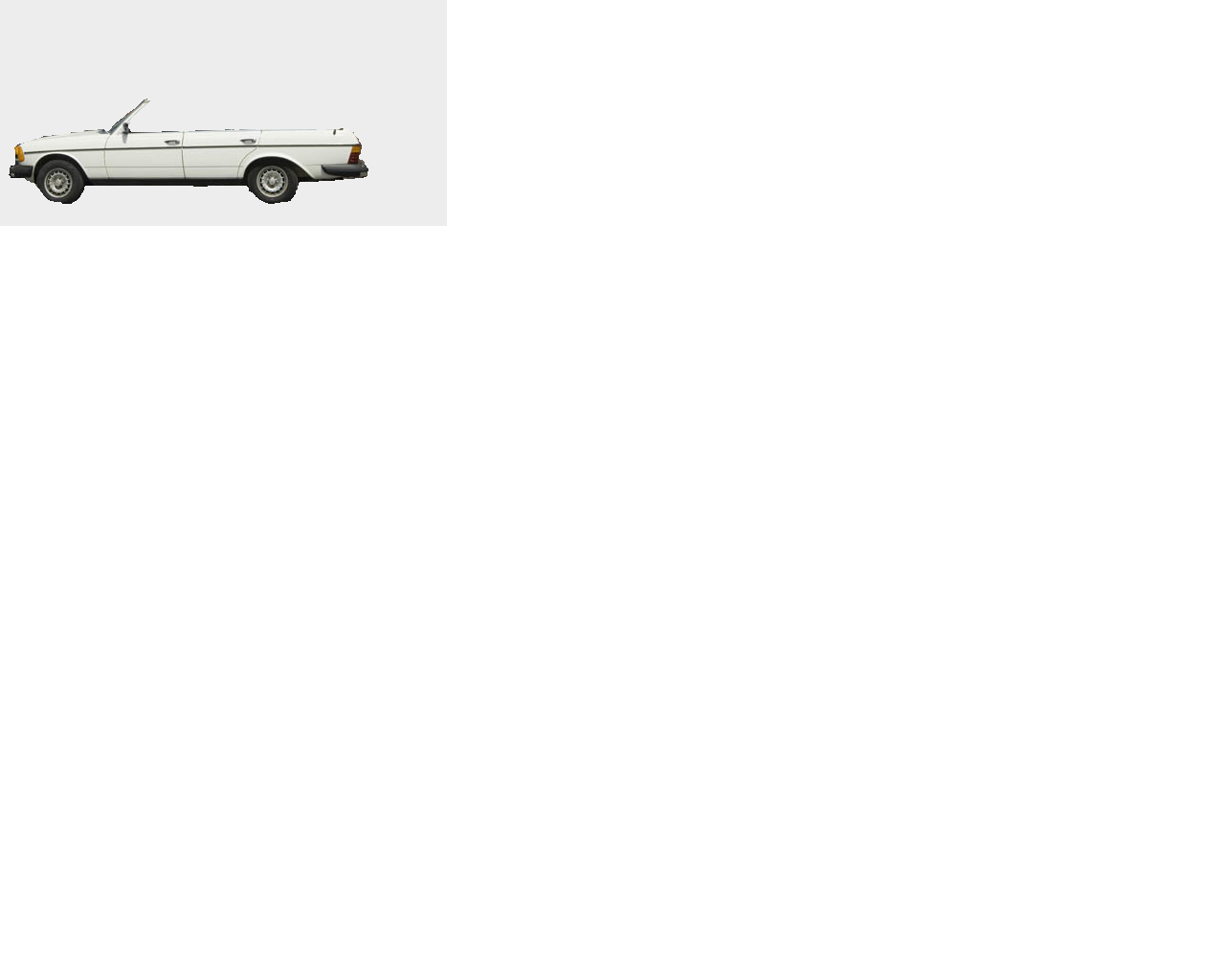

CID Vicious
11-14-2009, 11:36 PM #18
[Image: Benzomino.jpg]
Bah, my benzomino looks better...at least to me Big Grin
I was looking into this when I was working with the Mercedes/Eurocar tech, he had a 300D NA that was pretty beat up for cheap. I looked it over, and the sedan has all of the right features for the conversion - weld the back doors, the back half of the roof moves forward, gets mated to the front section (ahead of the sunroof, behind the windshield), you do it right and it all lines up perfect and you'd just stitch together the remainder. Do it right and no cage necessary, nor any harassment from the cops.
Finish it up with some wagon lights and a custom fabbed tailgate...screw keeping the back seats, and double screw keeping the roof over the back seats, it doesn't look like anything other than a Volvo 740 sedan. A 'proper' W123 Benzomino as above would have as much bed length as a Tacoma, making it a 'real' truck. Add some heavy duty springs in the rear, or if you want to get super fancy, pillage an SLS system.
The SLS idea is the only good reason to try this with a wagon, IMO. The Sedan comes together better, and even to me, who loves automotive blasphemy, carving up a wagon like that seems foolish. I'll bet there's someone willing to pay a pretty penny for that wagon in your area, regardless of the condition. Sedans on the other hand are so dime a dozen...
Surf Rodder, I think the reason your Cherokee didn't change much with the roof cut off is because Jeeps are frame vehicles, instead of being a unibody like our cars are. (Hooray for old school tech?) If I were to do this project (which I just might), the rear doors most certainly get welded, and you'd do that before you touched the roof. One that roof is compromised, keeping it from getting misaligned will effectively be impossible unless you're doing this in a shop with alignment and/or frame work equipment, and you're not, are you? So weld the doors first.
Done like the image above, the moved-forward roof welds in and square tubing or other support material can be added if deemed necessary. Otherwise, since you're welding up a decent box, you shouldn't have problems with rollover or torsional rigidity, at least not compared with the hacked open, gaping hole I'm envisioning would be left over on the white car above.
I'd say if you're going to hack it open and leave it like that, go full roadster with it, instead of this halfway stuff.
Oh, and one lesson learned from the Mercedes tech: one of the cars we worked on was for David Duchovny, (sp?), late model convertible off of the S platform converted to run a six cylinder turbo diesel. Long story short, with my friend's expertise in custom work and background in Mercedes stretching back to the late 70's when our cars were new, combined with Duchovny's deep pockets, couldn't solve the reason why Mercedes never offered Diesel Convertibles from the factory - fumes. And that was with a later model, more sophisticated engine, and the budget to fab up whatever could be imagined out of titanium if necessary. I'd say, if you're going diesel roadster, you too might find out exactly why Mercedes left this niche unfulfilled.
Now, weld them doors shut, unscrew all of the glass from the front doors back, and replace with steel. W123 sedan delivery, so cool...I almost got to do an SD with my '66 Squareback, really should have...

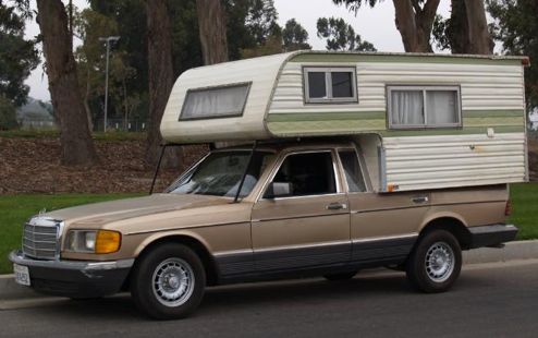

11-18-2009, 11:16 AM #21
It certainly seems to be sitting a lot higher that we would expect.
There are some refinements that I would change, (that center window looks like taped on plexi), but from the other pictures, this thing actually, (although possibly hacked), looks pretty interesting.
I like the access from the car into the camper.
This post was last modified: 11-18-2009, 11:17 AM by JB3.

11-18-2009, 04:57 PM #22
I actually saw that thing on the freeway. it drove spooky
