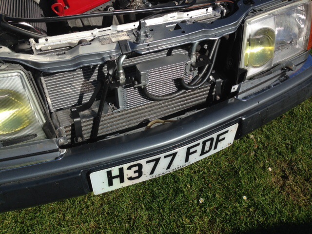

You can share photos of how to apply intercooler W124?
Thanks...

[Image: 20140521_134529_zpsygj6gu6l.jpg]

on the way like the IC is installed on the first picture. you can fix it with cooler of the AC too.
only push the cooler some cm to the motor and you have enough space to install the Intercooler without the brackets Daimler welded to the front bar .
so you have not to cut away material from the lightframe
At the moment I am installing a windshield on the top of the IC to lead the Wind more to the IC.
greets ul
