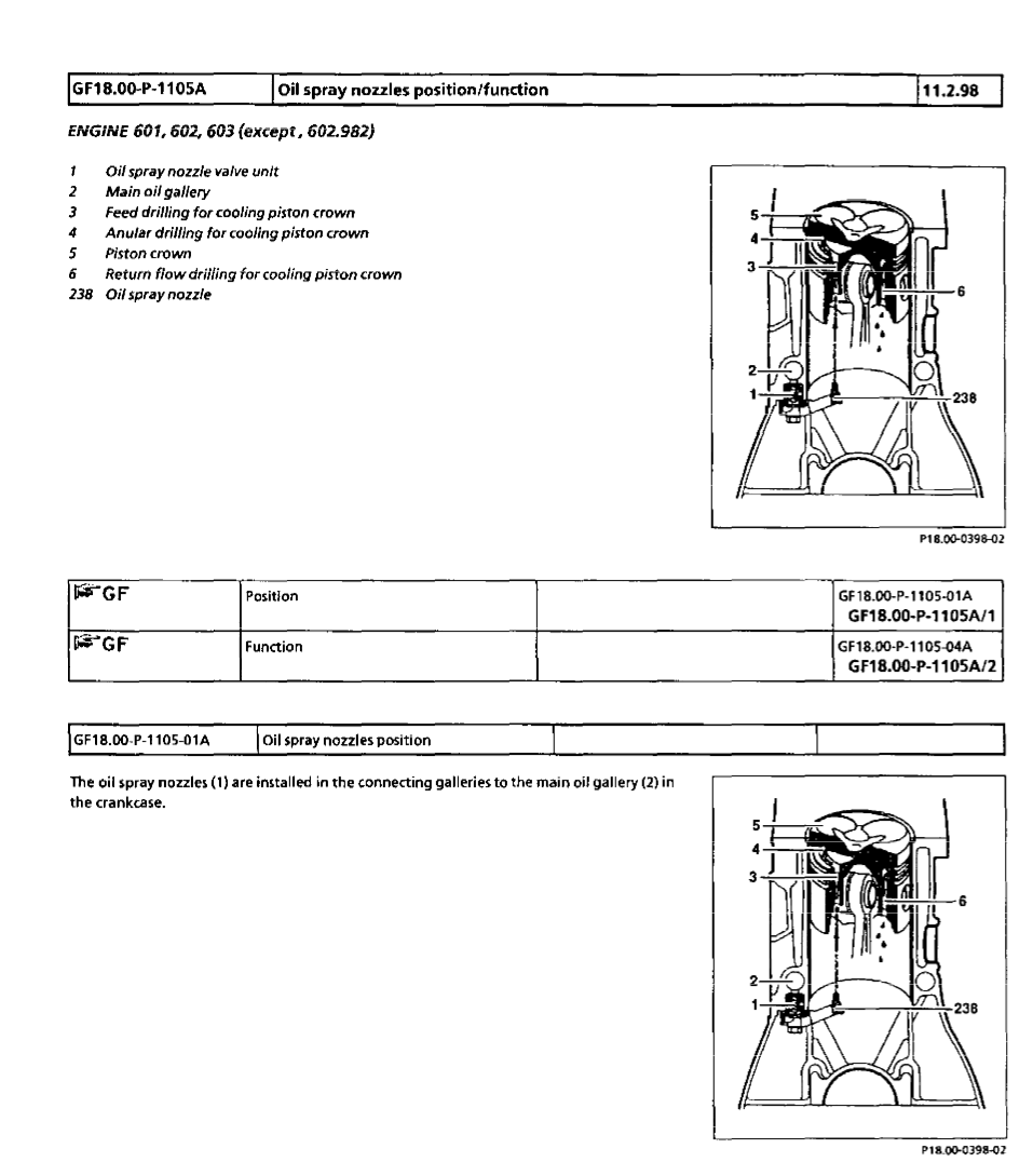

Same for the return , there´s a place in the block to drill. find the flange and drill, is just above the pan.
regards
FD,
