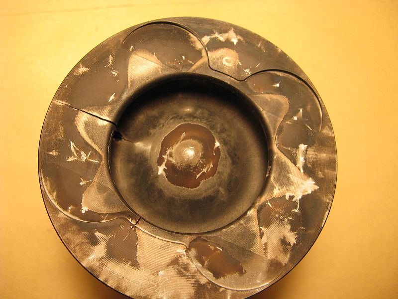

What are the pictures you posted?
I've never had this explained to me.  I've seen advice on a lot of forums that to get more fuel the pop pressure should be increased.  I never thought about the impact that would have on when the injector opens and closes.
Smile

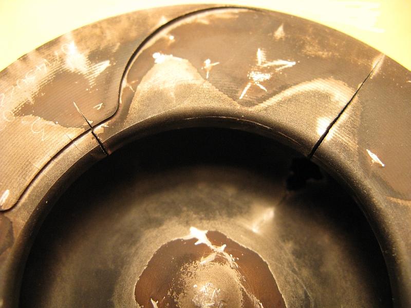

08-30-2015, 06:30 AM #19
(08-27-2015, 04:55 PM)Torkey What are the pictures you posted?
The pictures show a piston from a DI engine  where the injection nozzle had a little malfunction.
I wanted to illustrate that in a DI engine the nozzle is even more crucial than in a prechamber engine.
Due to the malfunction the nozzle did bore a nice hole through the piston and caused it to crack several times.
Gruß
