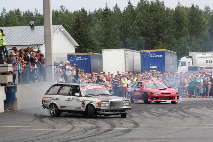

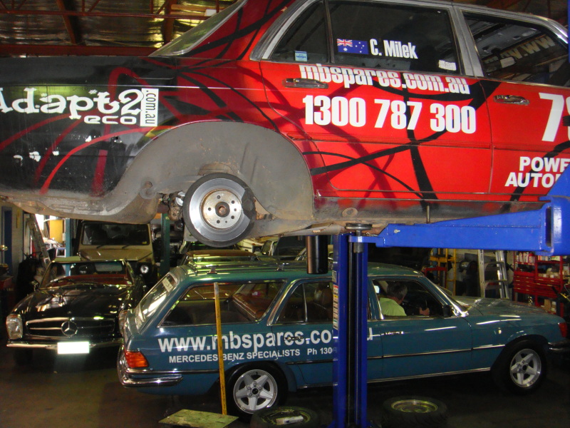

The wagon that has coilovers is the team black smoke racing 300TD. It has RX-8 coilovers installed.

Yes, you are right, the team black smoke racing car has Toyota, gearbox, rearend, and some of the front suspension too(including steering rack).
PPC mag(uk), have just done an article on it, in the latest issue, I was actually quite dissapointed in how little of the original Mercedes was left.
In my sedan build, I'm trying to use as many Mercedes parts as possible, mainly just to challenge myself, but also because I think there is plenty of strong parts across the entire model range to build my car. But I am looking into fitting/making coilovers for my car.
I'll let you know how I get onWink
