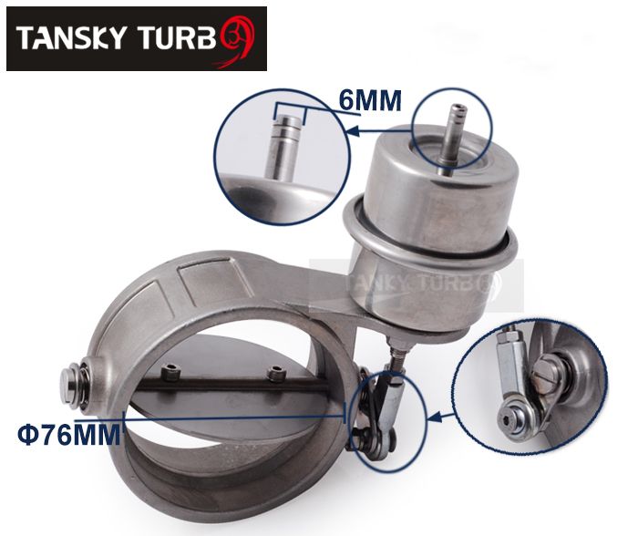

I will be driving om606 compound with 3" vacuum operated cutout controlled by olefejers gearbox controller to open the valve at certain amount of boost and tps. Also will have switch to take it off completely or open it.
Would be nice to see how this genuine chinese made stainless valve works, they don't recommend it to diesel.
[Image: exhaust-control-valve-set-cutout-3-76mm-pipe.jpg]

Thanks for that, I didn't know there was a boost actuated version, that might be really quite useful when connected into the vac/boost lines to open at a certain boost level, although saying that the valve would be open to be able to build boost quicker rather than after boost.

I use 2x 60mm chinese stainless valves like in picture on my 190e 16v turbo.
Only way to get noise lower with straight through pipe.
Vacuum closing valves.
I will try 3" valve on my g wagen with om606. Opens with pressure.
