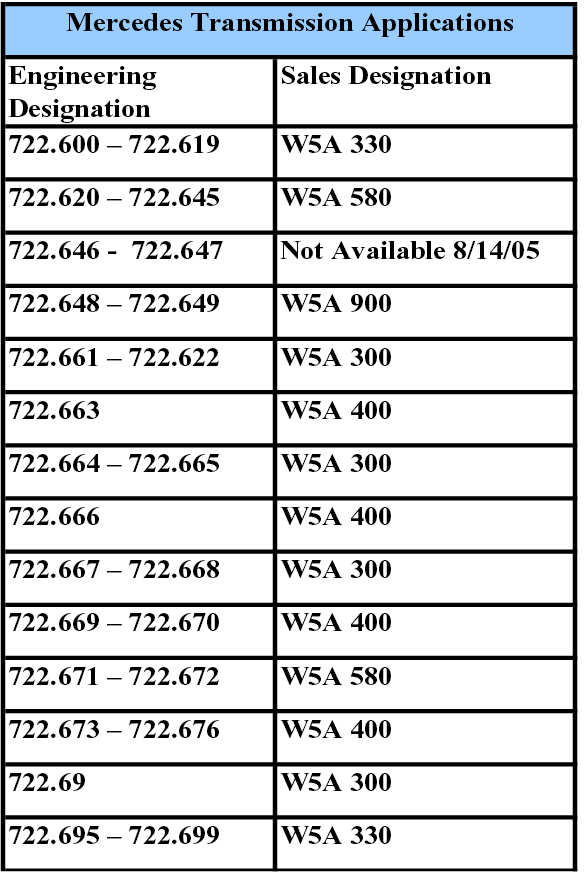

W210/W211/W220 320CDI - same 722.626 W 5 A 580
W220 S65(strongest) - 722.649 W 5 A 900
This post was last modified: 01-11-2016, 01:35 PM by MartinB.

(01-11-2016, 01:31 PM)MartinB W210/W211/W220 320CDI - same 722.626 W 5 A 580
is not the W5A1000 stronger?
Turbo
01-11-2016, 03:10 PM #15
MartinB
OM605 Power
154
01-11-2016, 03:39 PM #16
(01-11-2016, 03:10 PM)Turbo
Yes, sorry. W5A1000-AMG is strongest. I have EPC 2008 - maybe this is the problem.
W210 E200CDI 185kW Manual, W203 C30 CDI AMG 210kW Manual

01-25-2016, 06:43 AM #29
The 722.666 is the beefy one you want to get. I believe it will hold 700+ ft-lb torque. Mercedes used it in the ML-55 and the other performance V8 cars.
This post was last modified: 01-25-2016, 06:44 AM by 50harleyrider.
50harleyrider
JSJFIN
13
01-27-2016, 12:21 AM #30
(01-25-2016, 06:43 AM)50harleyrider The 722.666 is the beefy one you want to get. I believe it will hold 700+ ft-lb torque. Mercedes used it in the ML-55 and the other performance V8 cars.
Nope if you want really beefy one you should get 722.648 or .649:
JSJFIN
