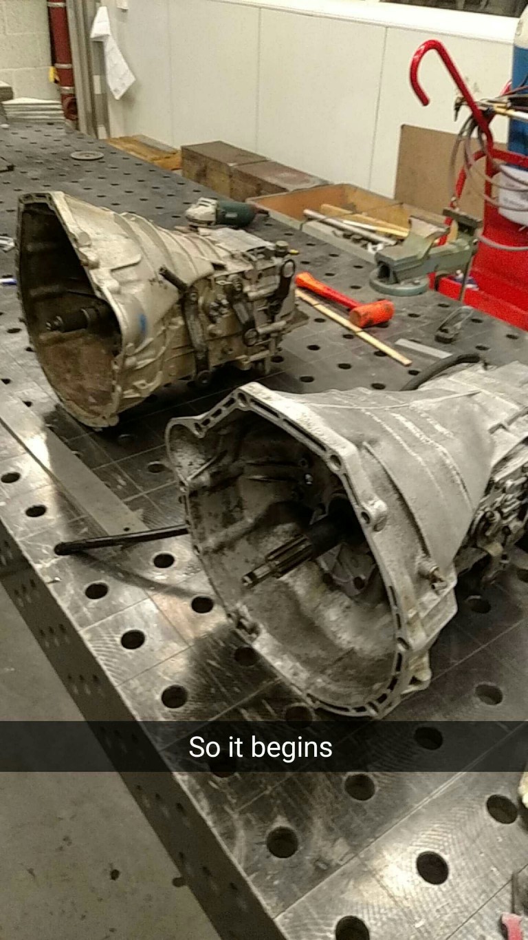

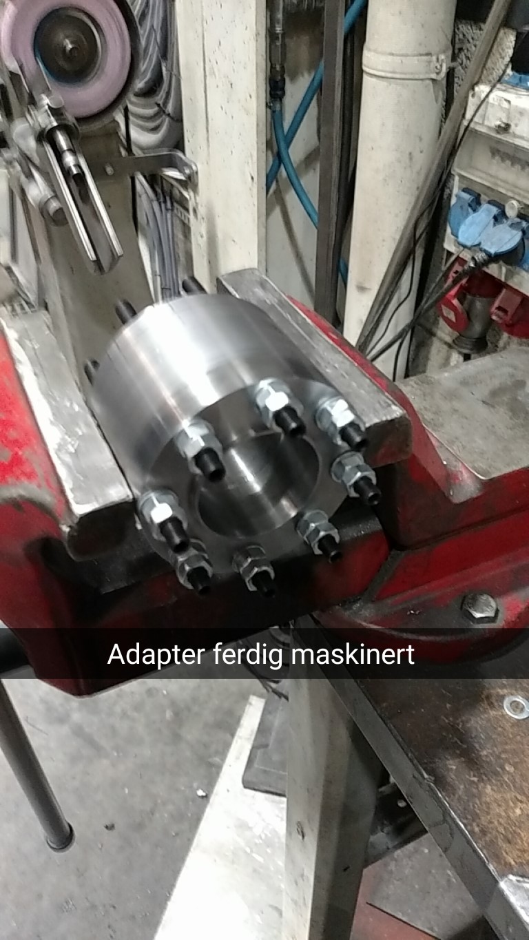

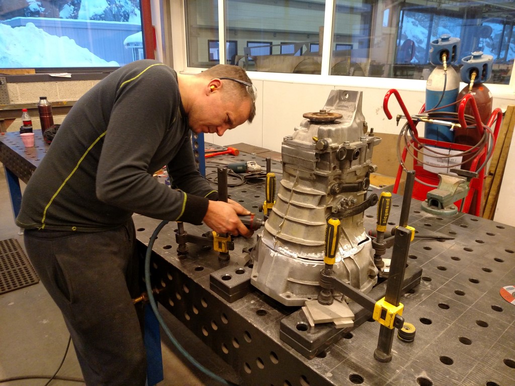

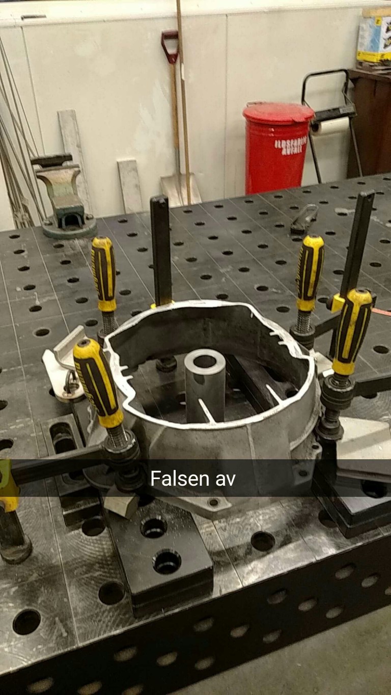

01-26-2016, 08:44 AM #5
then the .443 5spd transmission is paired with the 617a.
cut off the flange from the old gearbox and welded it on the new gearbox..
it was nice job, what took the most time was to make a jig to center the shaft. but with the equipment avaiable it was done within 1/100mm clearances.
new box, old box
jig with centered shaft
old boxs flange cut off, here you can see the machined piece to center the input-shaft to the transmission
welding the two pieces together.
shaft between the transmission and transfer case was 74mm to short, so had to machine a spacer with high tensile strenght bolts to get the correct distance.
regarding the pilot bearing, it was a 15mm end shaft as predicted on both transmissions.
