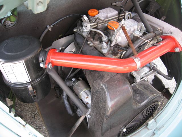

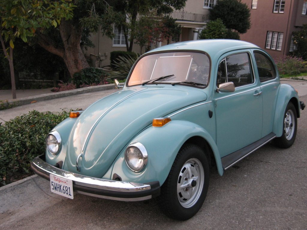

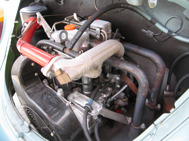

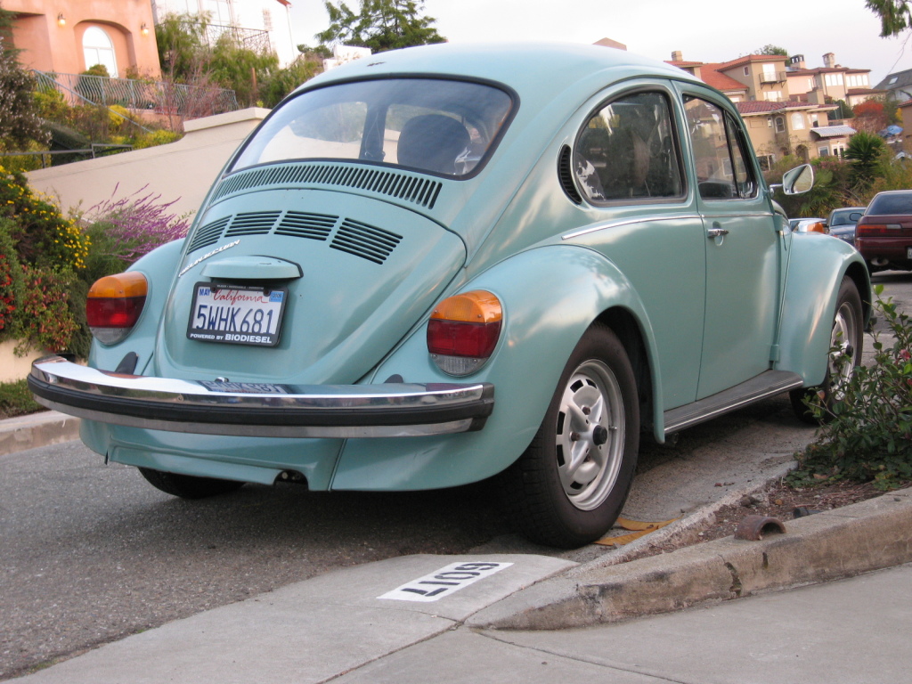

Lombardini 23HP (12 LD 477-2) twin cylinder diesel.

Yeah, somebody's conversion. If I had $2500 I would have seriously considered it since I have family in CA that could pick it up for me. Maybe they will relist it cheaper.
A VNT15 from a TDI would give that 23hp engine a nice boost.

I agree, however, would that "air cooled" engine be able to handle turbocharging? Or would it heat stress it (overheat it)? Huh
Just occurred to me, this must be the "marine" diesel version, that is, it's turning reverse, compared to a non-marine. I recall the SBC VW Bug conversions required a "marine cam" to support the rotation direction the transaxle / engine connection requires.

Nice, simple and super economical conversion i guess, but those air cooled diesels are really noisy when not buildt in to a sound proofed cabinet! I love it!
