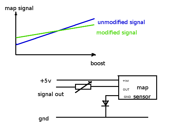

Repetitio
137
01-25-2016, 12:26 PM #18
ok, what i just did was, i closed my wg mechanically, then i drove without evry mod on. The response was much faster than normally with the vakuum actuator. I didn´t rev high because boost rised quickly above 1 bar. Then i turned on the evry, and the response was even faster. I think i´m happy with the response of a closed wastegate. So i´ll go and get myself a pressure actuator, what i wanted to do anyway...So barrote, you where right in that kind that you said, more fuel = faster response. But not with the vacuum actuator.
Repetitio

03-22-2016, 03:37 AM #32
There are two more cheap modifications for quicker spooling you can do if you didn't remap it yet:
Intake Air Temperature sensor: The ecu prevents smoke by reducing fuel at higher intake air temperatures.
Simulate lower temperature to surf a different part on the map by putting a resistor in series to the sensor.
I got a 22kOhm potentiometer, now full turned up, gives a little more fuel across the whole rpm range, you can feel the difference at low rpm.
MAP sensor (boost): To simulate higher boost at low rpm you can compress the signal of the map sensor.
Unmodified signal at idle is about 1.45V.
Put a diode in forward direction between map sensor ground pin and the "real" ground from the wiring loom.
Put a potentiometer (I'm using 10kOhm about 3/4 turned up) in line with the boost signal to get higher maximum boost.
With that mod you get an idle boost signal of about 1.63V, better low rpm response / quicker spool and max boost of about 1.4 to 1.5 bar from the stock gt25c turbo.
I can make a drawing if somebody wants to try this.

03-24-2016, 02:45 PM #33
Whats the purpose of the diode?
A drawing would be appreciated.

03-25-2016, 06:53 AM #34
(03-24-2016, 02:45 PM)ecFSE Whats the purpose of the diode?
The diode has two effects:
It "lifts" the whole signal to give an offset of 0.7V (this is what you want for quicker spool from idle) and,
as a side effect, it reduces the voltage the sensor is given from 5V to 4.3V, so the signal output in relation to sensor ground pin will be a little lower.
Look at the drawing, you will see that I'm not an artist but it should explain the purpose Big Grin
