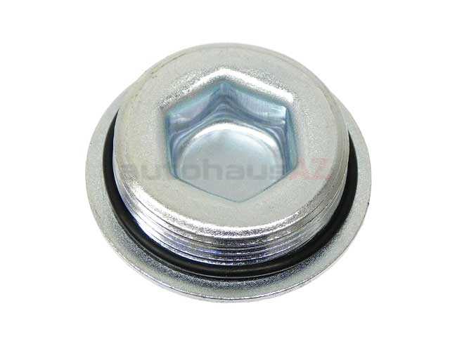

02-10-2016, 01:31 PM #7
Wish I had seen this earlier. No sealant on the threads, the o-ring does the sealing. Part# for the blank plug is FB-1179970230  4$ w/o-ring
[Image: FB-1179970230.jpg]
