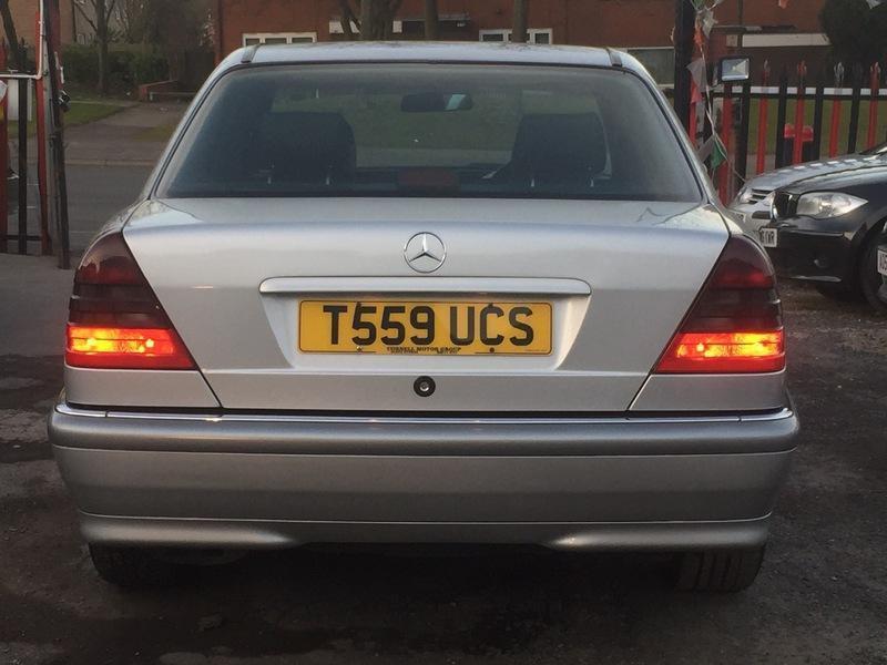

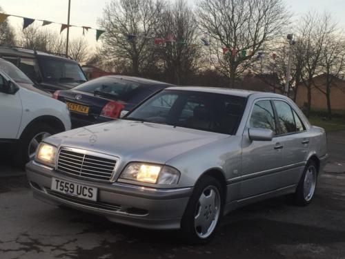

(05-17-2016, 12:02 PM)LewisG95 This is the car I will be modifying anyway
