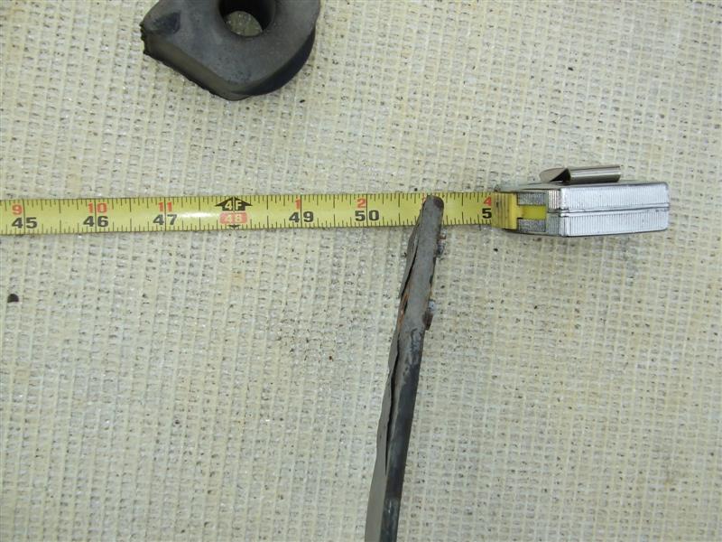

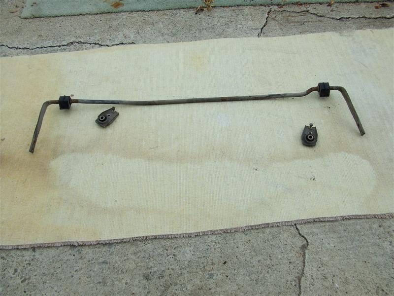

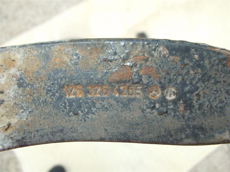

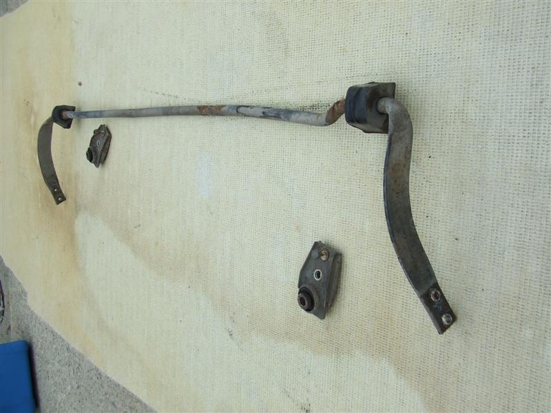

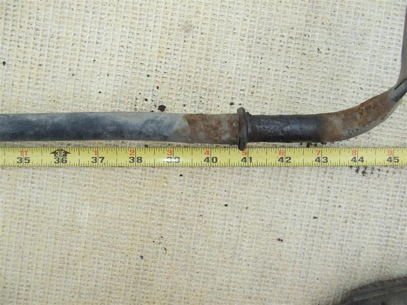

10-10-2009, 04:17 PM #7
(10-02-2009, 06:31 PM)DeliveryValve ...
Is there any objections to narrowing a W126 17mm rear sway bar? ....

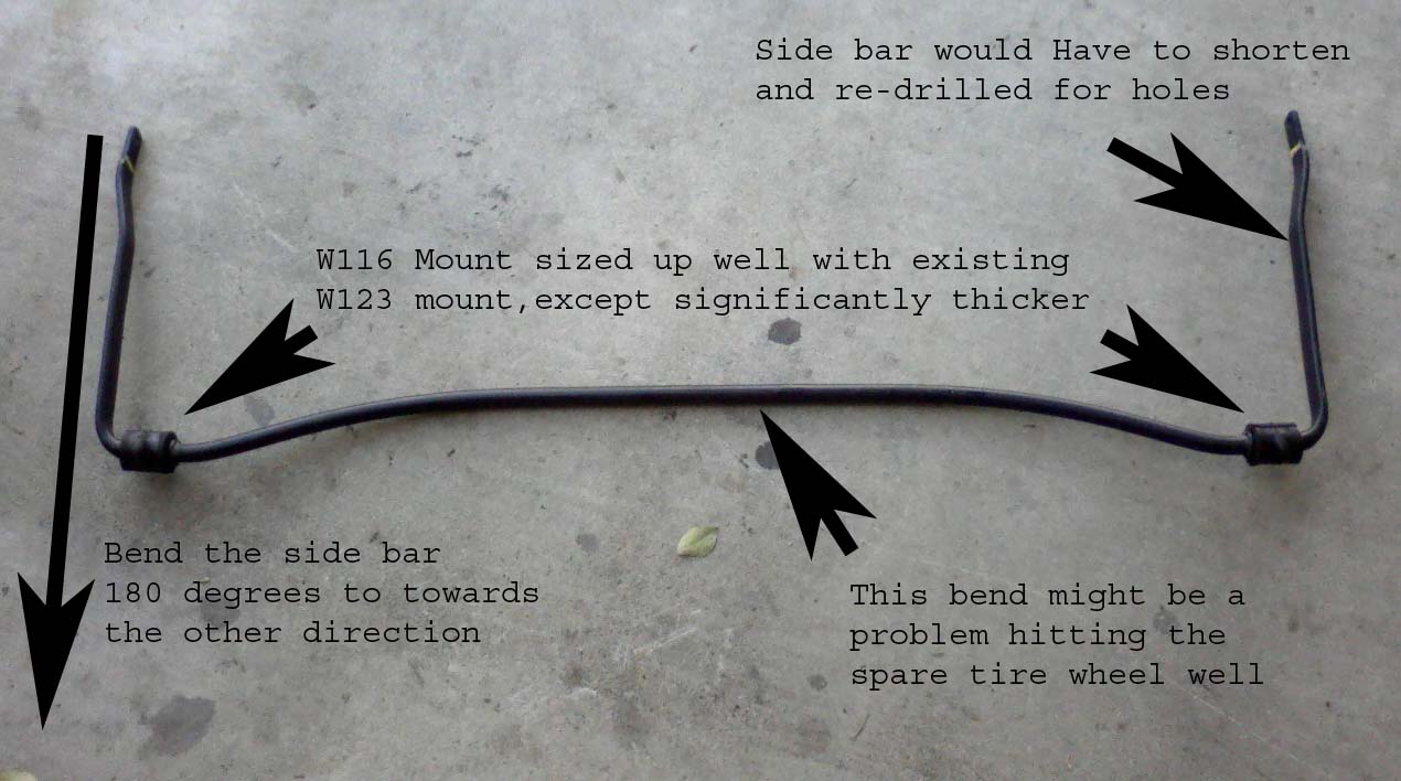

OK, I don't know where I got this notion of a w126 17mm rear swaybar ever existed!
I've been to a couple of PNPs and I am now convinced that the w126 only came with, at my estimate, a 14mm rear sway bar. Not worth the trouble to modify.
I did however find a swaybar that might work with some modifications.
I pulled this rear sway bar from a W116 1974 450SEL. Too bad this car was in the yard, but you Gotta love California cars. This fine example is rust free and clean up looking like it was almost off the assembly line for being 35 years old.
And the great thing about it....... It is a whopping 18.5 mm! Compared to the w123's toothpick diameter 13mm swaybar.
Of course some modifications will have to be done for it to work. Luckily there was a w123 at the yard to compare and size up.
The first thing would be to heat up the side bars and bend them 180 degrees the other direction. The side bars are flat so this should be doable. I have to rearrange this because the w116 swaybar has a bend that will interfere with the differential. Other things to note is the side bars would also have to be shortened and re-drilled for use with the w116 style metal swaybar links. Which by the way is much stronger than the w123's plastic links. The body mounting position is I believe right on with the w123s. The only other problem will be the bend in the center of the bar might hit the spare tire wheel well after doing the side bar mod.
I'll make another thread to discuss this bar after I get around to installing it.

10-10-2009, 05:20 PM #8
BTDT I'll be interested to see if you have diff results. 17mm 126 bars are found on SEC and SLS.

10-10-2009, 07:29 PM #10
(10-10-2009, 05:20 PM)winmutt BTDT I'll be interested to see if you have diff results. 17mm 126 bars are found on SEC and SLS.
Been there done that? You mean with a w116 sway bar?
I was looking at an '83 SEC non SLS and there was just the 14mm sway bar. So I guess the SLS option would have it.

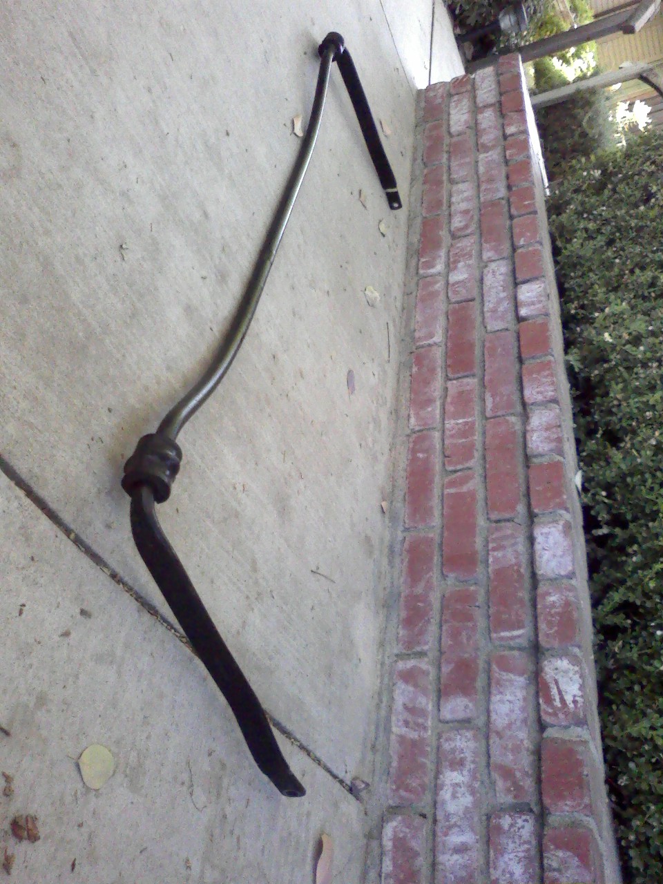

10-11-2009, 08:39 PM #14
(10-11-2009, 08:03 PM)charmalu Well I measured the bar on the 85 500SEl Euro with SLS, and it shows about 17.25mm.
right behind it was another 85 500SEL but U.S. spect. that bar measures 14.25mm.
these two looked like twins, blk on blk.
I now own a larger sway bar. where the W116 is curved, the W126 is straight,
Charlie
Charlie, could you take some pictures of the bar and post them?
The w116 bar measures 45 inches between the two mounting bushings (starting and ending at the welded rings) . I like to know what the 126 bar measures.
This post was last modified: 10-11-2009, 08:45 PM by DeliveryValve.

(10-12-2009, 12:38 AM)Kiwibacon Have you guys approached custom spring makers?
Afterall, a sway bar is just a double ended torsion spring. They should have suitable material and forming gear to custom make them.
No I personally haven't.... I am a cheap mug. I got the w116 bar for 20 bucks. Definitely worth trying to modify.
This post was last modified: 10-12-2009, 09:24 AM by DeliveryValve.
10-12-2009, 09:23 AM #17

10-03-2012, 12:51 PM #32
hop this helps im not to savy with pics and stuff but i went on summit racing and the picture at the top of the sway bars section has a design like i was speaking of. although it looks like the arms are dampened ? any ways , there are a few designs they all look pretty rugged like track bars but this one looks interesting , Currie Enterprises CE9900 - Currie Enterprises Anti-Rock Sway Bar Kits,http://www.summitracing.com/parts/CUR-CE9900/?rtype=10, i dont know if that will work to link there or what not , here is summits part number CUR-CE9900. you can see its a solid rod . it also looks like its not very wide .
lpumb3
