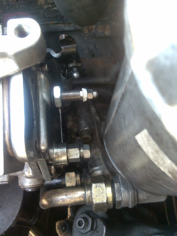

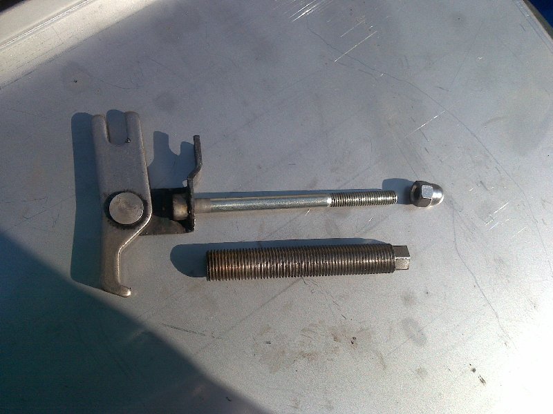

Hi,
MW IP:
the SS-tube is 58mm long, thread M10x1
The SS-screw is 70mm long and has to be welded in instead of the original short screw of the rack limiter.
The M10x1 fixing nut has a little pocket for an o-ring towards the cover.
The cover has a bore (on the correct position)Big Grin
Even the first attempt with a flat silicone gasket towards the cover was not leaking but to be sure I added the o-ring on my second.
Tom

Hi,
MW IP:
Tom

What I want to know is how the hell did you fit the rack limiter back in with that extra length? Cool idea anyway, good job.

10-01-2009, 11:37 PM #5
believe it or not but I installed it with the IP in the car, oil filter housing at its place. Just the top cover of the governor was off. And then you don't have to be in a hurry.
It is similar to the "rack limiter removal" job.
Tom

10-02-2009, 12:36 AM #6
You either have kindergartner hands or jedi skills my friend.
