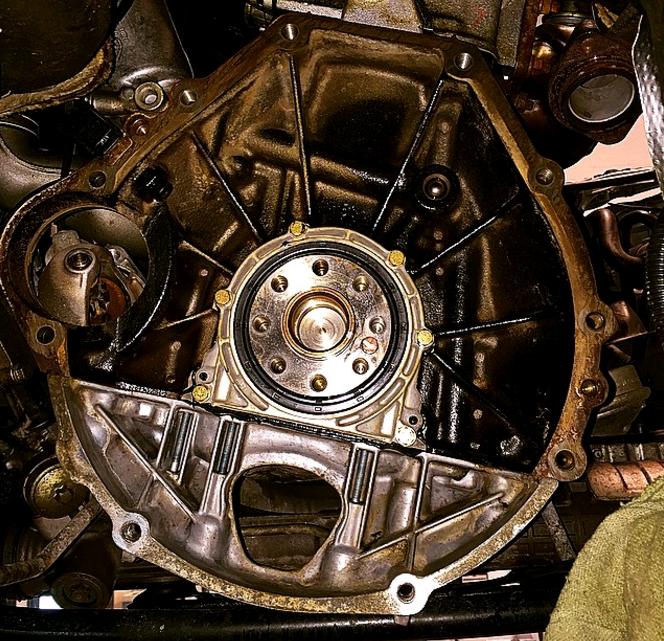

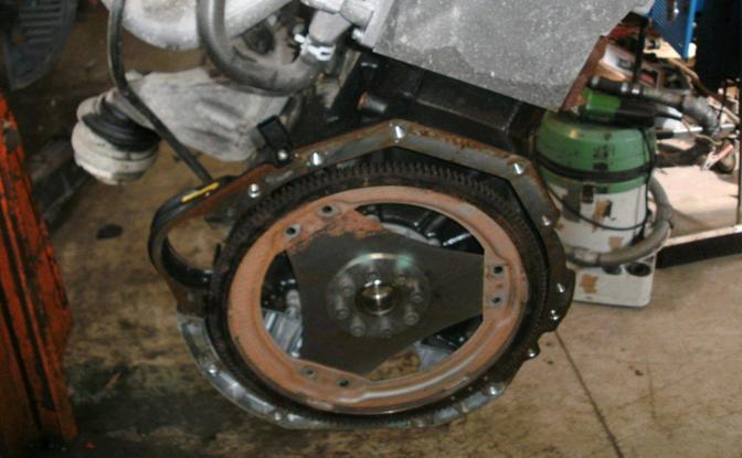

Found some photos of the back of the OM606 and back of the OM648.
Similar-- but not the same!
(top is OM648, bottom is OM606)
