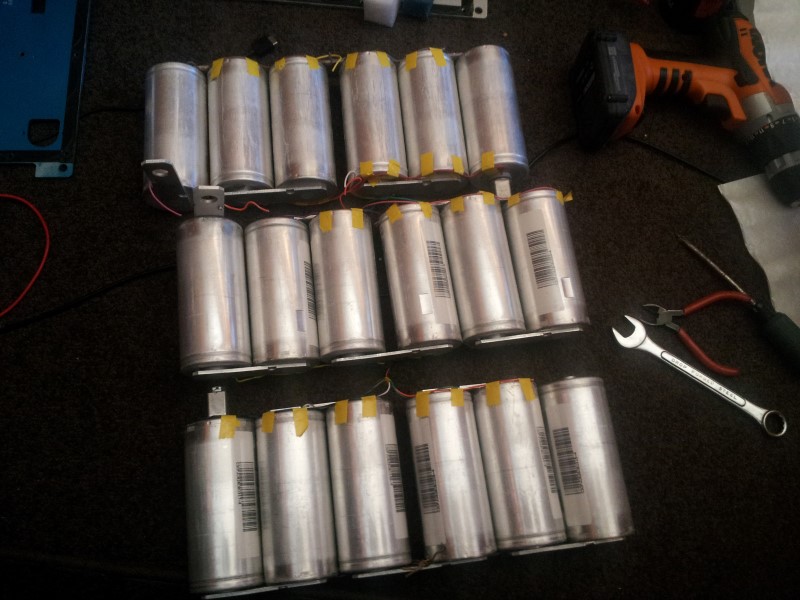

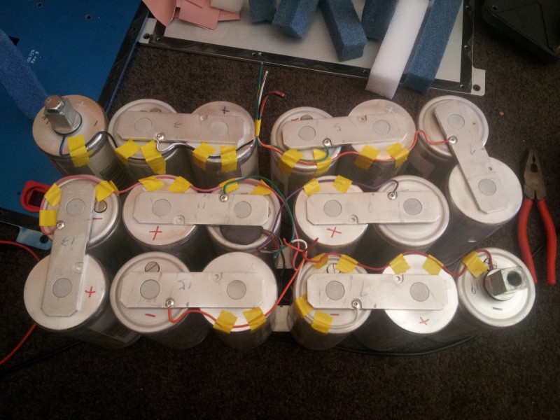

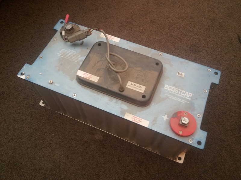

I bought a used Maxwell 48V module from ebay. 18x 2.7V 3000 farad caps. About $800 odd NZD - yup not cheap! Best $/cap though unless you buy a literal bus load (some buses and trams etc are ultracap powered, they charge at each stop). Maxwell make 2.85V ones and 3400F ones now.
Taking it apart

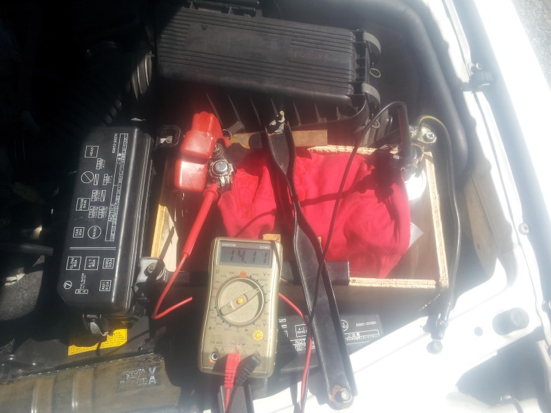

I made a box to put 6 in, 6*2.7 gives 16.2V so fine for a car. I cut the terminal posts off an old battery and bolted them on to the caps. Used it for about a month in my toymota, was rather annoying however as the pack would self discharge below 9V and the starter wouldn't crank. I got a solar panel (being a sunny place here) but never hooked it up.

My dad's vectra had trouble starting recently so gave him the battery out of my '78, being euro and all, it was 480CCA and never had any trouble starting a 617 in winter. The genuine MB 850CCA that I got from the wagon I briefly had is a bit past it to crank but it good enough to keep the ultracaps topped up whiel the car sits on the driveway being worked on.
I have plans to install all 18 caps under the backseat -got the cable etc. 3 strings of 6. 3x500F=1500F. 18,900A short circuit current!!! I have a fuse + safety switch for disconnecting when working on the car wiring....

http://www.maxwell.com/images/documents/...162013.pdf
So about 30lb for the whole module. That's with the case etc, but they're not light
6 of them take up about the same volume as the battery I had in there.
