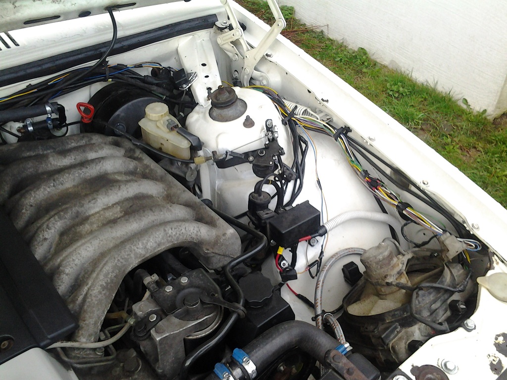

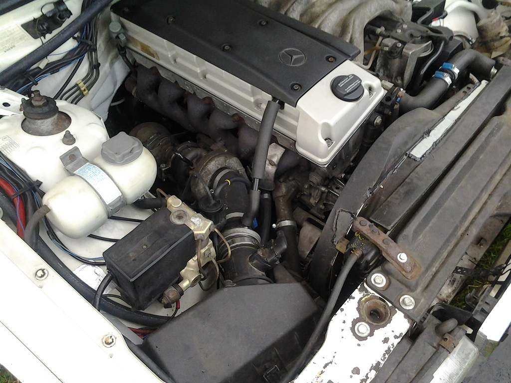

So, I got the thing started on the stand. Today I went to put it in the engine bay. I did. Pulled it out right away. Turns out I will have to trim the sump quite a bit, nevertheless. I hate aluminium sumps, by the way. No pictures today, maybe tomorrow if I start cutting the sump, I took it off this afternoon and I feel deeply frozen right now. Not used to being outside while it's -6*C.

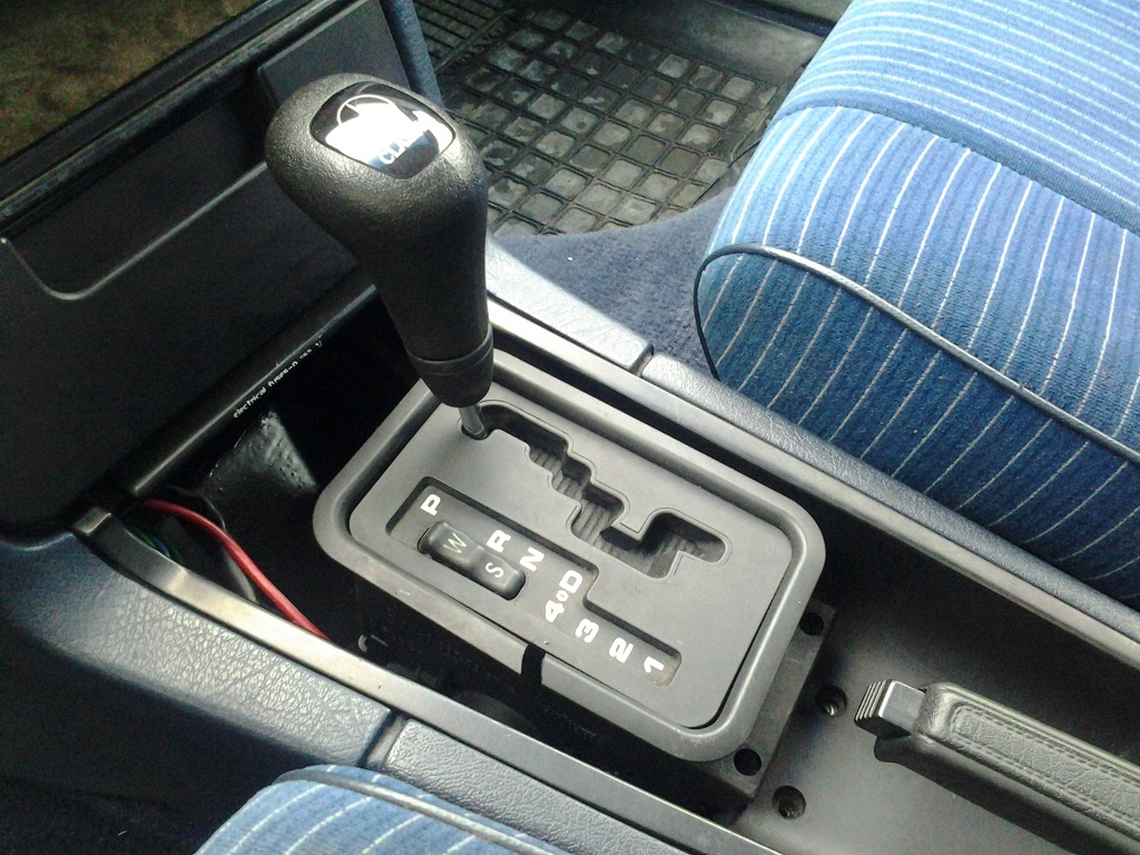

04-12-2017, 02:33 PM #27
A few pictures from my car.
Shifter will get a cover as the oem e300.
No pictures of the pan, maybe soon.
Engine oil cooler coming soon and also a big fat intercooler.
I have the stock volvo intank pump (b230e low pressure pump) that I plan to use when in boost.
It gives low but positive pressure hopefully enough to prevent cavitation in the fuel lines.
When going high power its just a matter of putting a 044 or similar where the stock HP pump was.
/fredde
