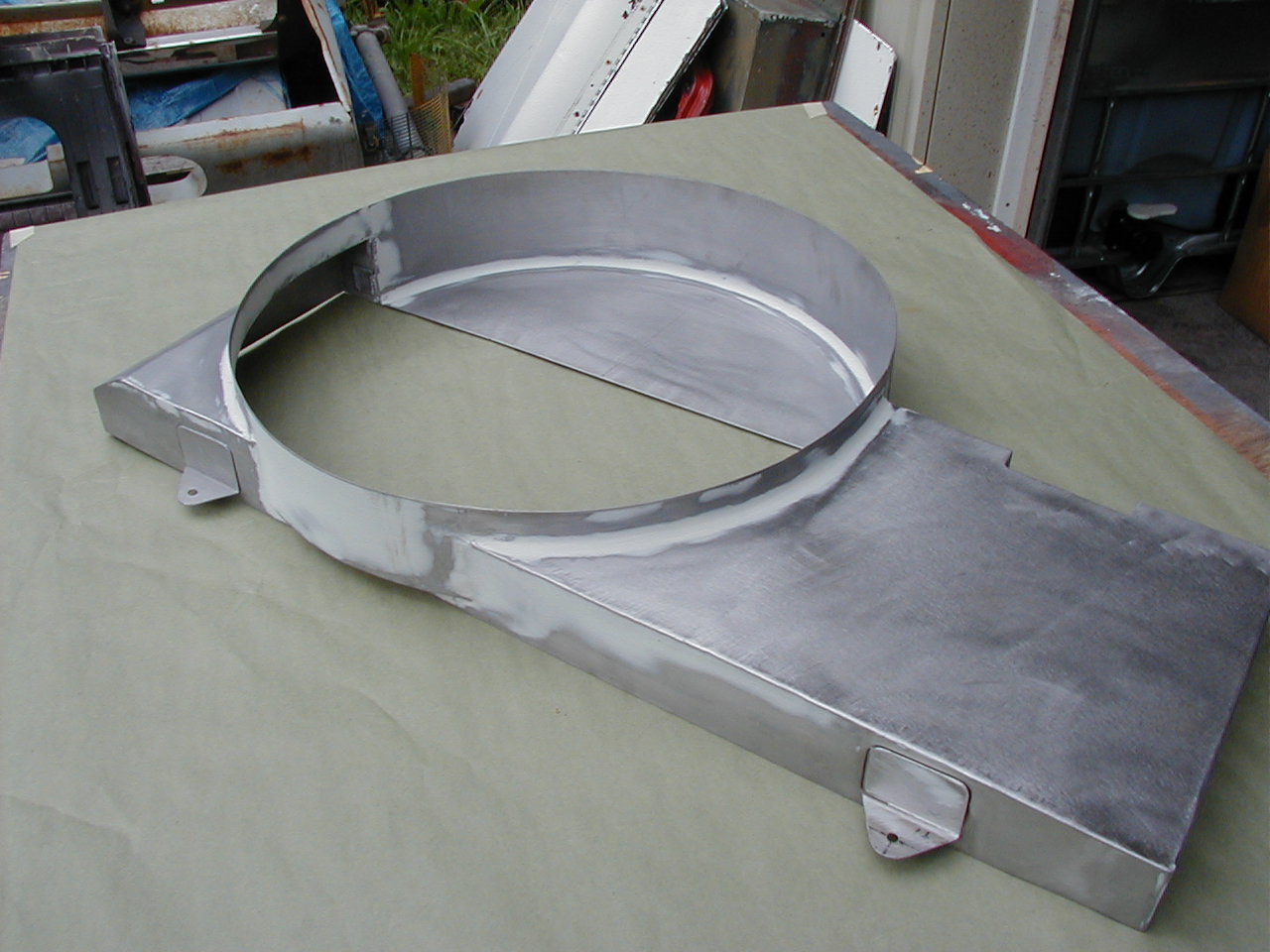

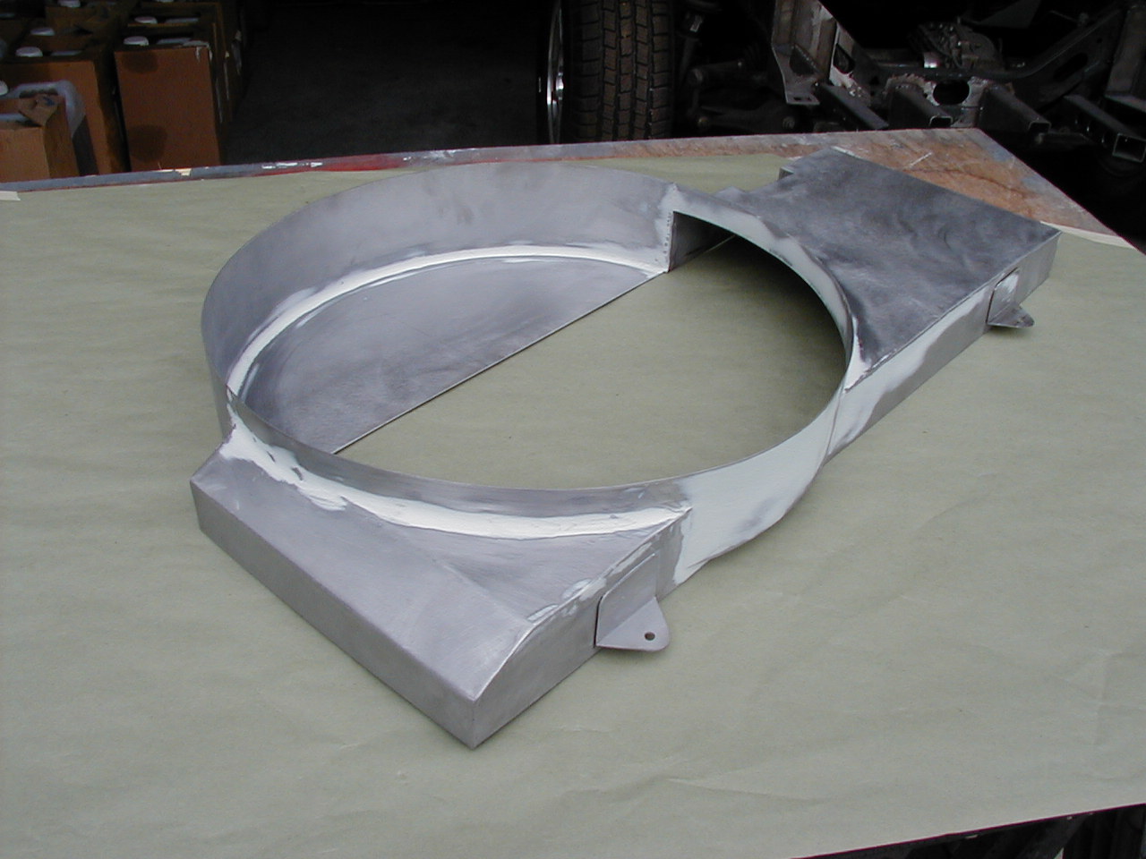

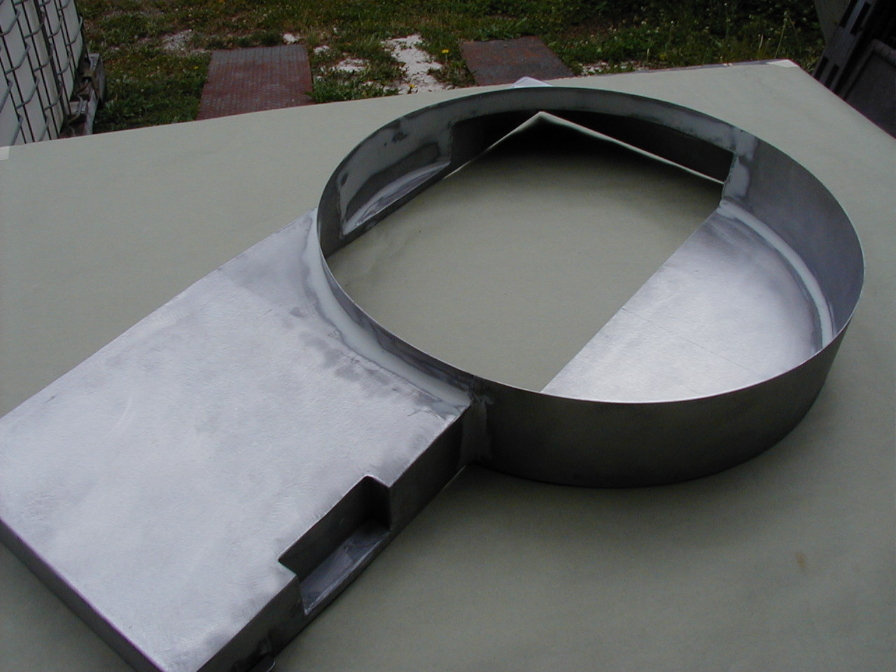

(09-28-2016, 05:43 AM)50harleyrider My W210 had an electric and a full time belt driven fan. I will be using only an electric fan(s) on my F150 conversion and I wanted to know if there is enough sensor on the engine to control the fan. I'm afraid the original ecu did the  control based on temperature input from the sensor and also a trip from ac compressor. Anyone know the details? Will I have to use a stand alone thermostadt?
I would not eliminate the engine driven fan. On my conversions I build a custom fan shroud to use the engine fan with what ever radiator is in the vehicle. I have never had a cooling problem with this setup. You can't pull the same amount of air with electric fans.
The engine fan usually pulls air from the whole radiator core, were as the electric fans usually push or pull air from a smaller area.
The electric fans on the E-300 car are mainly for when the A/C comes on or on extremely hot days. Mainly due to the narrow grill air intake.
This one is for a Jeep Cherokee XJ with a OM 606, it has a narrow radiator but you get the idea.
