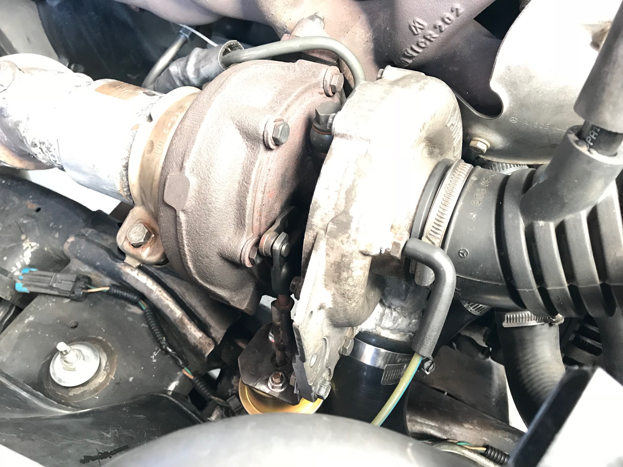

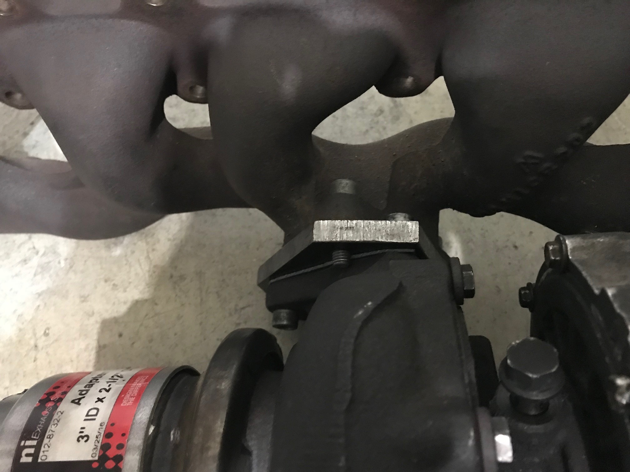

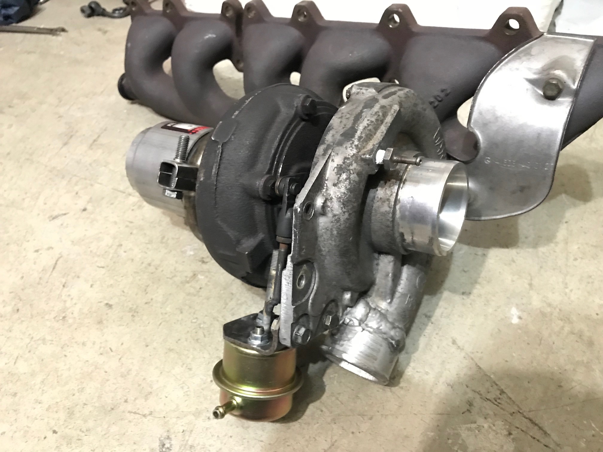

I hope it's ok to post these pics here...of the GT23V (VNT) I installed on my 2002 Silverado with OM606 and 6mm mechanical pump. So I had struggled to unleash some power out of the motor. Tried several small turbos looking for quick spool, and finally this VNT turbo managed to deliver what I was looking for. To avoid spending/wasting more money, I took the cheapest possible approach: I cut a piece of 10mm mild steel, drilled some holes for some studs, and cut out the scroll hole (jigsaw) as centered as possible with the stock 606 manifold. I cut some gaskets from gasket material I got from ebay. The flange worked pretty good, no leaks. I also adapted a boost controller and cut the compressor housing tip. Anyway, here are a couple quick pics.
SilveradOM606
06-04-2018, 02:50 PM #18

My appologies for having posted the previous pictures here. The owner of the subject T100 asked me for those pics and I inadvertently put then on this post which is not his original.
SilveradOM606
06-04-2018, 08:58 PM #19
