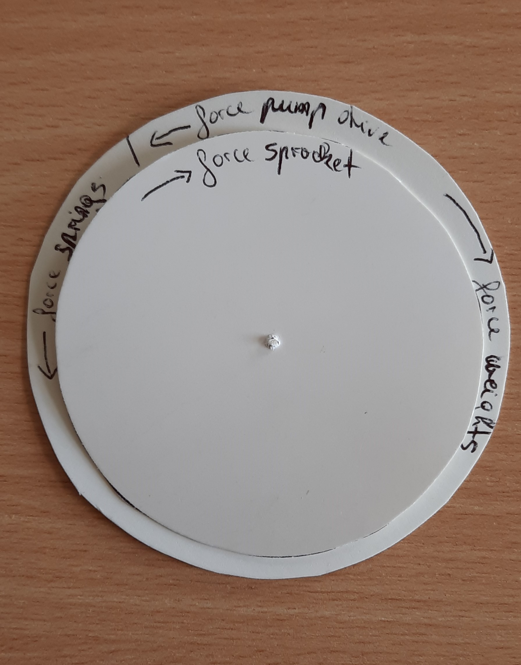

05-25-2023, 02:34 AM #13
My OM605 with 7.7 Elements does have the same symptomps. Good idle with no/ just a bit nailing. Nailing above idle till approx. 2500rpm.
 I try to summarize the chat and my thoughts.
-stiffer springs will advance timing later
-lighter weights will advance timing later
I am unsure about the following theory:
Because of bigger elements the device advance later
what do you think?
In this case the springs should be softer.
Kind Regards
mischa56
what do you think?
Kind Regards
