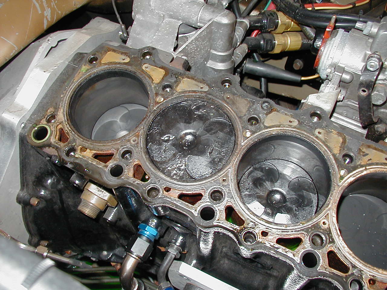

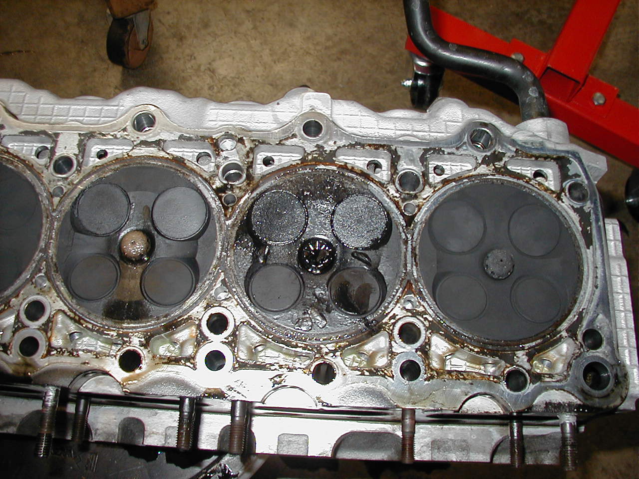

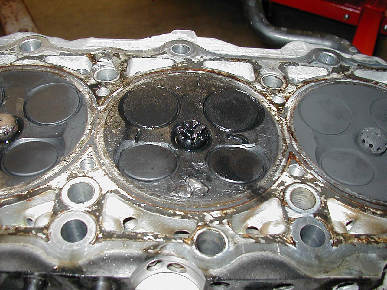

First run of a used engine in my latest conversion. Engine was noisy, sounded like a piston knock. Then it started missing.
Ran a compression check, number 5 had hardly any compression. Pulled head off and this is what I found, the prechamber had failed. Anyone have an idea what caused this?

I believe faulty nozzles do things like that...was a debate about that though somewhere
(by faulty I mean poor spray pattern/leaks below pop pressure)

Mercedes Benz  Says, caused by a drippy injector.

I'm no expert but #4 seems wetter than 6 or 3 as well?

(11-27-2018, 03:09 AM)zeeman First run of a used engine in my latest conversion. Engine was noisy, sounded like a piston knock. Then it started missing.
yes it is liquid fuel dripping onto the prechamber when the prechamber is glowing. Those prechamber tips get extremely hot and they cannot handle the rapid cooling. So if the injector starts to leak, the tip eventually falls off the prechamber and dances around inside the cylinder, which doesn't have any room for that sort of thing.

(11-29-2018, 08:03 AM)jav1 I'm no expert but #4 seems wetter than 6 or 3 as well?
#4 also had some wall scoring from debris. It looks like a set of new pistons an boring. Yeah.

Just talked to Luke at DieselpumpUK and he agrees to the fuel dripping. Also said if the timing is too advanced will cause the problem also. Agreed that pulling pre-chambers out and inspecting for cracks was a wise idea.

The object was to buy low mile used engines, (under 150,000) so not have to rebuild them at and added cost. The usual checks, compression test, rebuild injectors, rebuild I.P pump and checking the bottom bearings while the pan is off should be sufficient.
This is another issue that needs to be addressed. The prechambers should be removed and checked and replaced if necessary. For the most part rebuilding a low mile engine is a waste of time and money. These engines hold up well normally and do not require them to be rebuilt unless they have excess miles.

Just got a set of NPR pistons from Germany, and took the block over to the machinest yesterday. I had to make a tool to get the piston cooling nozzles out so it could be bored.
Make sure you check the bore taper, even though there is still crosshatch in the bore the wear is at the top of the cylinder.
The ball on the tube in the prechamber can break off to and fit through the prechamber. Another failure of the prechamber. Make sure you check inside of all the prechambers.
