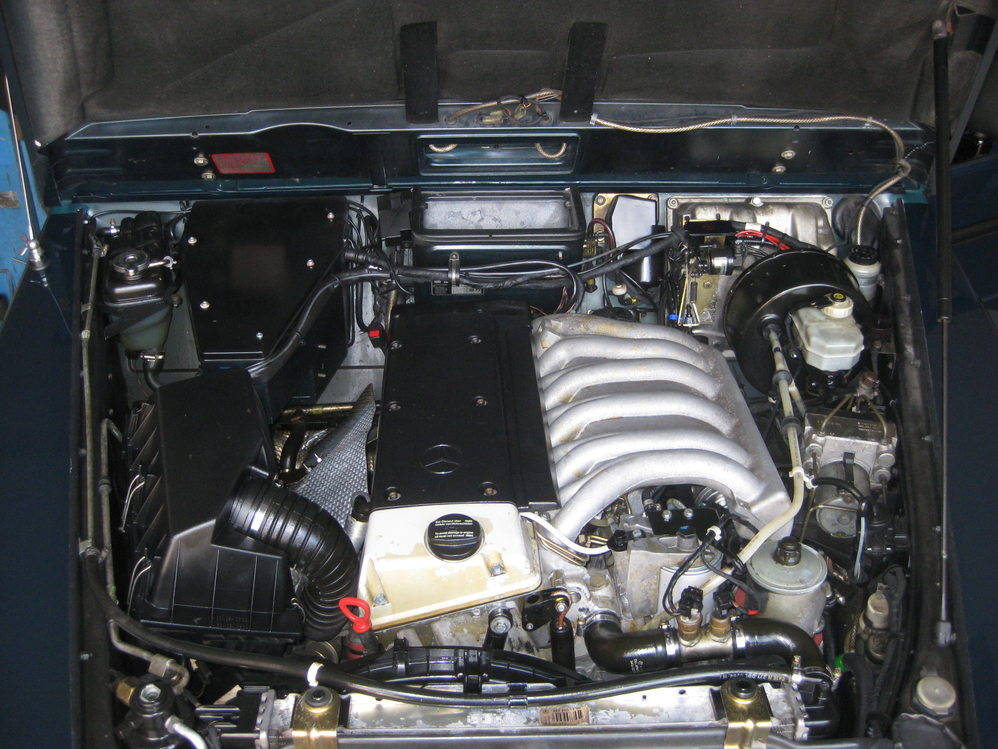

Hello to all common rail specialists here. I need your mind.
I have rebuilt a G Wagon with a 270cdi engine and 722.6 gearbox. Frame and body are now finished. The vehicle should become a daily driver with whom I can also pull trailers. Can smoke black but should not produce a solar eclipse!
Start is an Om612 with original 150 hp with 1.2 bar boost pressure GT2256v turbo and original air water intercooler.
My goal is to get over 200 horsepower (that would have to be about 260 HP on the engine) and a torque of about 500NM that starts in very low engine speeds.
I've already thought a few things about:
1. A Turbocharger with milled compressor wheel. but what?
them original GT2256V or GT2359v I have both but what should I do that gives me a good torque band and still promotes enough air at high engine speeds.
2. Intercooling on air-air with a largest possible cooler I get in the front. (Measurements at 10 degrees outside temperature have shown that
Charge air temperature after 10 seconds full load increases to about 60 degrees and even further - I think that is not optimal).
3rd EGR is closed and the swirl flaps I want to disassemble and close.
4. Change the charge pressure sensor to a 4 bar sensor to avoid any problems with pressure peaks.
5. The topic with the cp3 pump and the injectors does not want to tackle, because I want to test first how much I get out with sofwaremod turbo and intercooler --- or will it not be enough with the modifications.
I hope there are more that have something about the head broke and maybe already built something
I am open to suggestions that have already been tested and grateful

Thank you for your answer. I have already taken that into account and built a gearbox of a 400cdi (V8) with a reinforced torque converter. bell housing rebuilt and hole drilled for the rear rotary sensor. I think that can stand it.
but I would like to know how to get there without injectors and CP3, if at all?

I have already built a W463 with om 606 in the past and with Ole contoler he was also quite funny but that is not a daily driver. ninimum 16 liters on om 606 and trailer 20 liters, but it was fun !!
Furthermore, I have a en Bus W602 4x4 where an Om605 Superturbo comes in.
I have now come across the Comon rail because the torque is easier to generate from below. I drive with the vehicle about 40000 km a year so that's already in the weight.
And yes it is time that you get old engines from junkyard 612 dispensers cost with gear about 800 euros. So can ever go up a motor and it does not hurt so much in the purse.
On the subject of C30 AMG first are the so rare here in Europe that you can get donations 1000km far to 4000Euro then you have to rebuild the whole engine and what can the standart engine ???? Crankshaft camshafts Injectors Pump and intercooler ECU is different but at these prices.
Many are already starting to build 613 engines and I think that's good (he would also like to do it just because he does not fit into the vehicle)
There must be people who have already worked on the 612.

Matthias4x4, that looks exactly like a factory OM606 setup (W463.33x). I have one.
What G did you start with? It must have been a 1997+ I6 engine.
