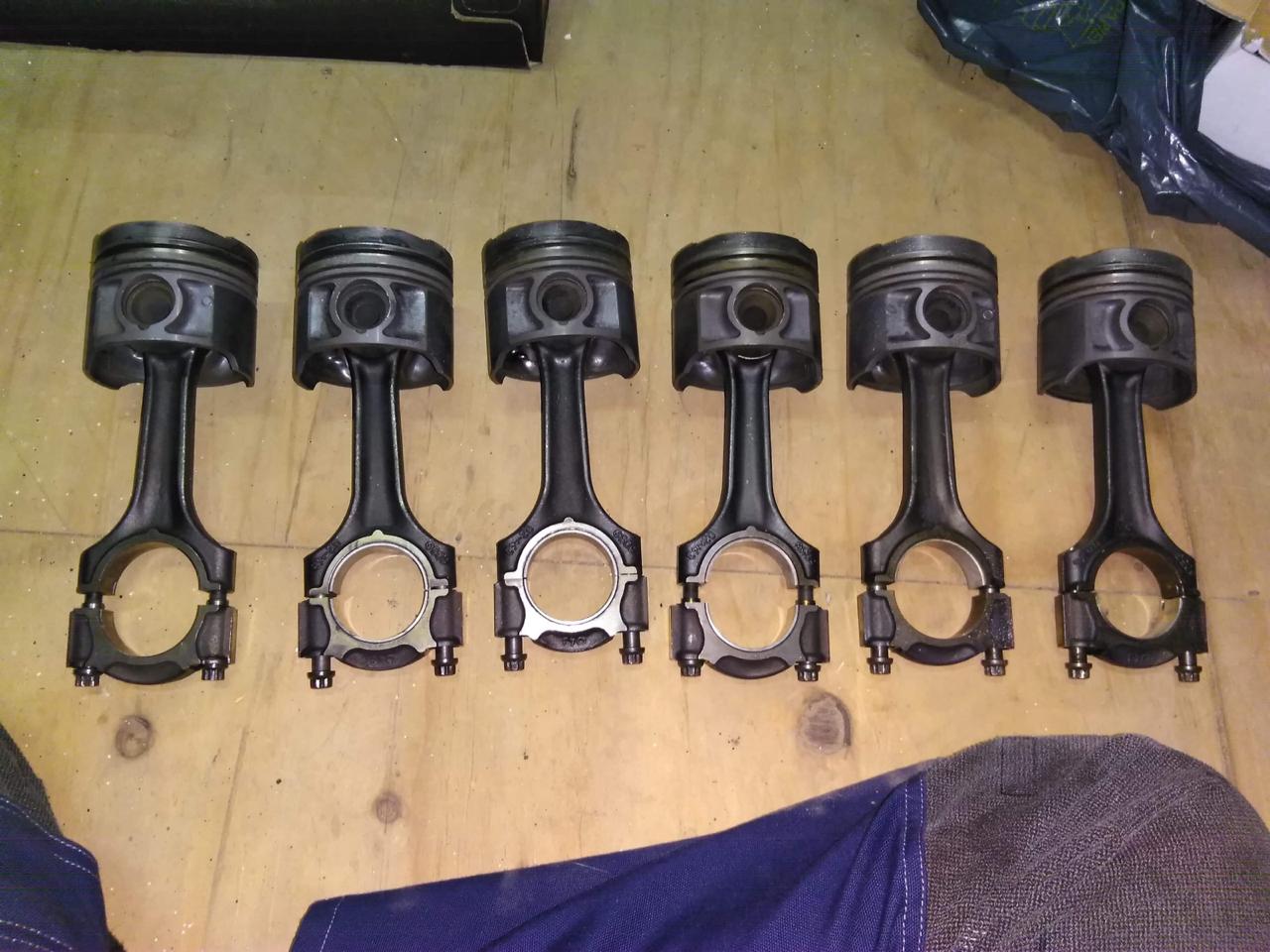

Hi guys.
So I have w124 e300d(N/A om606) and soon I will be superturboing it so I am planning to replace the pistons and rods from turbo engine(its difficult to find and/or import complete turbo engine in my country so have to do this way) & I am actually getting the pistons and rods at fairly good price.
The seller says the rods are fine and not bent and pistons are good too except for the fact that some pistons have slight skirt marks
but says nothing that I should be worried of.
But before I confirm the deal, do you guys think these are ok both pistons and rods(as per pics).
Thanks

They look fine. The cast of the NA engine block is said to be weaker than the turbo version. Why not put H-beam rods in your NA block?

So recieved the package today
[Image: YLQjZJO.jpg]

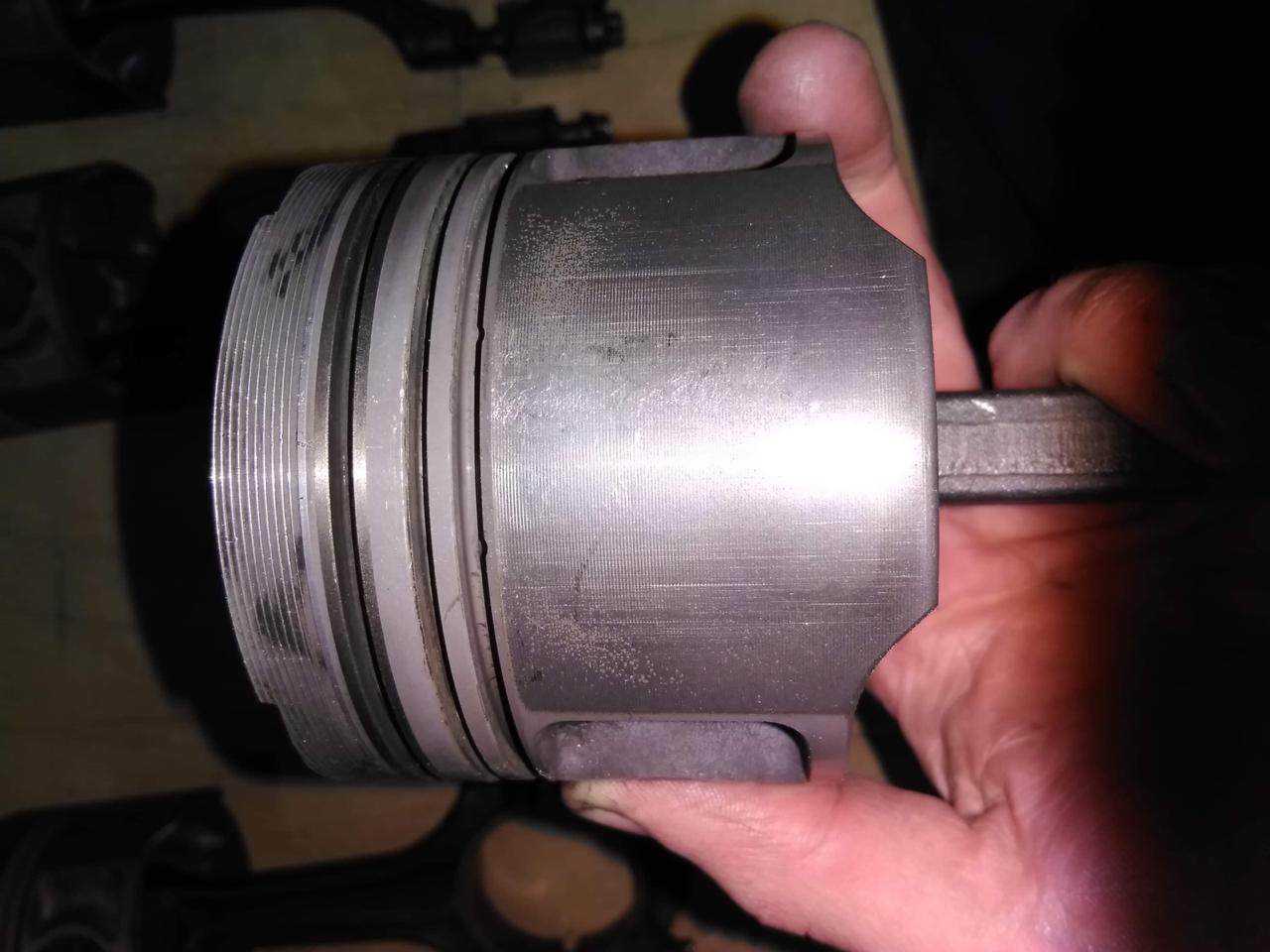

All looked good except the three pistons had the chip shall I say
First
[Image: V3vTQ0w.jpg]
The most severe.
Second one
[Image: jQzFXK1.jpg]
Third one
[Image: fSM0AER.jpg]
Rest three were flawless.
Do you think these are ok to work?

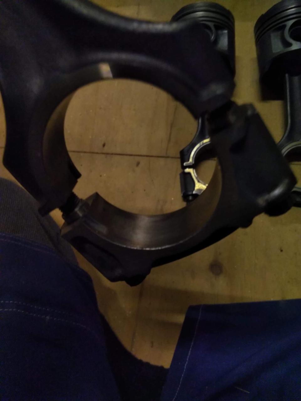

Rods marked as 605.
[Image: Hn2bUID.jpg]
Guess there was a thread about it that 606 rods has 605 printed. Basically the same?
Now close up of rods
[Image: 27DRI38.jpg]
[Image: zDO2zWl.jpg]
[Image: SrcdBPZ.jpg]
