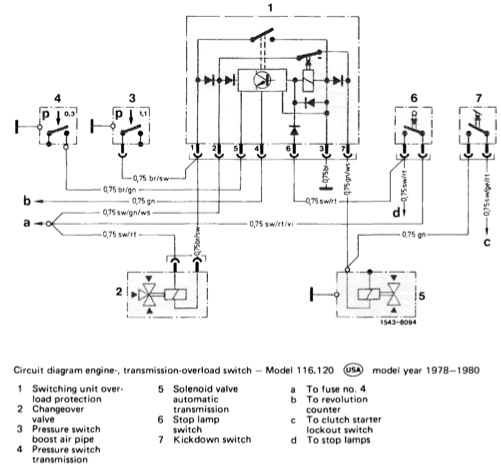

(11-10-2009, 11:29 AM)W116Lorinser for a 4000 pound car the only thing i dont like is how slow the turbo spools up and the lack of power the car has on take off if i have it in the D position.
Unfortunately, the W116's 722.1 transmission can't handle the increased torque of a faster spooling turbo. It has an overload protection system built-in (see attachments).
Get everything up to spec; valve adjustment, clean the ALDA hose, disable the EGR (1980+), use synthetic oils and maybe adjust the ALDA.
Another option is to update to the later 722.3 transmission, it has no problem handling everything the stock injection pump can throw at it.
