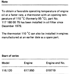

11-11-2009, 03:21 PM #7
Thats why MB changed the oil cooler thermostat from 95*c to 110*c, boil off moisture in the oil.
