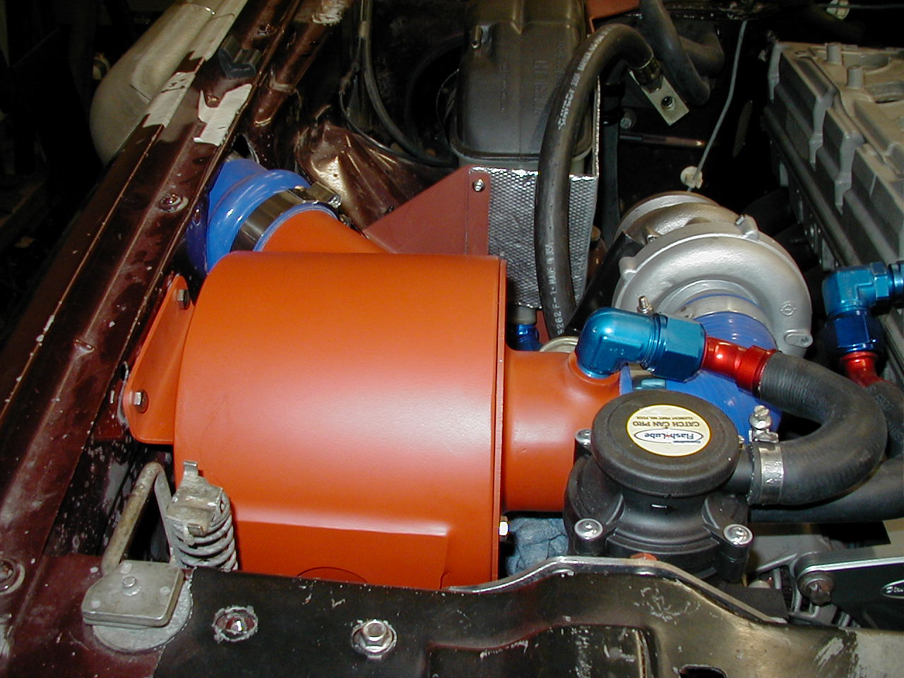

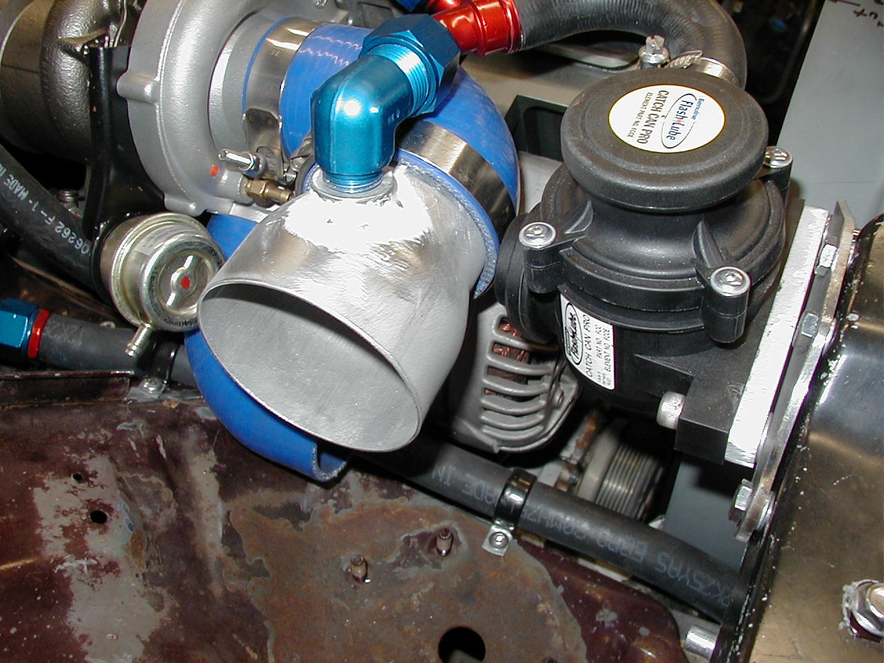

(03-06-2021, 04:45 PM)50harleyrider Is this just something I should live with as long as there is little oil consumption? I suspect either too much pressure in the turbo oil supply, or blowby. I have retained the oe w210 breather tube which dumps into the turbo compressor inlet. I don't particularly like that and thought maybe dump the blowby into a high end Provent or equal separator. Any thoughts or suggestions? I do have a short 3/4" drain from the turbo so backup shouldn't be a problem. I also thought maybe the recent rebuilt by Dutch Auto om648 Garrett turbo I'm now running requires less oil then the 606 oe KKK. The shaft has no play so I know bearings aren't the issue. All the clamps on the boost piping are leaking oil and are tight.
This is the vapor recovery system I use on my conversions. Flashlube Catch Can Pro. It is made in Germany and is marketed from Australia. I get mine from a distributer in Fresno Calif.
They have a video of how the system works, very informative, there is more to this then just the oil vapor.
zeeman
03-12-2021, 01:18 PM #17

(03-16-2021, 09:38 AM)50harleyrider Thanks for all the input guys. I see this is a common issue for these engines. I am mailnly concerned with the oil hitting my precious compressor blades. I plan to dump the breather vent into the ground via a hose for awhile and see what affect it has before I install a separator or a supply restrictor in the turbo oil feed line.
beautiful craftmanship as always zeeman and I did go back to the 6BT MM's.
You might review the video and info on Flashlube, there is a lot more to the function of the vapor trap for engine life.
