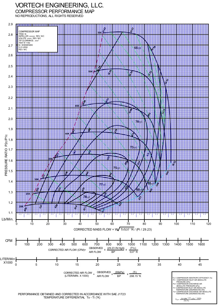

The V3 is also very large. A 617 consumes 25-35Lb/Min of air on the top end with ~20psi of boost, the V-3 can push over 70 at it's peak pressure. A GT4202 with its 102mm compressor wheel would have less surge! As the high-flow low-pressure (~10psi max) in a compound, it would still be right on the surge line the entire rev range.
In any case, it would be very underutilized on a 617 (less than 1/3 of its potential). If you want a Vortech, the V-5 and V-9 look really good for a primary on a 3.0L diesel.

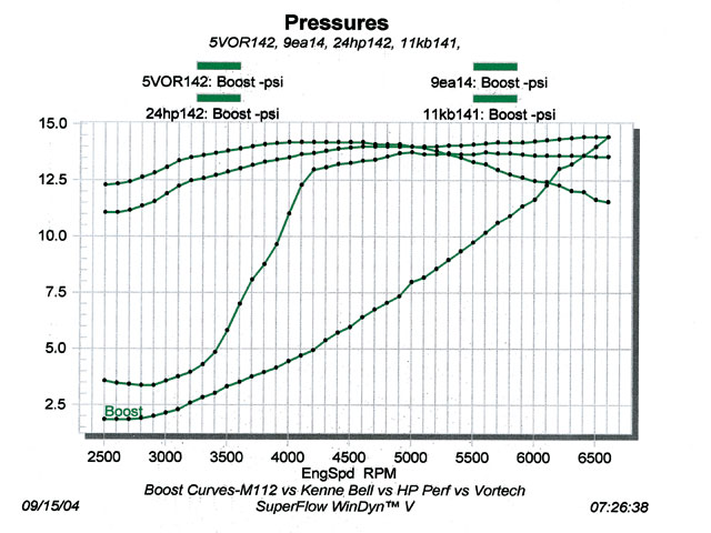

(12-05-2009, 12:39 PM)Nick So I'd want to look for a screw type supercharger?
Yes, screw and roots blowers are positive displacement. They move a known fixed volume of air per revolution. Boost is instant and consistent across the rpm range, changing a little as efficiency changes.
The two top lines are twin screw and eaton superchargers. The one that ramps up at 3500 is the turbo. The linear line is the Centrifugal Supercharger.
Quote:My big goal here is more torque in the low end and if possible a little more cruising efficiency. I drive 70+ miles a day to and from school/work, so this has to be a commuter car too..
A VNT would definitely do that, but a screw or roots blower would do it even quicker. A centrifugal supercharger would be a huge downgrade over even a conventional turbo since it will never see maximum boost until maximum rpm.
Centrifugal superchargers are more for the "I want more power, cheap" crowd with naturally aspirated engines. Thats what the V3 is for, somebody with a 305+ V8 that wants a quick power boost for less work and cost than turbo(s).
