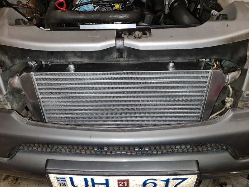

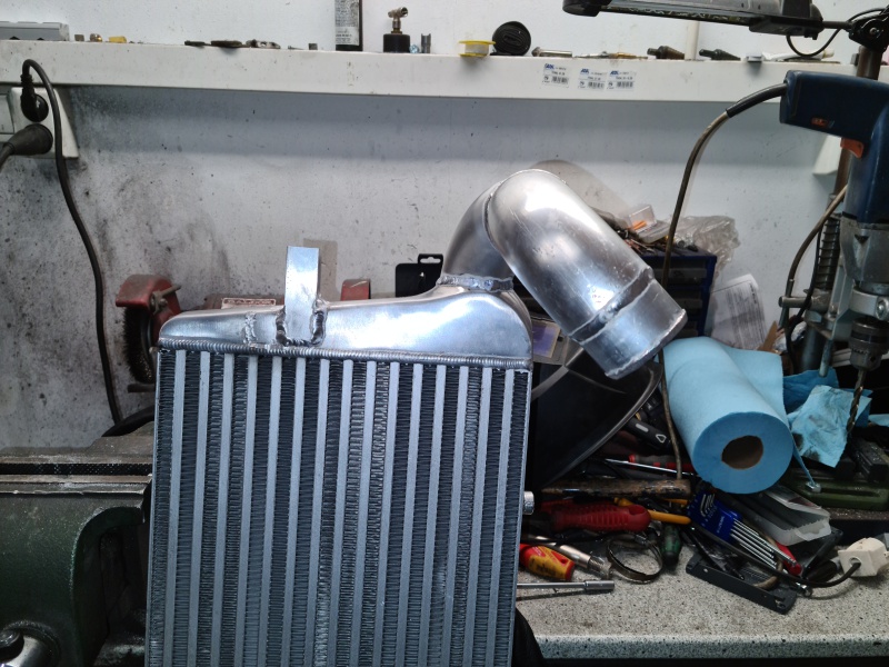

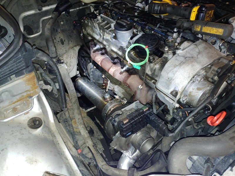

thanks for all the info. I would love to see more videos from your developments
maybe you can get a broken w163 transfer case (sure theres plenty out there hehe) , weld the gears so it acts like locked diff and just disconnect front driveshaftto have all power go only to the back
the om648 turbo rear must be incompatible with the clamp style downpipe of the ml how did you deal with that?
What size intercooler did you use?
sorry for many noob questions i know only the basics of diesel tuning

(06-19-2023, 03:35 PM)mitsosael75 thanks for all the info. I would love to see more videos from your developments
I already have a broken W163 transfer case, haven't disected what went wrong with it, but I don't want to weld the diff, this is a road car and it's super annoying to drive on asphalt with the front and rear axles locked together. I have gotten my hands on a transfer case from a Jeep Grand Cherokee SRT8 which has the rear wheels permanently coupled to the transmission output shaft and an electronically controlled multi disc clutch to connect the front diff. It's not a perfect solution but it is better suited to putting big power to the ground than the original transfer case, and I never use low range on this car anyway.
For the turbo, I welded a 3" V band flange to the turbine housing.
The intercooler I am using is https://www.frozenboost.com/front-mount-...p-201.html and it is a pretty nice fit, there's no way you could fit anything wider or thicker behind the original grille, possibly slightly taller. By welding to the ends I was able to bring the inlet and outlet to the factory locations.
