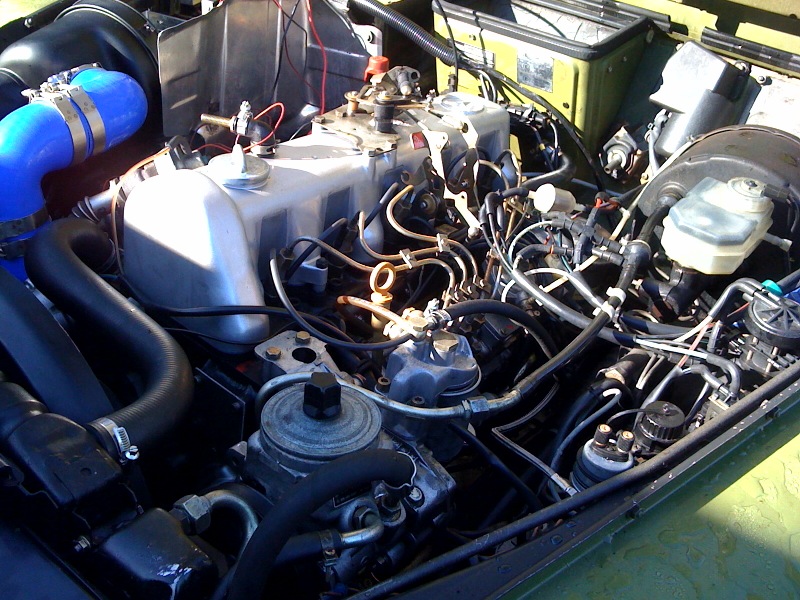

11-21-2009, 03:06 AM #5
(11-20-2009, 02:07 PM)CID Vicious Problem is, I have no idea what the legality is on converting a gas engine to diesel here in Kalifornia. I'm hoping that at minimum it's the same kind of regulation as it is to convert from gas to gas (same year engine or newer and all of the stock emissions equipment).
I'm almost done doing a gas to diesel conversion on a G-wagen. It's getting tougher to do every year. The first thing you want to do is contact the California ARB and ask to speak to a referee. They will step you through the requirements. the rules for gas to diesel are a little muddy still so you'll get different opinions from different referees.
A couple years ago, one of the refs I spoke to only needed to verify you had a diesel. Now he wants to see the whole drivetrain from the donor (engine, transmission, EGR) and it has to be same year or newer as the receiving car. Next year, I think you'll need exhaust and possibly gas tank too from the donor car.
Just have 15 loose wires under the dash to deal with.
'84 G-Wagen turbodiesel
'75 240D 4-Speed

11-21-2009, 03:26 AM #6
Very spiffy.
Just a note though, you're going to need a far larger diameter tube for the breather than that brass fitting.

11-21-2009, 08:59 AM #7
(11-21-2009, 03:26 AM)ForcedInduction Very spiffy.
X2
at least a 1/2" I.D.

11-21-2009, 10:44 AM #8
thanks. It's easy to keep clean when it doesn't run. Not expecting it to stay this way.
(11-21-2009, 03:26 AM)ForcedInduction Just a note though, you're going to need a far larger diameter tube for the breather than that brass fitting.
lol, that's a bolt in the pipe to keep dirt out.
I have an oil separator on order.

12-11-2009, 01:09 PM #28
getting back on topic - I just passed the diesel inspection. So it is certainly doable.
Truck is now smog exempt and officially a diesel!
But the Referee was almost hung up on the air cleaner (I used the G-wagen's instead of the sedan's). He was also on the fence about the gas tank. Luckily I had been on the phone with him earlier in the year and at that time he said I didn't need the donor tank. I was able to bring that up to him so he let it go.
Basically, anyone who is at all serious about diesel conversions in California should first get in touch with the Referee and see what he will expect. He may want more things then you think is worth doing. Also, his opinion will change with every new year so come January, anything you agreed on is no longer relevant (I had to rush things a little this month to be sure I had time to get it certified before the end of the year).
This post was last modified: 12-11-2009, 01:11 PM by Syncro_G.
