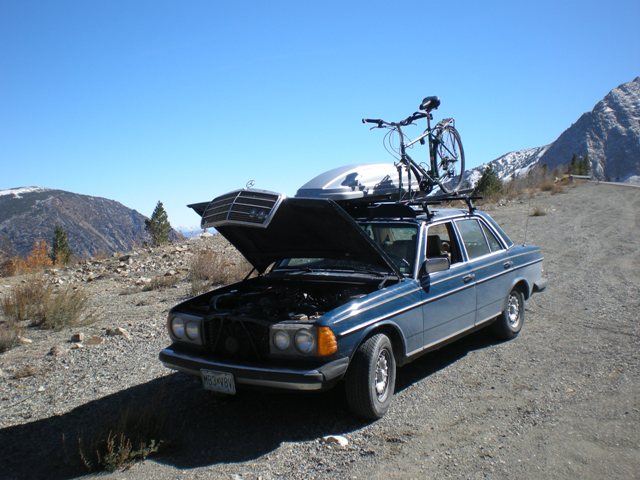

If miserly loves company, heres my worst ever air lock-
9943 ft almost at the summit of tioga pass at yosemite. ran out of fuel on the way up, and had to roll backwards down the mountain pass in the outside lane to this steep turnout where I managed to turn around somehow.
I blame the whole situation on a box of animal crackers I was eating.
