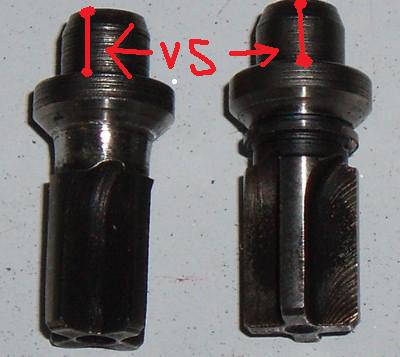

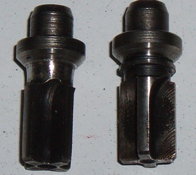

What have you guys noticed? More power/ smoke? Higher EGT's? What exactly does cutting the DV's entail?I have just completed my engine swap in my 81 300SD. It now houses a 1984 model year 617.952. The alda has never been touched (evidence of this being the metal band around plastic cap over adj nut). I want to remove it soon because it isn't near as peppy as my former benz engine (stock with ALDA devirginized 1981 617.951). I need to check my boost on this .952 and report back. Basically, I am looking for good performance while trying not to sacrifice too much mileage-I know people in Hell want icewater .
Ian White
11-30-2009, 01:03 AM #1
11-30-2009, 01:15 AM #2
The DV isn't a restriction to flow on the M and MW pump. Cutting the collar results in a very unstable idle, lots of smoke and extremely quick increasing EGTs. It had good power but the EGTs made the power unusable.
http://www.youtube.com/watch?v=HUUxhb4Rd9w
This post was last modified: 11-30-2009, 01:16 AM by ForcedInduction.

(11-30-2009, 01:15 AM)ForcedInduction The DV isn't a restriction to flow on the M and MW pump. Cutting the collar results in a very unstable idle, lots of smoke and extremely quick increasing EGTs. It had good power but the EGTs made the power unusable.
Cutting the collar? I thought to 'cut the dv's' one would remove them and have them Blanchard ground...
Ian White
11-30-2009, 01:18 AM #3
11-30-2009, 01:33 AM #4
No, just the collar profile.

(11-30-2009, 01:33 AM)ForcedInduction No, just the collar profile.
So it is just removing some material from the top of the dv to the collar? Or cutting the diameter of the collar? My picture will explain my question...
How are these DV's removed from the IP? Thread link / picture?
This post was last modified: 11-30-2009, 03:32 AM by Ian White.
Ian White
11-30-2009, 03:31 AM #5
11-30-2009, 03:39 AM #6
Yes, Just cutting the collar. The height difference is an optical illusion of the camera.

(11-30-2009, 03:39 AM)ForcedInduction Yes, Just cutting the collar. The height difference is an optical illusion of the camera.
I assume the are accessed underneath the inj lines on the IP and the 15 mm nuts? Please excuse my uninformedness
Ian White
11-30-2009, 03:41 AM #7
11-30-2009, 03:49 AM #8
Yes. Remove the lines, remove the 15mm nuts and they will be directly under. They will need a new copper crush washer as well.

11-30-2009, 12:58 PM #9
Okay, looks fairly striaghtforeward. Did you turn yours yourself or did you have someone do it? I am wondering how much to turn off the body...
Ian White
11-30-2009, 04:32 PM #10
Yes, I did them myself using a crude air drill/lathe and a dremel.
