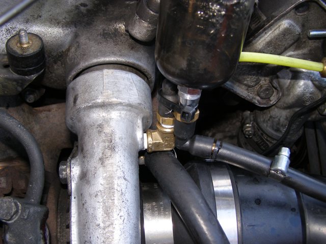

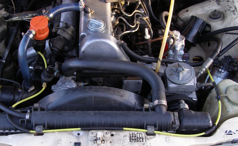

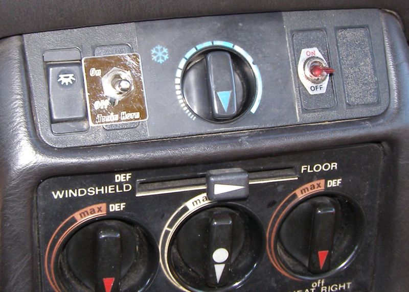

...and here it is.
Currently its set to come on at 8psi. I used my old BeCooling 300cc/min system in a somewhat different configuration than before.

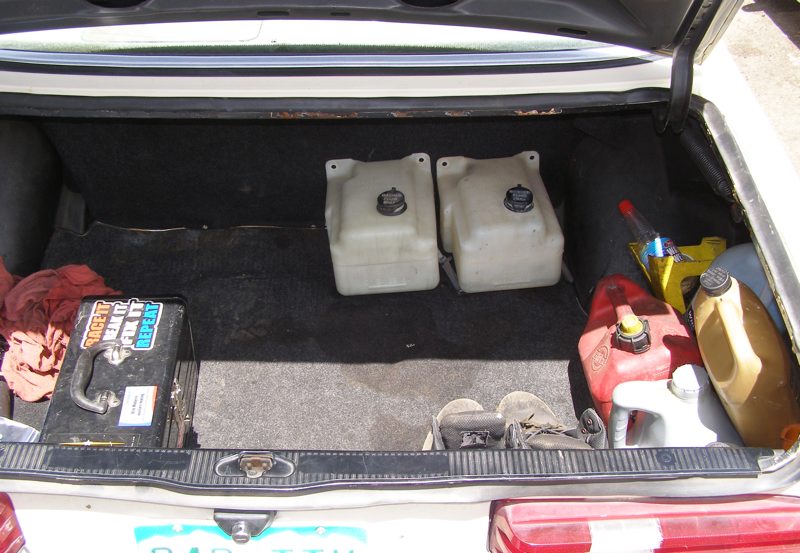

Today I got my water tank(s). They are coolant overflow tanks from mid-90's Chevy/GMC pickups, hold a hair over a gallon each and have a 3/8" nipple on the right bottom edge. I'll just use a Y fitting to connect their capacities.

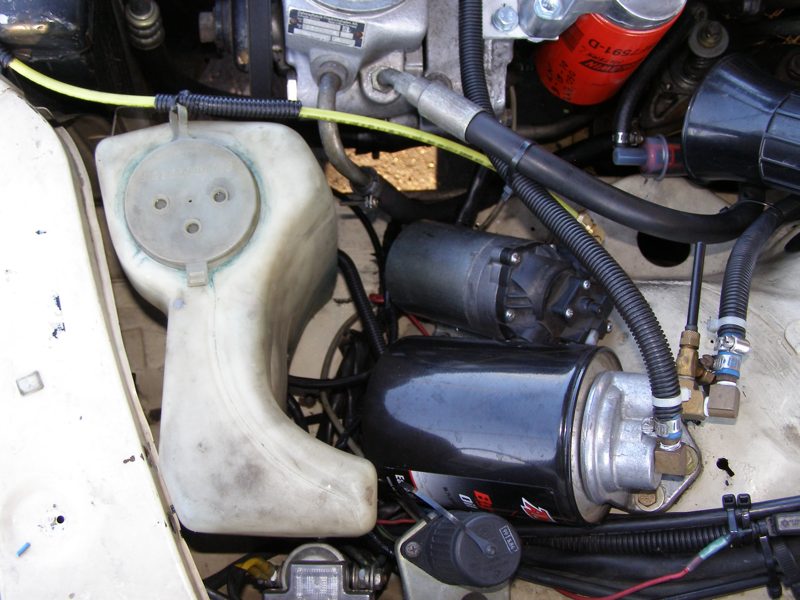

I've had a spare shurflow pump for quite some time. I'm not positive it works, but if its DOA I can swap for the one currently in my 240. It will be mounted in the spare tire well near the battery. An accumulator will be added sometime after the races, at this point I'm focusing on getting the system operational ASAP.
All thats left to get are the nozzles, pressure switches, solenoids and tubing.
