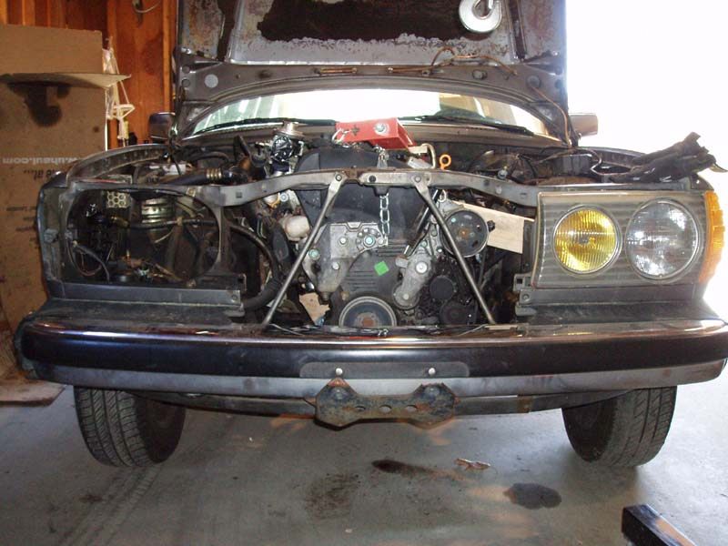

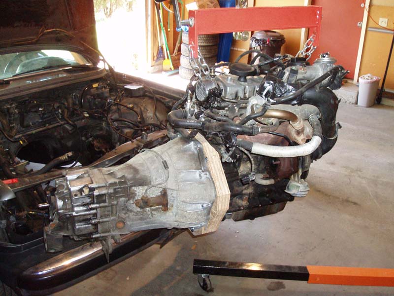

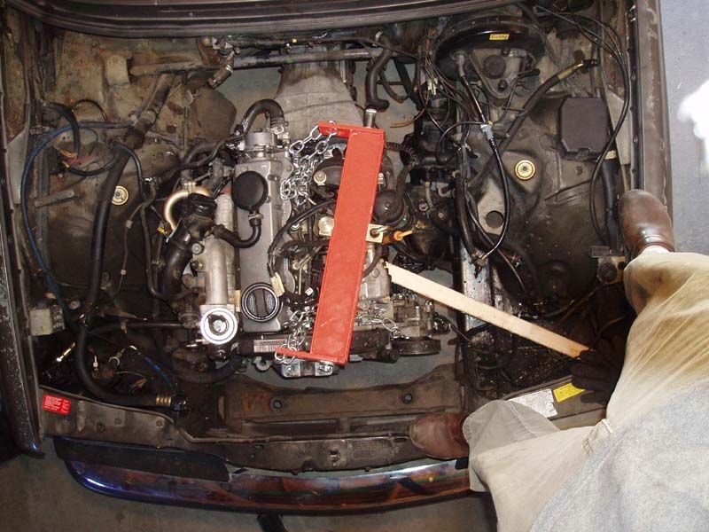

12-08-2009, 12:31 PM #4
(12-08-2009, 05:32 AM)CID Vicious Hmm...240D with a TDI?
Who knows how it turned out. The guy got to this point and never returned to the forums.

12-08-2009, 02:59 PM #5
How hard was it to get it to bolt to the factory four speed? Unfortunately the TDI motors themselves go for not too much less than a complete car unless you can find a deal on one.

12-08-2009, 03:25 PM #6
Looks like he was planning to make an adapter plate.

12-08-2009, 03:58 PM #7
Ooh, nice compact little oil pan...wonder if this could revitalize my 'ultimate handling 240D' concept. The TDI has to be way lighter than an OM61X, and if you could get the back of the engine close to the sway bar without contacting the hood or X member...
