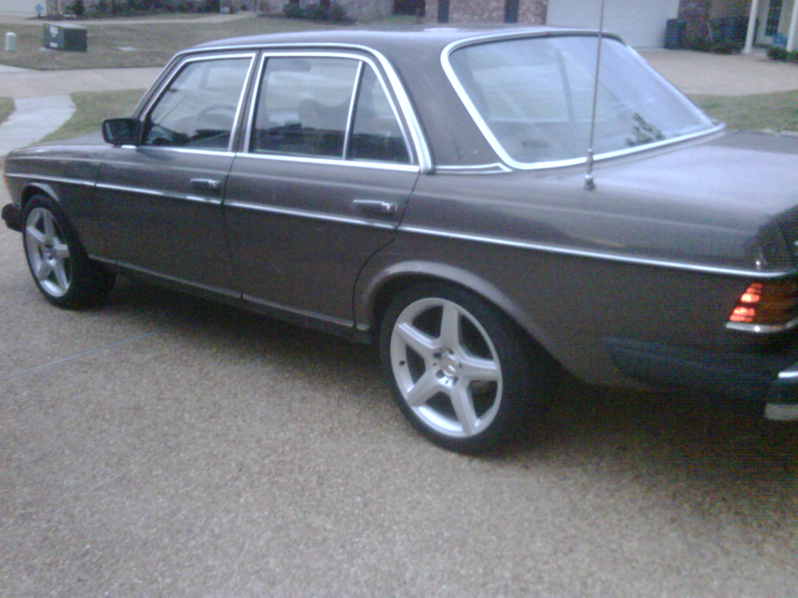

12-31-2009, 04:44 PM #12
Here's a pic of the 300D with the 240D springs minus one coil:
[Image: Photo101.jpg]
Personally, I dig that stance. I'd be awful tempted to be a total poser and just cruise that car like it sits, since a lot of muscle cars with their ass in the air are posers, too.
However, since it's my flip car (so far, maybe...) I'm going to swap out the backs for 240D springs and probably leave the coils where they're at. My 240D doesn't sit all that high in the back, though I do have some stuff in the trunk. A coil off wouldn't hurt, and I don't think I'll have to worry about it getting lower than the front.
The car can be brought to it's bumpstops if I stand on the bumper, but I'm 240lbs in winter gear. The ride should be real cush, and if you treat it like a lowered car you'll be just fine. If you're not corner carving and just want the low look with a cushy ride, this could be the ticket. I ended up dropping the battery for this car, ruining it, and haven't had the time to test drive it yet. I'll report on the ride, brake dive, etc when I can.
