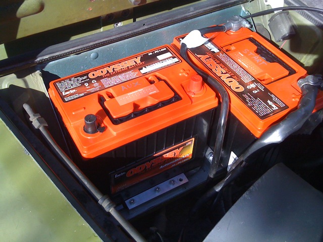

Here's my project for this month. I got an amazing deal on a couple of Odyssey batteries (almost 1/2 off). They are denser than the Optimas so I can pack them in better.
This is going to power a fridge, other auxiliary stuff and fuel heaters.
I'm still working on it so the isolator isn't installed and the second battery isn't hooked up yet.
I should add that glow plug heat time is way quicker with these - about a second or two now instead of 5 ish (with monark plugs and relay)
This post was last modified: 02-02-2010, 12:21 PM by Syncro_G.

02-02-2010, 12:20 PM #13
