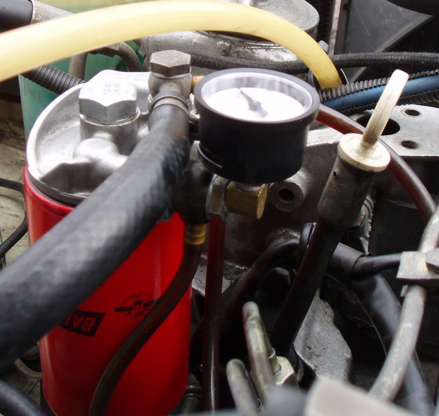

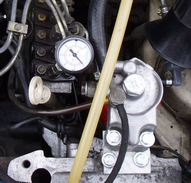

12-28-2009, 11:01 AM #7
(12-27-2009, 02:30 PM)willbhere4u where do you guy's add the pressure gauge in?
I added mine to the filter inlet side of the banjo bolt, right after the lift pump. The outlet of the base will have a pressure drop from the filter restriction.
Quote:what dose rotating the DV holder do?
Basically the same thing as removing the rack limiter or adjusting the full load screw. It changes the spill port location to were it closes later than normal.
Quote:my EGT's running 80-85 on the highway at red line full 10psi boost up a long hill will hit 1100deg after 1-2 minutes normally between 600-900 driving! Idle is about 400deg it will take a few min to drop down to 300 and 5-10 to get to 250deg minimum
Other than taking a long time to get hot, it sounds normal. Both of my cars take about 15 seconds to get around 1200*f.

I would first check your lift pump pressure. When that is good, then it is time to start turning screws.
